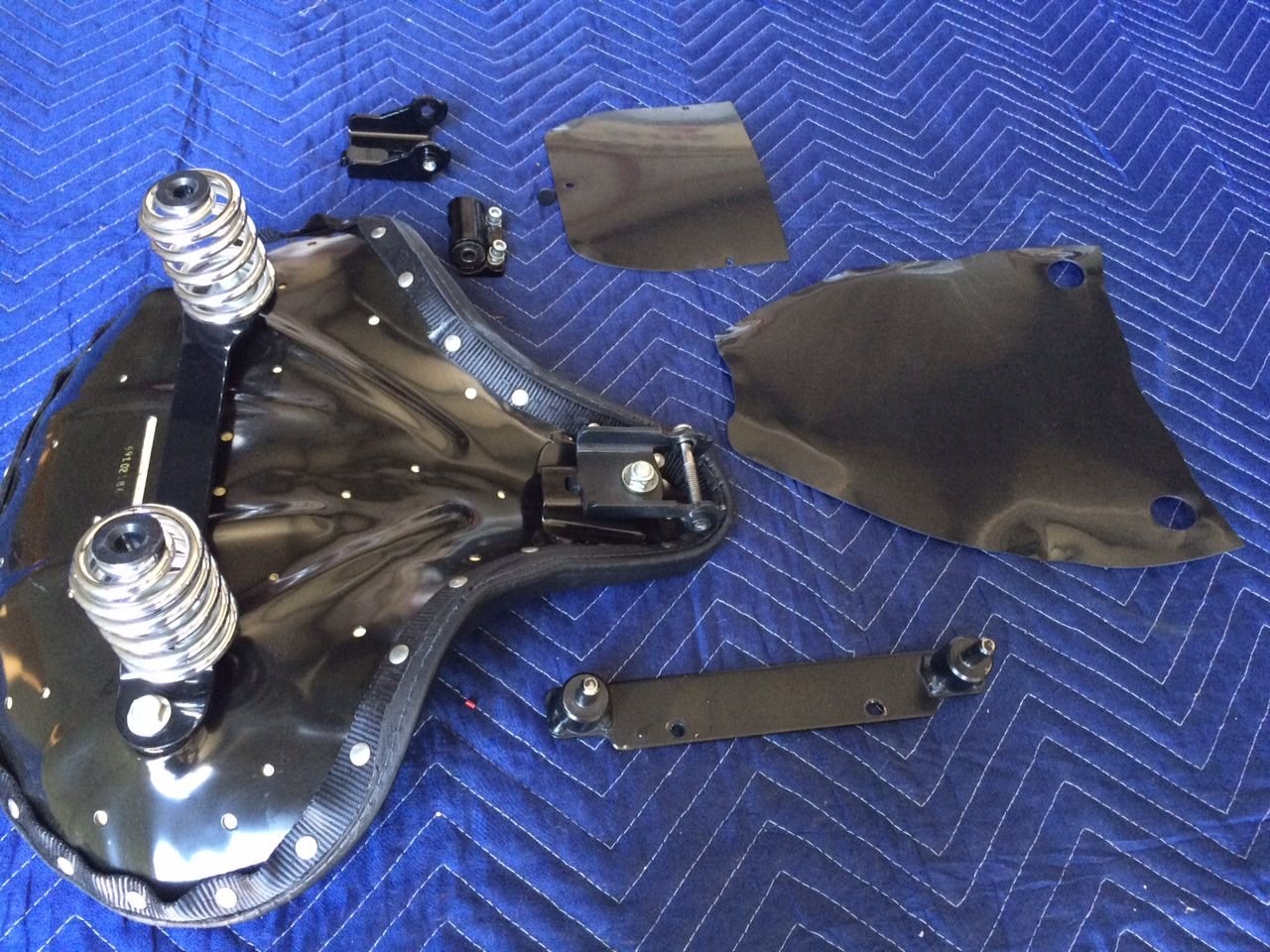

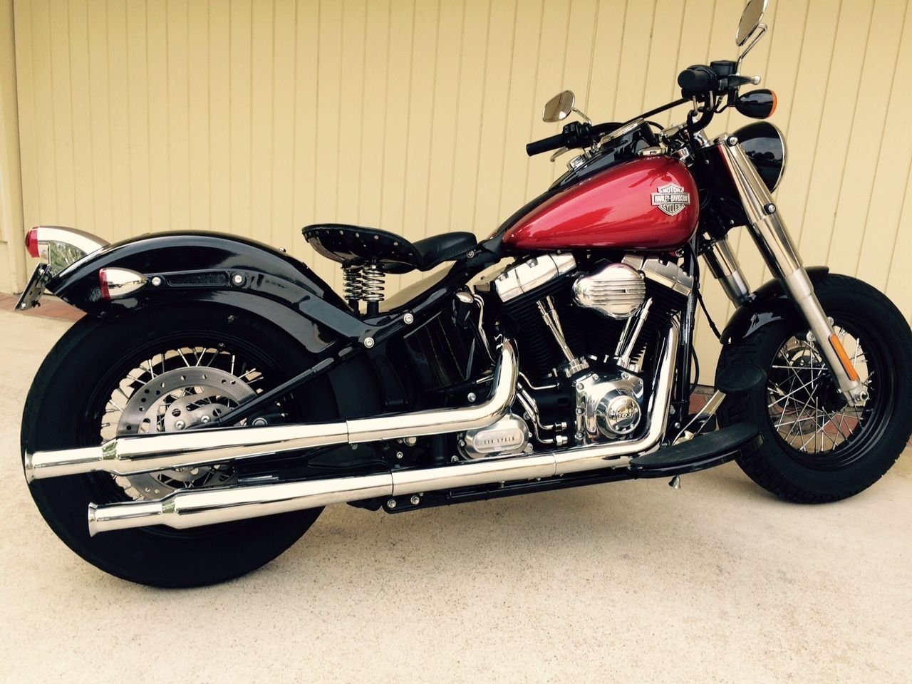

Mine was NOT exactly a bolt on operation, well in a way it is.
It is a cut down and welded XBones seat mount, BUT: All mount holes front and rear line up and bolt on the Slim frame. It's just that the XBones mount is too tall front and rear so needed to be chopped.
Then I got everything stowed below the frame rails, made my own cover for fender and battery, so no "bubble" or raised cover is necessary, for what I think is a pleasing look.
I have not seen anyone on this forum with the cover/ mount you linked. I have seen one from Shadetree, these covers are too tall for my taste.

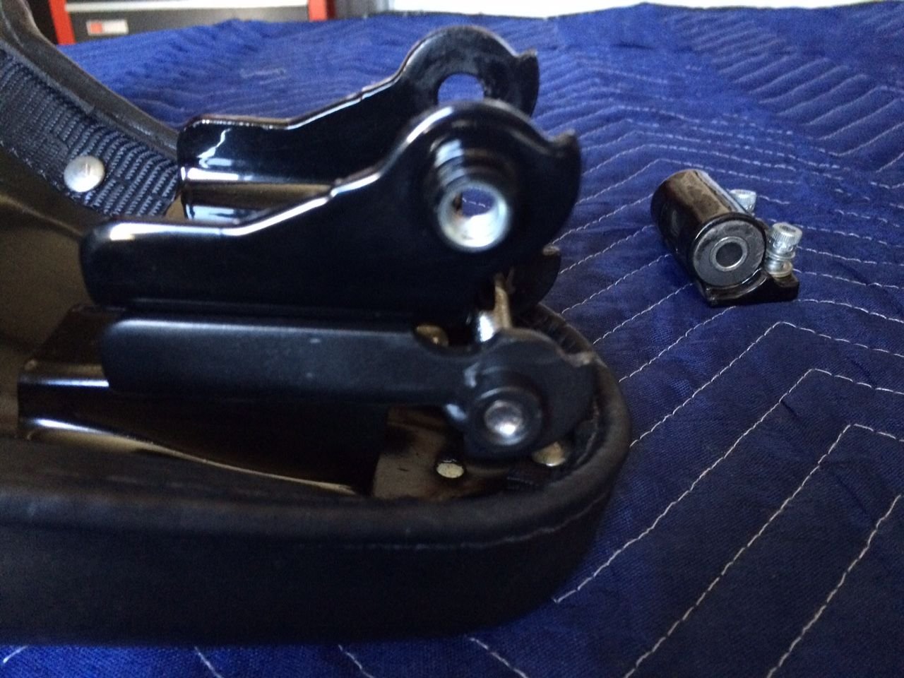

The Forward ECM or "battery cover" (its a 2 piece unit for the Slim, 1 piece for the 'Bones) Scissor spring holes (for that smaller curved Slim sprung seat) are closer together than the Coil spring holes for the XBones.
You will need to enlarge these battery cover holes at least 1/2 an inch or more. I did this, and was not happy with the look, not just because of the imperfect oblong holes, Its just that the raised covers don't look right to me.
The forward hinge will be a bit high, the aft spring Xbones mounts will be about 1" too high, I cut at least that much from the Bones coil spring steel spring base.
Yes, it will all bolt on if you enlarge the battery cover holes. I will take a photo of the battery cover I modded this afternoon so you can see what is needed.

Default Part of the Mod
Here are some photos of the seat mount and covers, as well as a stock front mount so you can see how much was chopped. I don't have a stock rear mount for comparison, about 1" removed:
Ill take a photo of the HD bubble cover later today.
