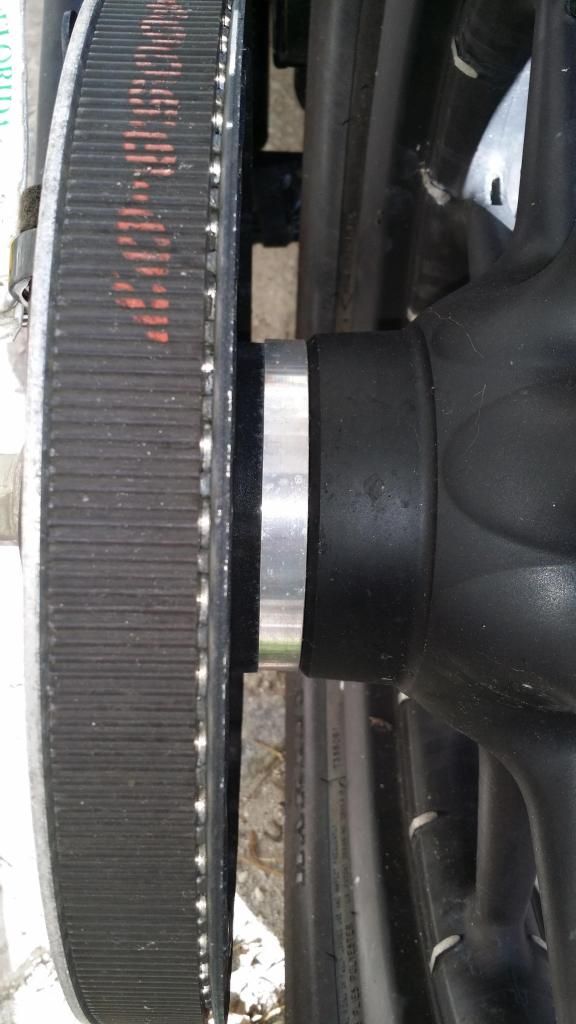

yeah!.. those wheels look amazing... to adapt it to a Slim you wheel need a 1/2 inch spacer (I did something similar with my Blackline that shares the same rear suspension as the Slim) here is a picture of the spacer (installed on the Pulley side)

So a sportster wheel other than the spacer issue will bolt up? The drive pulley and brake disk bolt on even though they're opposite a softtail? No problems or rigging getting the brake caliper and all that back in place? Thanks for the info. I REALLY like this wheel.

yes to all the questions.. direct bolt-on other than the spacer ( here is the link to the spacer ( 1/2 inch thick.. part number #3912:
http://vulcanworks.net/store/Harley-...y-Spacers.html
.. look at my Softail... it has Sportster Iron wheels..

For the rear wheel...remember to remove the tire and turn it around. Rotation direction is not the same.

I just ordered one to be able to mount the Fat Bob wheel in the back of my Slim S. 27.00 shipped.
