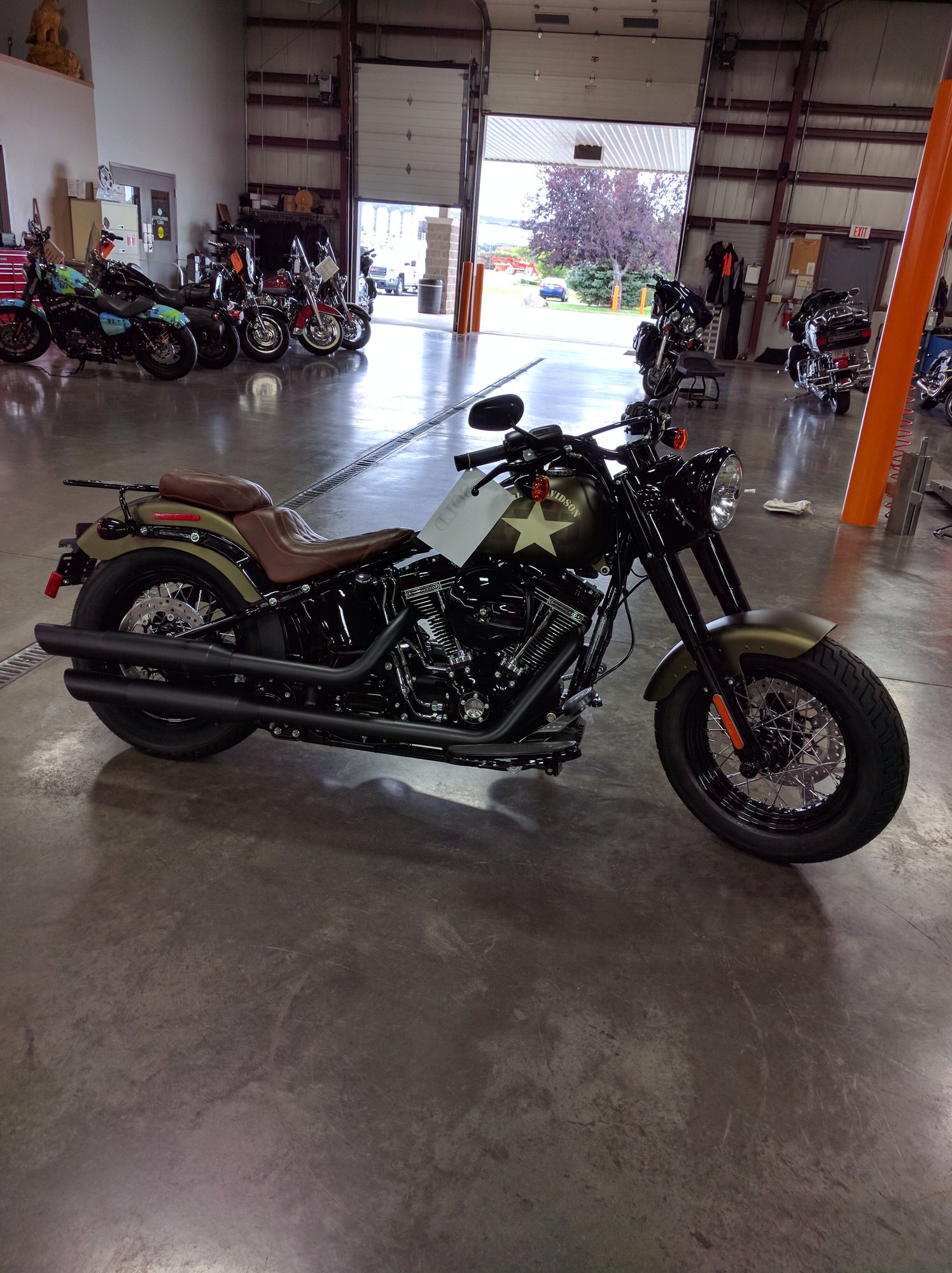

Pictures from pickup, as promised

I like the brown leather look!

Enjoy!
