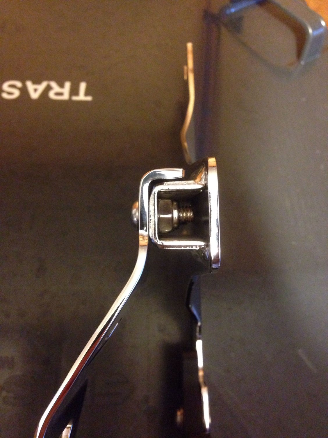

can the luggage rack be attached to the side plates with out the backrest hoop? just curious.

yes, the rack attaches to the inside of the squares that the sissy bar drops into. the bolts however thread into the sissy bar upright. what i want to know is can i just try and put some nuts on the inside and skip the sissy bar all together?

Sounds like you could, just have to find the right Nut for inside the tube, lower it with a magnet to hold it till you grab the thread. Right ? Seems Doable

Should probably try and get Square nuts cause you won't be able to get any kind of Wrench in there. This way if your lucky, the size of the square nut will lock up against the walls of the tube and you can tighten it up easily. Just make sure you use some Loctite.

good call but already picked up some regular locking nuts. will let you know how it goes. in the past i have just wedged a flat tip screwdriver for the nut not to turn in other applications.

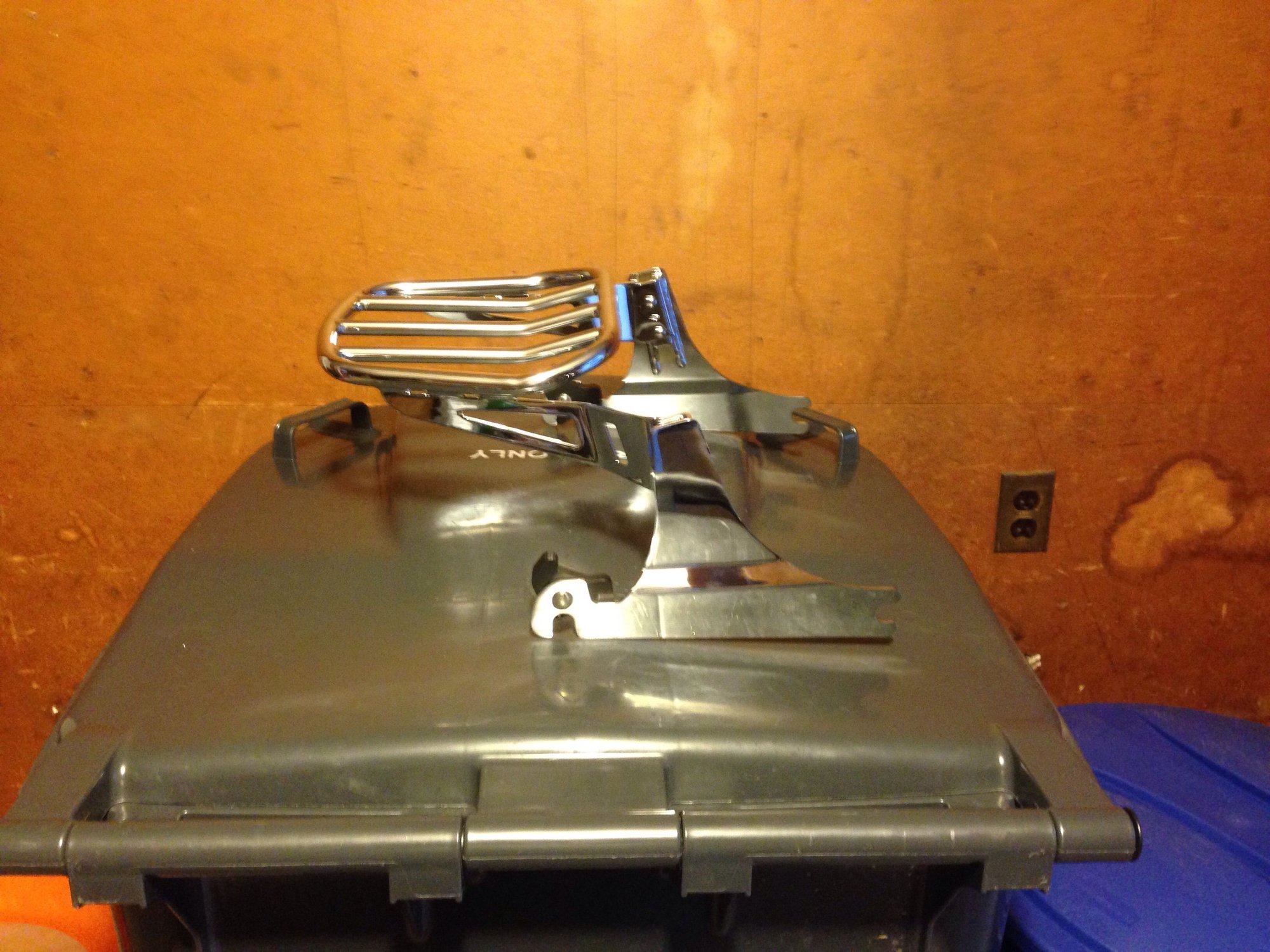

Got to get the docking hardware and figure out a bag for this setup.
