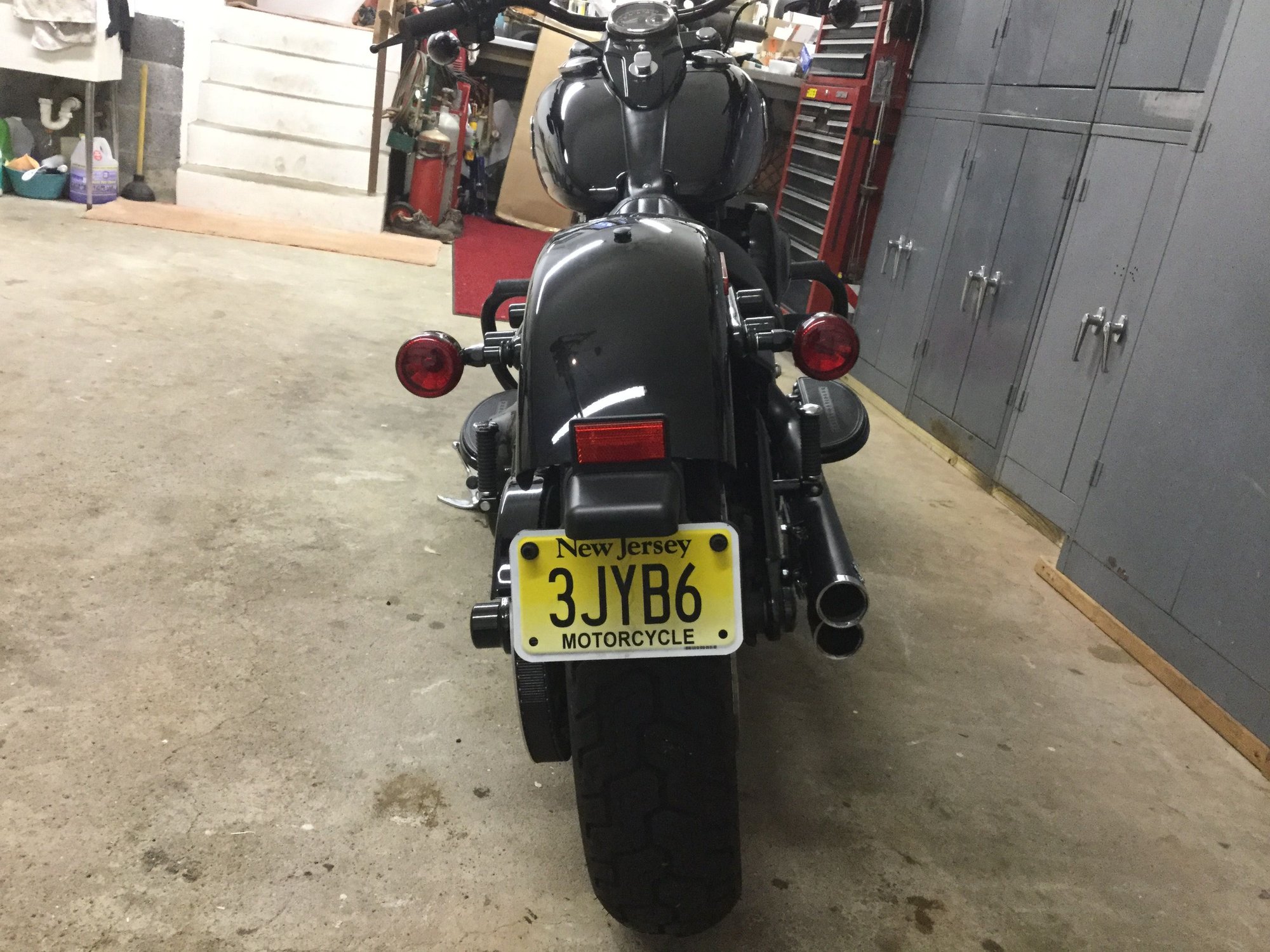

I bought the Slim in December from HD in Tenn. and had it shipped. Slim is a 2016 and it had 750 mi. On it. As you can see the signals and plate set up is not the same.. this is why I was confused with the photos and asking about the brackets..
I went to a local HD and saw a 2017 model and it had the same set up as yours.
So thank you for the reply.
Notice that the signal bracket is different
License plate is mounted on rear

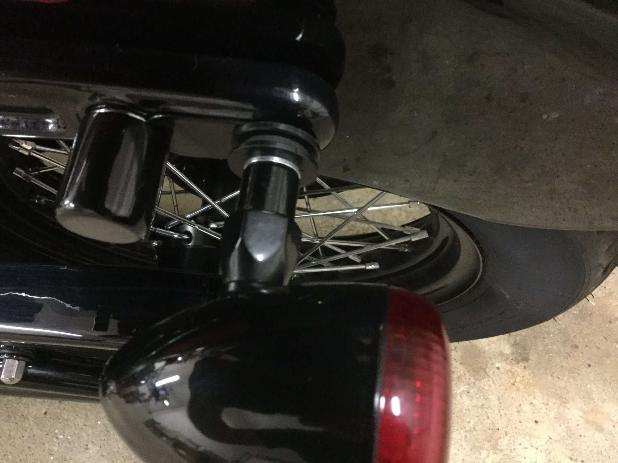

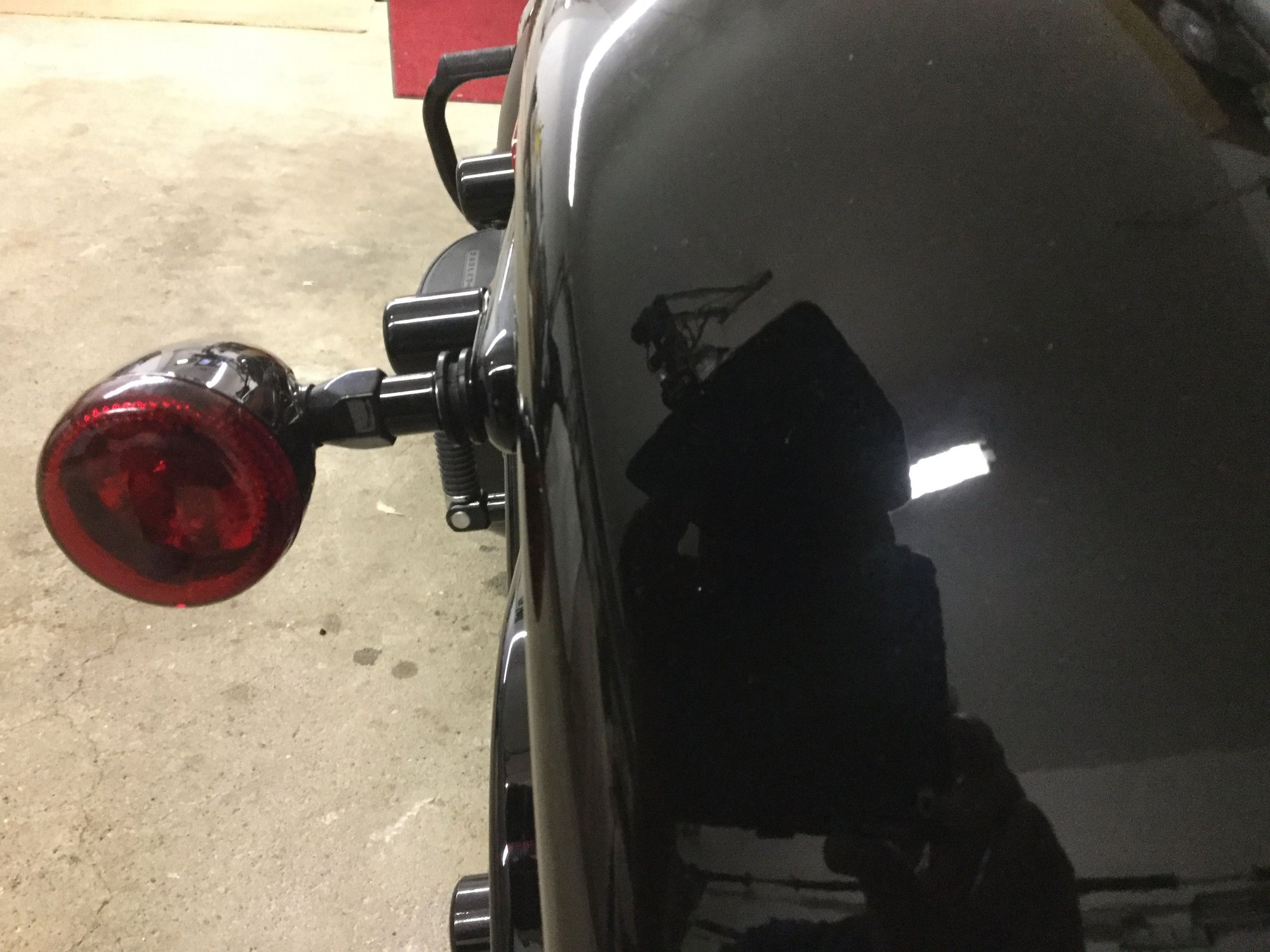

This is the turnsignal relocation kit....
You can now mount a QD rack/sissybar
without (a simple) modification to the
end attachment clasp.

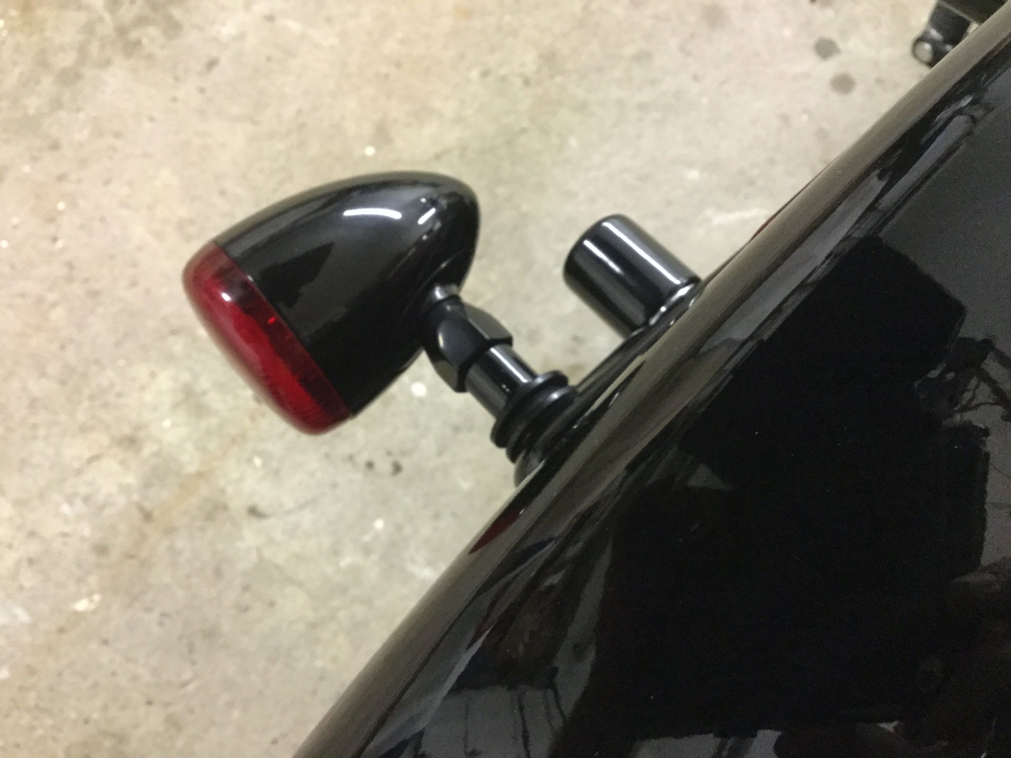

So for what its worth, after I added the turnsignal relocation
kit to my FLS, I located the license plate with an axle mount
bracket since my personal preference is not the factory fender
mount solution...
Here's an old-ish picture
good luck,
T.

Now I get it, I remember someone mentioning this on the thread but it never occurred to me that this is the setup that I have. I bought it with a passenger seat and sissy bar. I thought that this was the stock Slim. So I Removed the seat and sissy bar, and I do not like the plates mounted on the rear. It covers too much of the tire. I liked the idea of being able to mount the seat and sissy bar in five minutes to take the lady out for a ride. But I also like the bike with a solo seat for most of the rides... I have to find another way to get that plate off the rear, don't like the one that mounts to the axel. WKNDS you cleared all the confusion about this mess... Thanks

Might go to post #318 in this thread, all you have to do is modify the
end-clasp of your QD rack/sissybar and you would not have to relocate
the turnsignals. If you received the stock stalks when you bought the
bike, you could reverse the relocation, thus putting the original sidemount
and signals back in place.

Thanks, this is a cheap axle mount from Ebay. Think it was listed
for a Fatboy. It is configurable with a bolt on bracket for a brake
light if you wish, which I did not use. It can be mounted on either
side of the bike.
