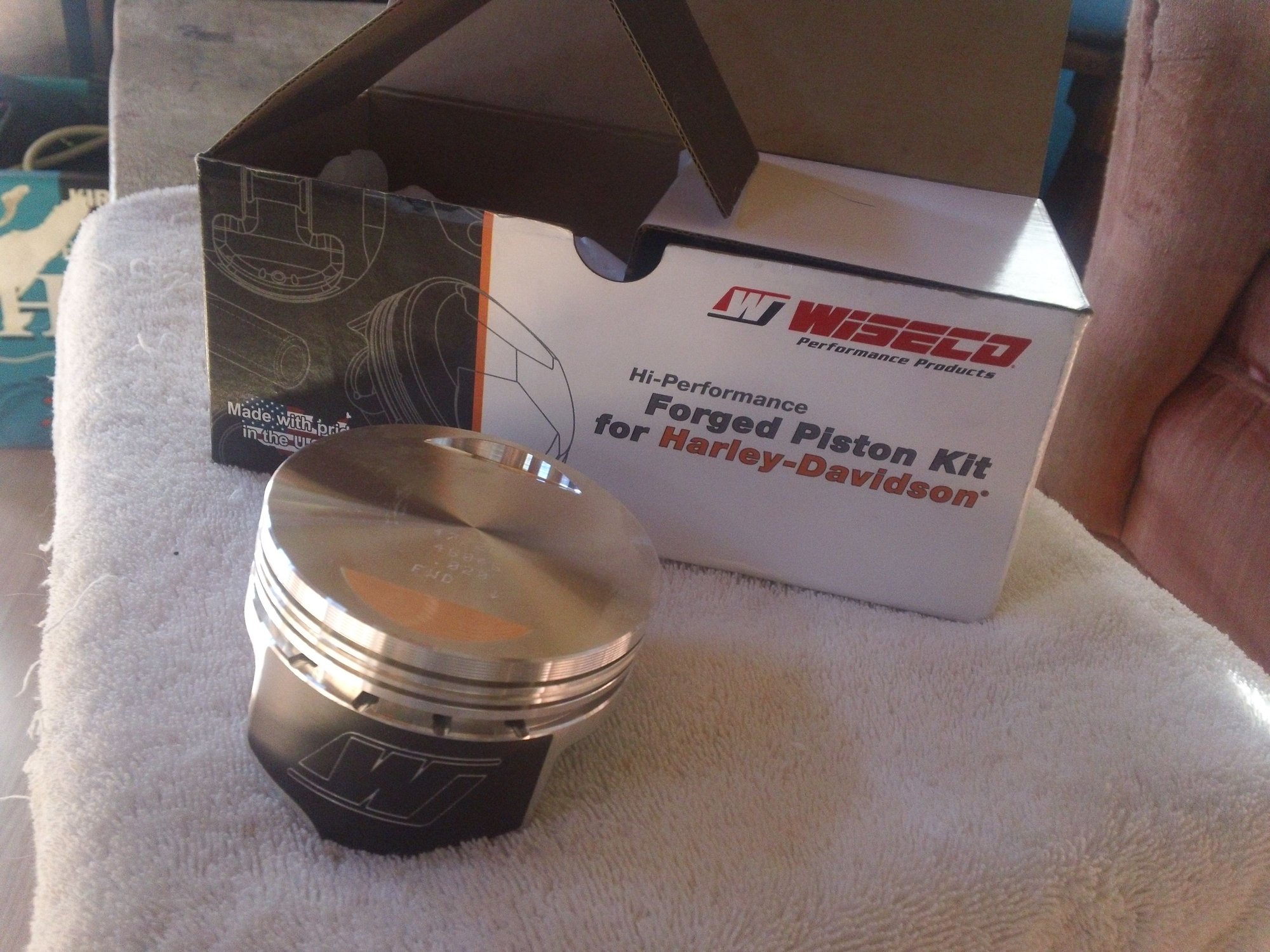

Old Dec 13, 2015 | 07:26 PM
Papa Jack's Avatar
Papa Jack
Joined: Oct 2014
Posts: 48
From: Bertram, Texas
Finally going back together with new pistons,.020 and I installed new wrist pin bushings. Will finish up tomorrow. Been way to long.
