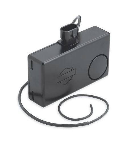

I just bought a new Road King and had to add the smart siren 2 and that does not look like my antenna wire..
I believe you are talking about this one: Smart Siren II Security System-68328-06A

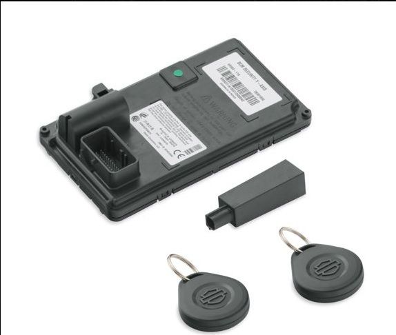

The Slim S is supposed to have this one (I think...not sure):

The arrow points to the TSSM, the antenna is a taped down wire probably below the module. The alarm system is connected to the BSM. Check to make sure it did not wiggle loose (under the shroud behind the rear tire). If there was an issue like being unplugged, I believe you would not be able to start the bike. Like stated above, it is more likely to be in transport mode.
