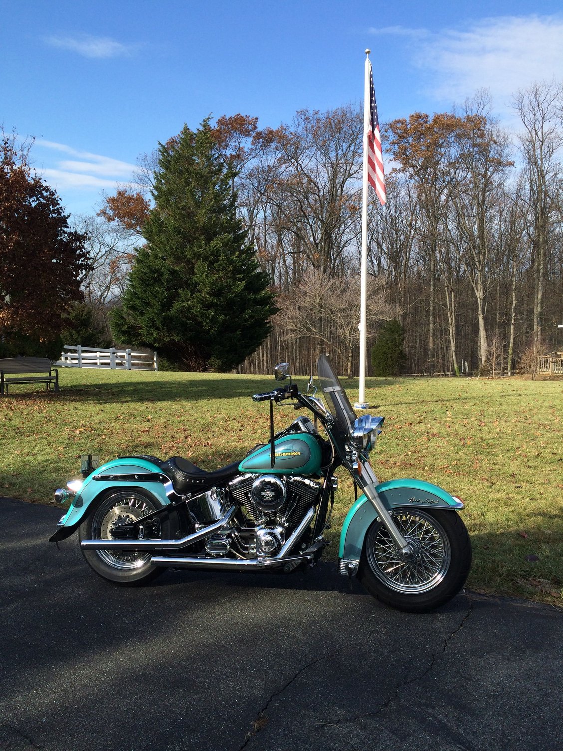

I took mine off, no problem

Mine is gone as well. Easy to put bags back on as well.
