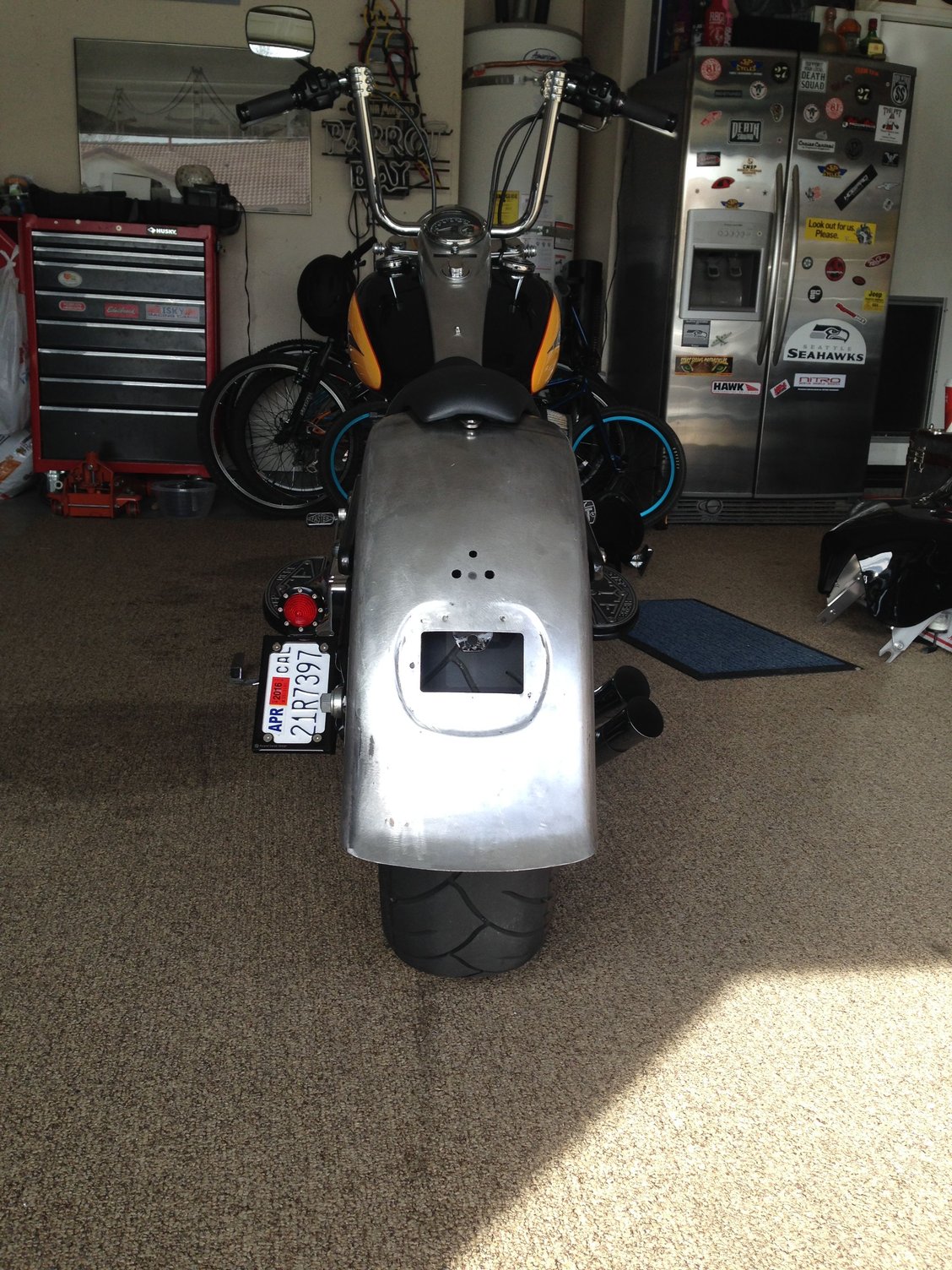

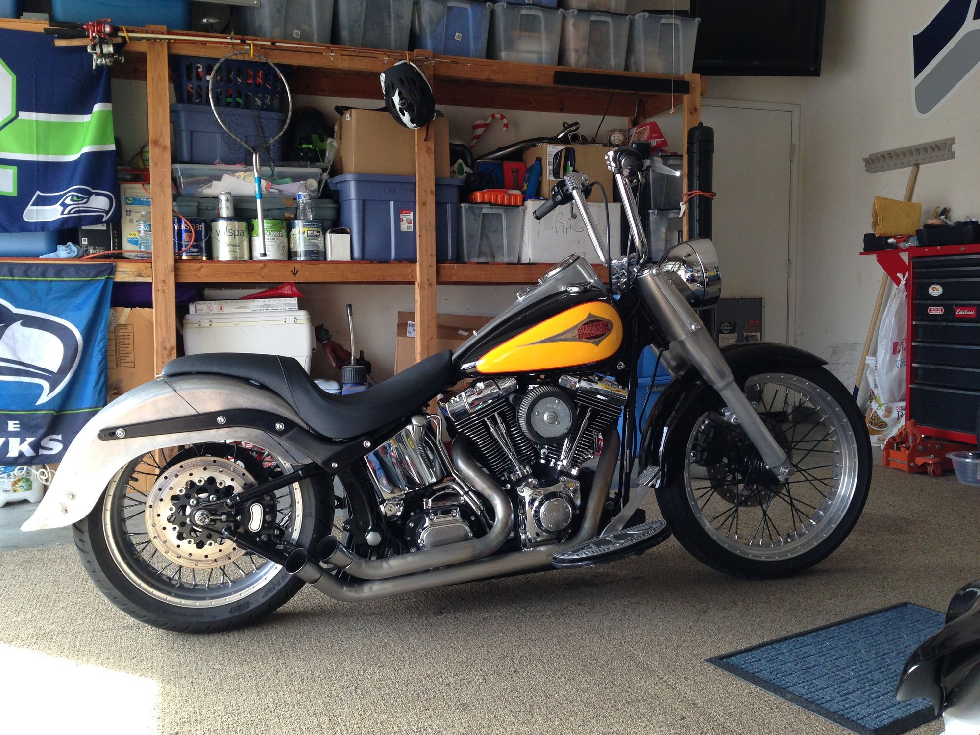

Well after taking John's advice I installed all the fender struts (inner & outer) off the bike and put it on...is it tight? Yes. Will it work? No question. Everything lines up and bolts on. Any future tinkering with the fender will require it being taken off and reinstalled by bolting everything together off the bike. Any way the 08 and newer struts will work...3rd time was a charm. Thanks for the idea!!!! Saved me some 💵
Seat is not bolted down so if it looks out of whack i just had the seat laying on the fender as I needed to take it for paint.

Glad to see things work! How far did the struts need to be pulled in to line up? Did it bend the fender at all? I am pumped and now will be ordering the 2008 and newer inner and outer frame struts! Your pictures make it look like a factory fit.

The crazy thing is at the mounting point to the frame they actually had to be bent out a tad..it is a snug fit for sure. Crap I'm excited to seeing I had all those parts adding up quickly!! LOL
