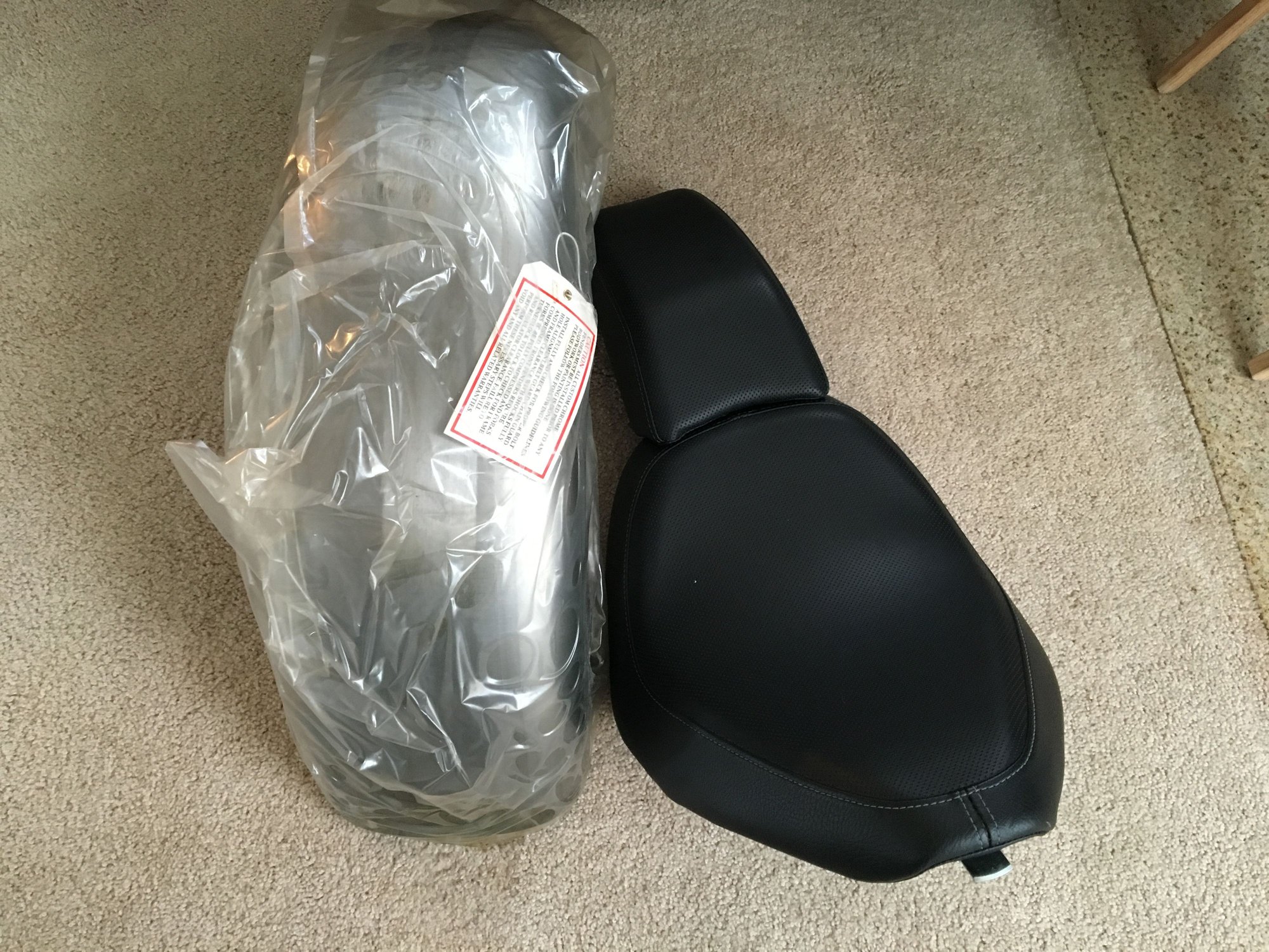

Does any one know if I put 2010 Fat Boy struts and fender on my 2002 Fat Boy what seat I should use? I don’t if 2010-2017 seats will fit or if I should go older.

I have a 2000 FXSTS and want to install the stock (07) 200mm rear wheel and fender I just bought. Do you know if there is anything different between my 2000 FX springer and your 2005 FLS?
