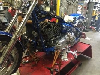

Hey guy I did this mod to my stage 1 96.and it worked great, gears are shorter and more up and go, now I'm doing a complete Hillside 107' build throttle body, stage 2 heads, woods cams, etc....my thing is, should I throw my 32 gear back in, as I want to be able to use this power? I don't wanna rev gears instantly, I almost can start in 2nd gear now with lil lugging of motor!!!!, Thoughts???? a gear will only go as fast as it ratio, if you put 400hp behind it you'll just rev it faster, you won't go faster? is my thinking correct?? or with build will I have more legs???? I think I need gear for that??? thanks guys....even if I just pop 32 in, leave the sprocket for now? THOUGHT APPRECIATED...time is of a essence
as of today, this is progress from my mechanic....we plan to send it all out on Monday, he's going into primary to do a heavy spring a Kevlar clutch w/extra spring....
