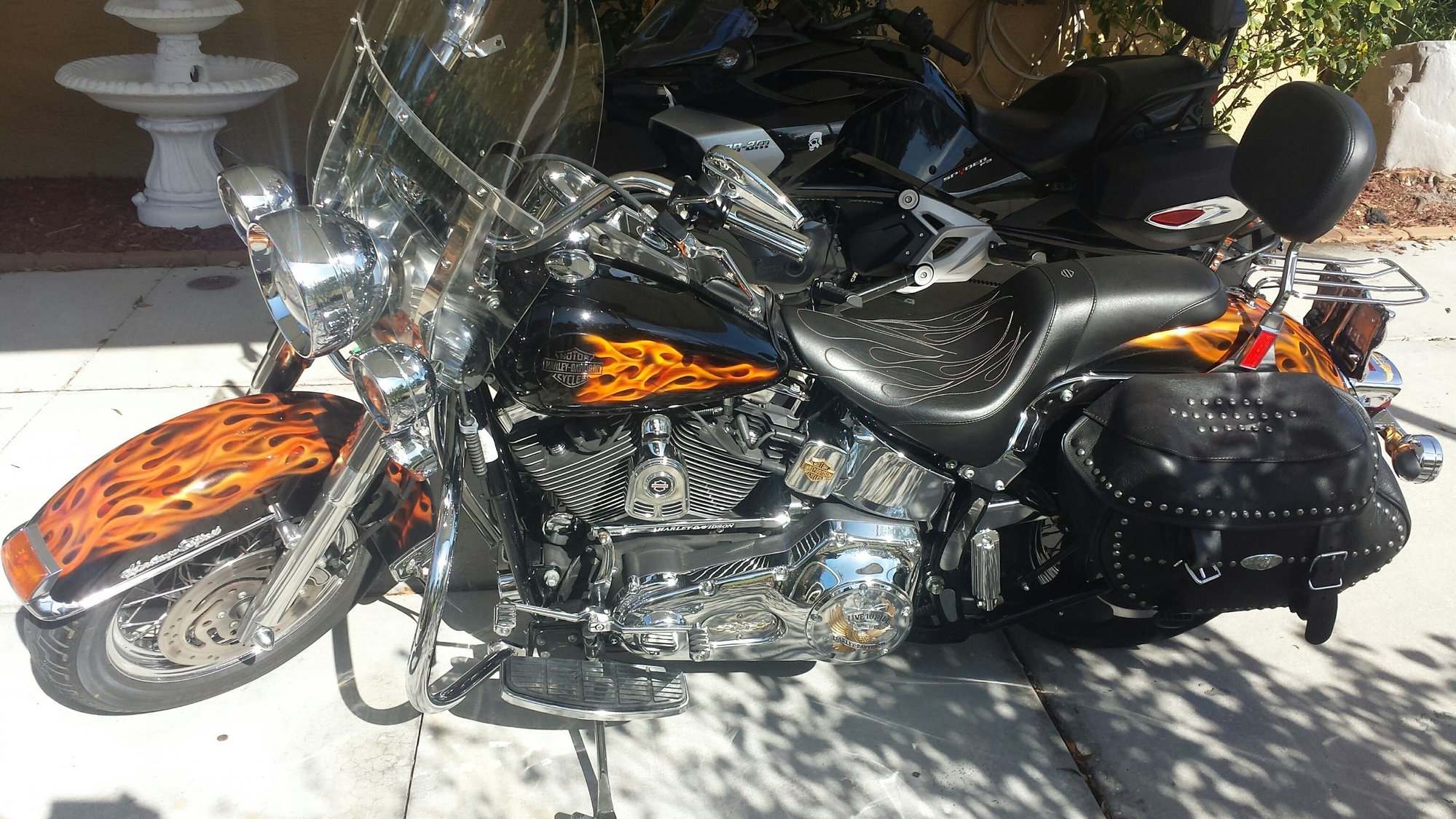

Hey guys.. Thank you for all your input... Really appreciated. Will get new tires. Tires are the originals with 11,000, but age may be a big factor? Could not resist buying this bike!

I'm kidding. You're probably not gonna like what I'm going to tell you but if your motorcycle tries to switch ends when you apply the brakes it's probably you. The motorcycle you have posted isn't an uncommon model. There are many of them on the road today that don't "fishtail" when stopping. My guess is you're a little heavy with your right foot.
Try these two things:
One, apply the front brake first ever so slightly before the rear.
Two, position your foot on the rear brake pedal so that only the edge of your foot is applying the rear brake. IE take away some leverage until you learn to feel what this particular bike is doing.

Rear tire at 11,000 miles is done anyway as well as it being 11 years old. Hope new tires cure the problem. Let us know.

One more thing to add, may or may not be helpful. When I first got my Breakout I had the same issue. If I had to stop somewhat quickly using the front brake, bike would get religion with the back tire skipping or sliding under any sudden braking maneuver - even as low as 35mph. and with barely putting any force on the rear brake. scary ****. and this is a new bike.
I'm an ex track rider both on and off road, and been riding since I was 15, first street vehicle was a bike. I've had 20+ bikes since then all types. Correct braking technique is first nature for me like taking a breath. I'm not sayin' this to brag or anything just stating my riding experience for sake of offering advice.
So I had to conclude something is up with the bike, and this is all stuff that can be experienced with a track bike not set up properly (although under much more extreme circumstances). I have never experienced this with a new stock motorcycle and tame normal street riding.
The short of it is, the front fork suspension was too weak and the bike would immediately dive down on braking, transferring majority of the bike weight forward and off the rear wheel. the rear suspension has poor rebound control and lets the bike weight transfer up and forward. the stock Dunlop tires have very poor grip hot or cold. these three things all contributed to the squirrely situation.
I installed a set of Race Tech single rate springs and drop in set of Ricor dampers. Switched tires to Pirelli Night Dragon (Metzler and others are good too). installed a set of progressive rear shocks (not real good but better than stock).
That completely eliminated the problem. Gone for good. I can grab a hand and foot full of brakes at 60 and bike settles right in and stops on a dime.
point is - it's not always the rider. bike suspension and tires play a huge factor in maintaining tire / road surface adhesion especially in heavier braking situations.
New tires would be a good start- tires get hard and dry out with age. check suspension especially front that it is not too washy / diving on you.

Dunlops over 10 years old... I suspect your problem will go away with new tires. I'd highly recommend not getting the tread design Dunlops that are on your bike now; everything else, including newer design Dunlops, will have better traction and handling. Please don't let whoever changes your tires re-use the tubes (I see the front at least has spokes), they age also and 10 years is too long. Heavy duty Harley tubes with metal stems are reasonably priced, think I paid about $15 a couple years ago.
