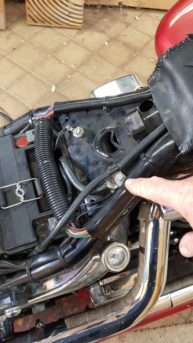

Joined: Jan 2013
Posts: 2,721
Likes: 103
From: St. Louis, MO
Popping this up as I had to find it and refer to it again.
Old Apr 27, 2020 | 09:58 PM
  #79
ratglide's Avatar
ratglide
Joined: Jun 2011
Posts: 17
From: Perth Australia
Default Solved my ignition problem
A big thanks to all forum members.
I've struggled with an electrical gremlin for months.
It can be in the first 5mins or days.
Bike just turns off and both indicator lights on the console light up as if you were activating emergency lights when pressing both turn signal buttons.
Sometimes it will click back on before I grind to a halt.
Most times it would restart after a minute or so.
I pulled the ignition switch and cleaned that, still had the problem.
Then I checked the engine to chassis earth strap... all good.
Checked the battery leads to the battery... all good.
Then I thought I'd check the earth from the battery to the frame.... BINGO... that was the problem... yah!!!
It was only about half a turn loose with the main earth from the battery and 3 other cables earthing under that.
I thought I'd mention this because when I checked the earth lead on the battery, I didn't think to check the connection to the frame.
I've come to the conclusion that I'm just a dumb biker and thought I'd mention this fix just in case other people overlook the other end of the earth lead like me.... or am I just SPECIAL
Hope this helps....
