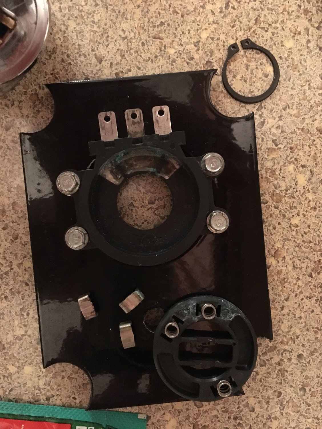

My ignition switch is relocated and it is exposed to the elements. At the start of every season I clean it and re-apply dielectric grease. My switch is always green when I open it up cause all the moisture that gets to it

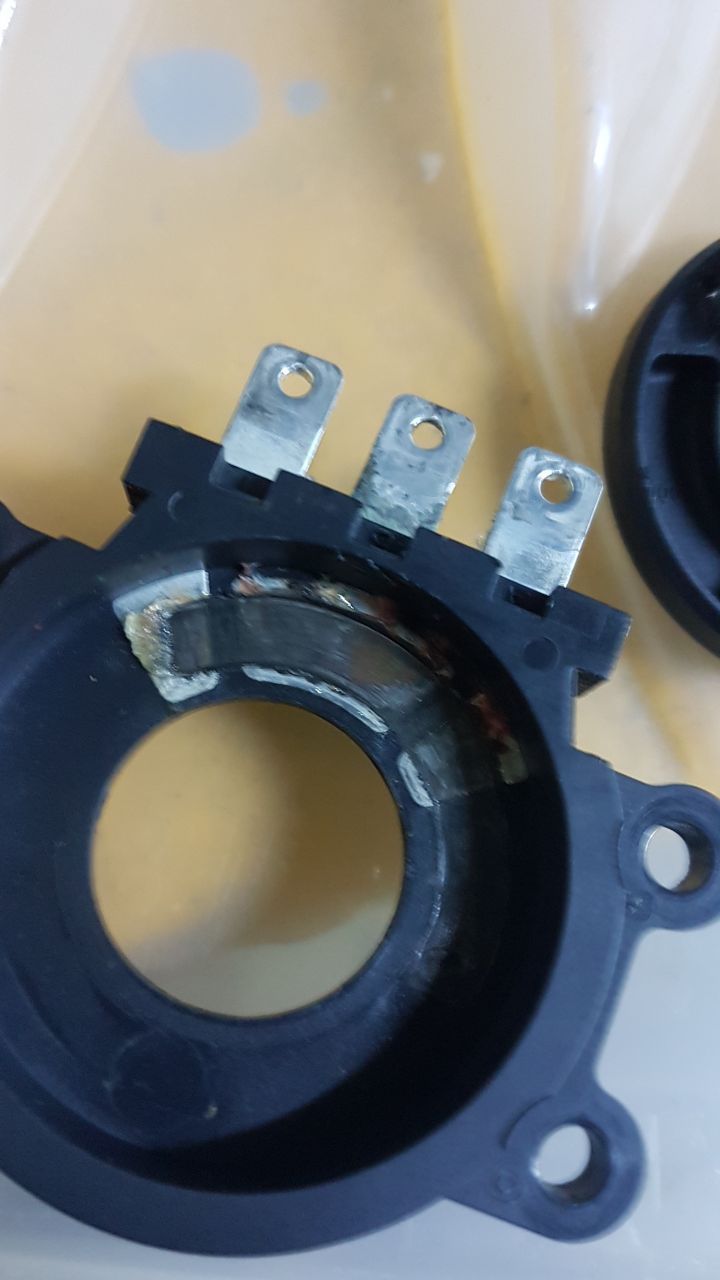

Thanks Joe ! The issue happened many times and each time I turned the **** off then on and the bike just restarted ... This weekend I was in middle of no where and after a short brake the bike wouldn't start, no power what so ever. After 30 min and after many tries, the bike turned on ! Went back home and found your detailed post... here is a picture of my switch
very dirty ...
after cleaning and dielectric grease
