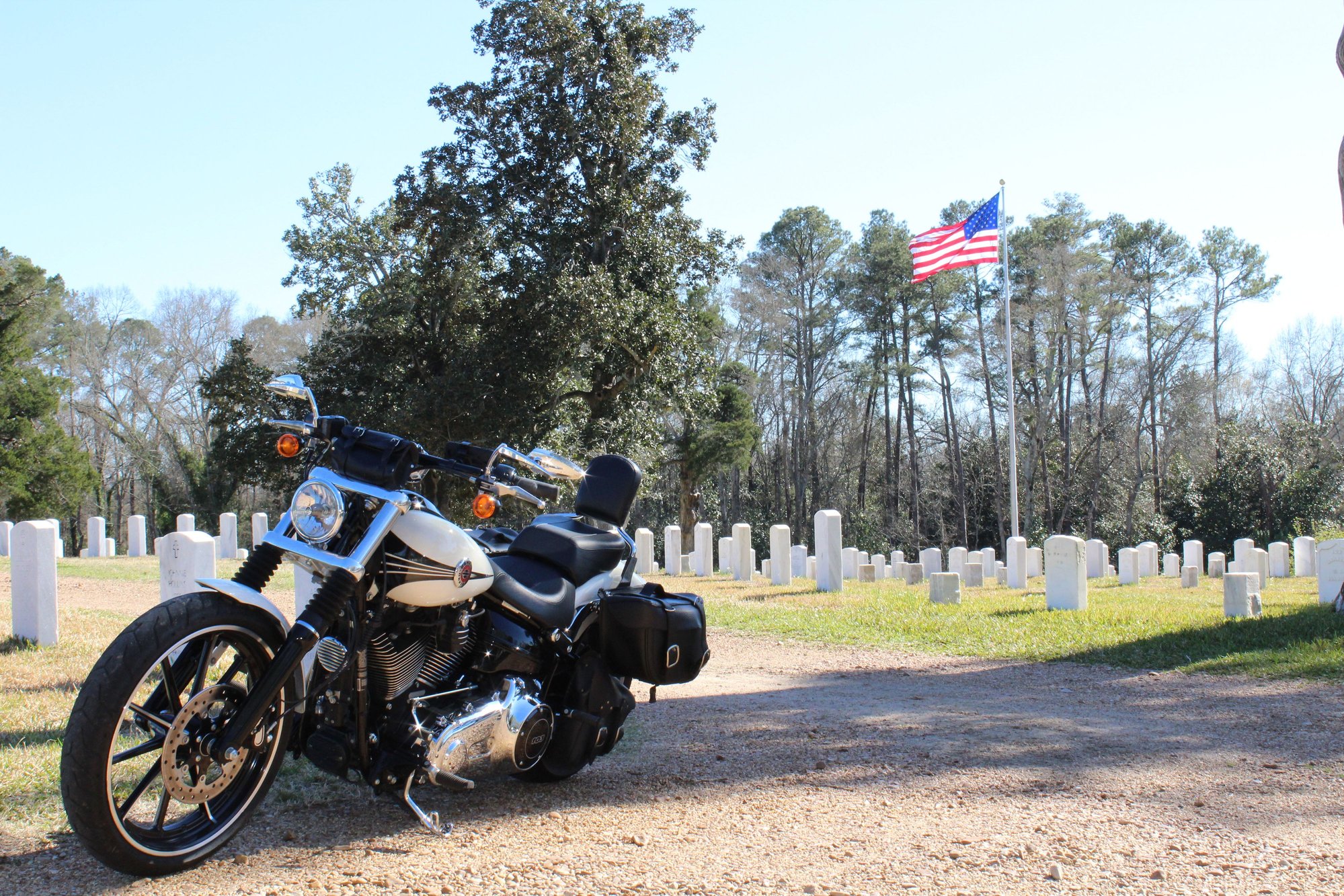

If you do the Thunderbike fender, then you are pretty much screwed. Unless you add another wire harness to the new fender. Then, you can swap to the factory fender when you need to put saddle bags.
I used EZ-Brackets on a set of throw-over saddle bags. The brackets come with the QD hardware and they will mount to any hard-back saddle bag. I just took the yoke off of the throwovers. Looks great and good for the long trips!

They have 2 options. One if you already have the QD backrest hardware and one if you don't have the QD harware.
Without backrest BRKT-R1
With Backrest BRKT-R1BR
Go to greatbikegear website. They have it listed as Easy Brackets for Harley Davidson FXSB Breakout 2013 and later.
