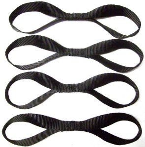

You should have some tie down anchors on the trailer, if not buy some eye bolts and large washers which you can mount in the bottom of the trailer by simply drilling holes in the floor in each corner. I would also suggest some soft tie down loops for the bike so you don't scratch or rub anything on the bike with a ratchet strap. Also install a front wheel chock
All is easy to install and once you are loaded check the bike after about 10 miles form the initial trailering then about every couple of hours since you cant see it in the trailer.
