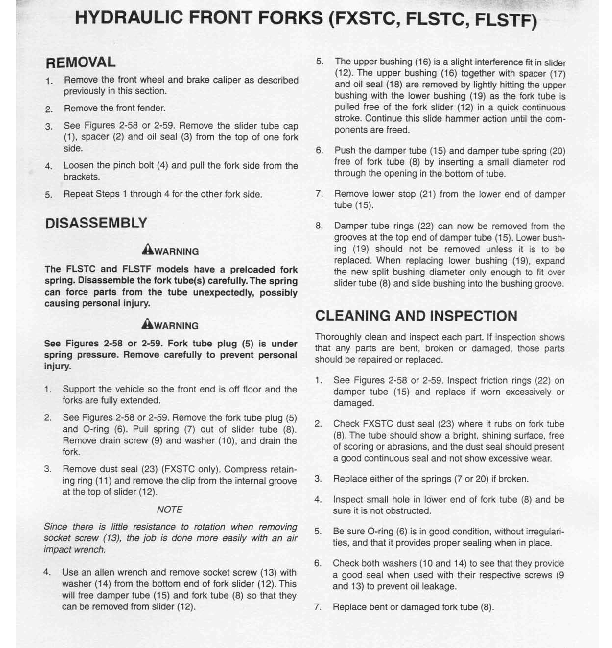

I actually went to The Harley dealership and ordered the service manual $80! That was last Monday. They told me a few days to arrive. I called back Friday and was told 3-4 weeks. So in Saturday I bought a pdf version for $7 and was working off that but it's several models combined from 1988-1999 so maybe I looked under wrong section.

See it says to looses. Up the pinch bolt but it does not say to remove the headlight and the chrom bracket behind the headlight. This is why I did not think of that bolt... Unless some one knows how to access it without taking out the other parts

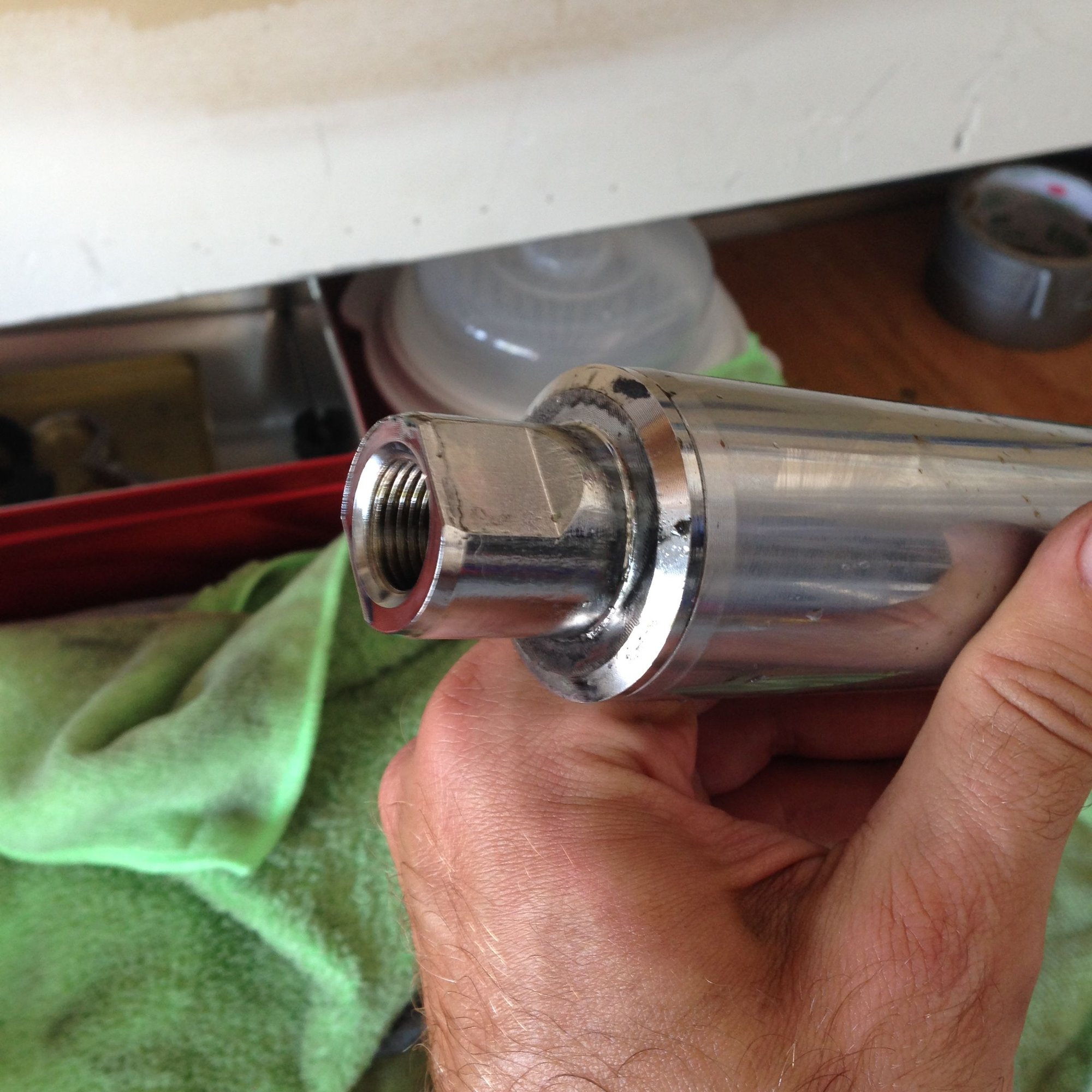

Ok I have this on the top of my tubes,, I need to take it off to access the spring. But this is not in the manual. Is this an after market piece?

Lol ok it's the fork tube plug, how should I remove this? I am sure some of you are laughing at this thread as its turning into a "how to do forks, for REAL dummies" version
