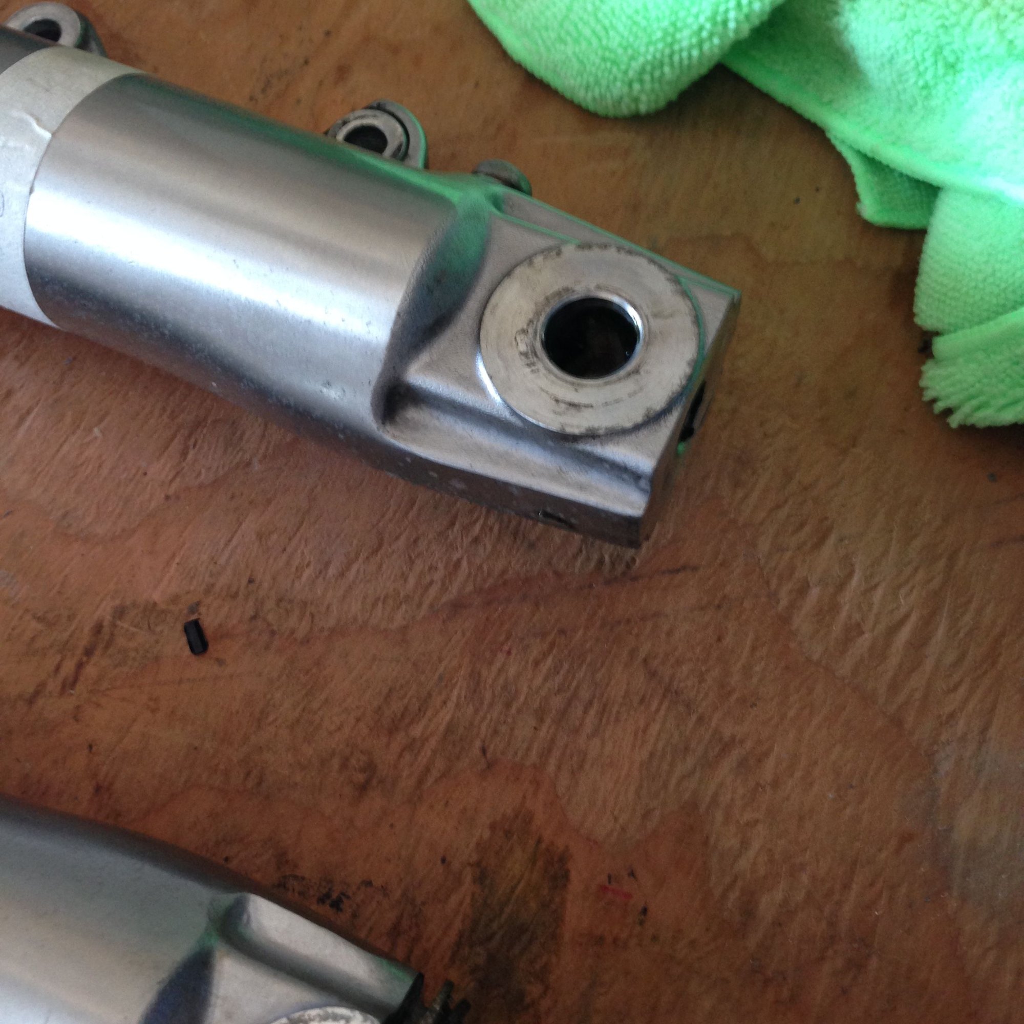

Okay I need 2 tips at this point:
Any tips on removing the Allen screw on the bottom of the fork,, it's super tight, I can't get it loose,
And how to remove the fork tube plug

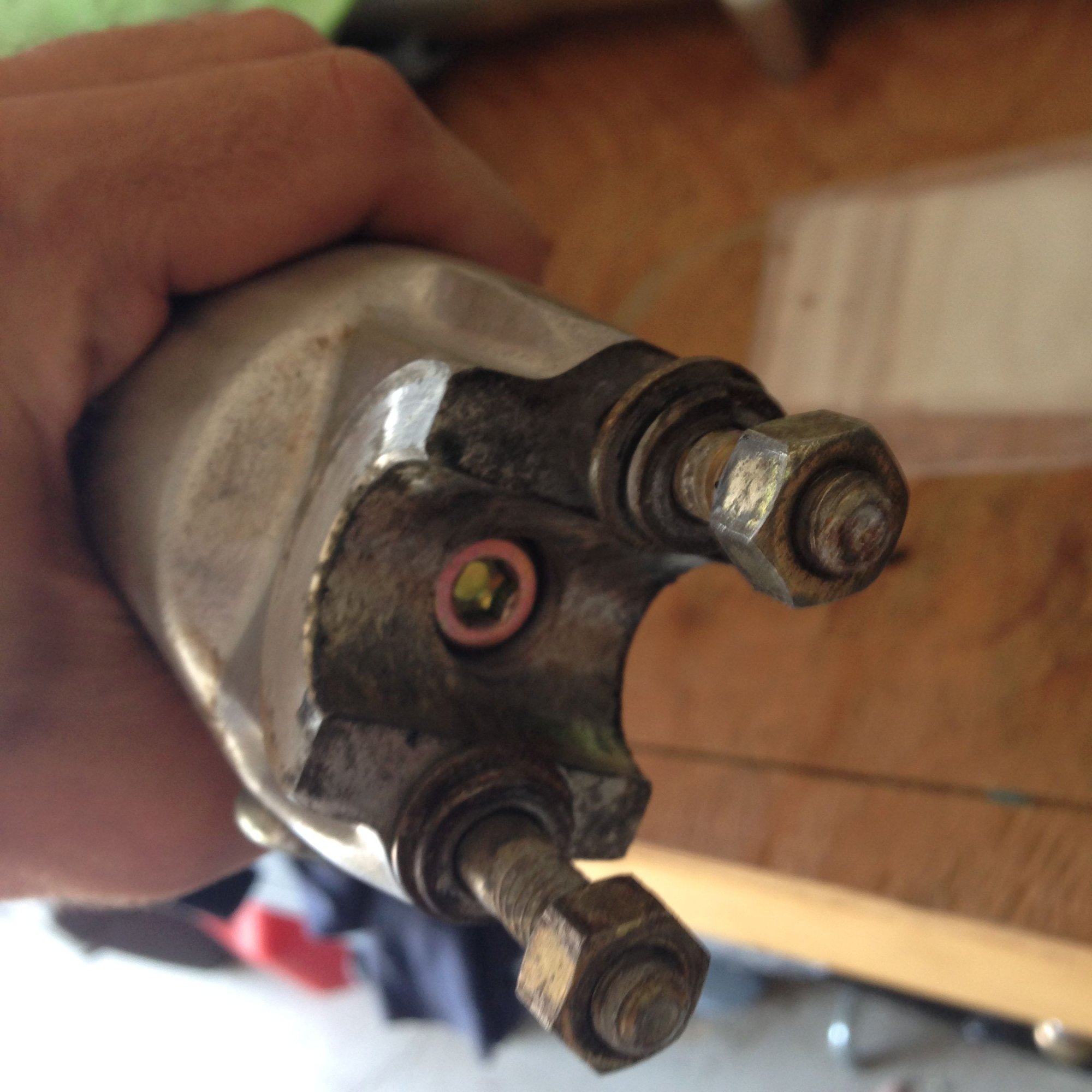

Ok I am able to loosen the Allan bolt on the right fork. But left fork is a solid piece compared to the right fork.. How do I get that Allan bolt out

Use an impact for that allan bolt on the bottom. Otherwise, the guts inside will turn with the bolt every time you turn it. I'll look for the video I used as a reference when I did mine but you really should wait till you have that shop manual. The are specific torques you need to know.

I have the print out of the device manual, it says if you don't have impact wrench, turn it once to leave loosen then proceed to taking off the top. Which is what I did. I did one turn only.
Problem is the other fork I cannot get to.

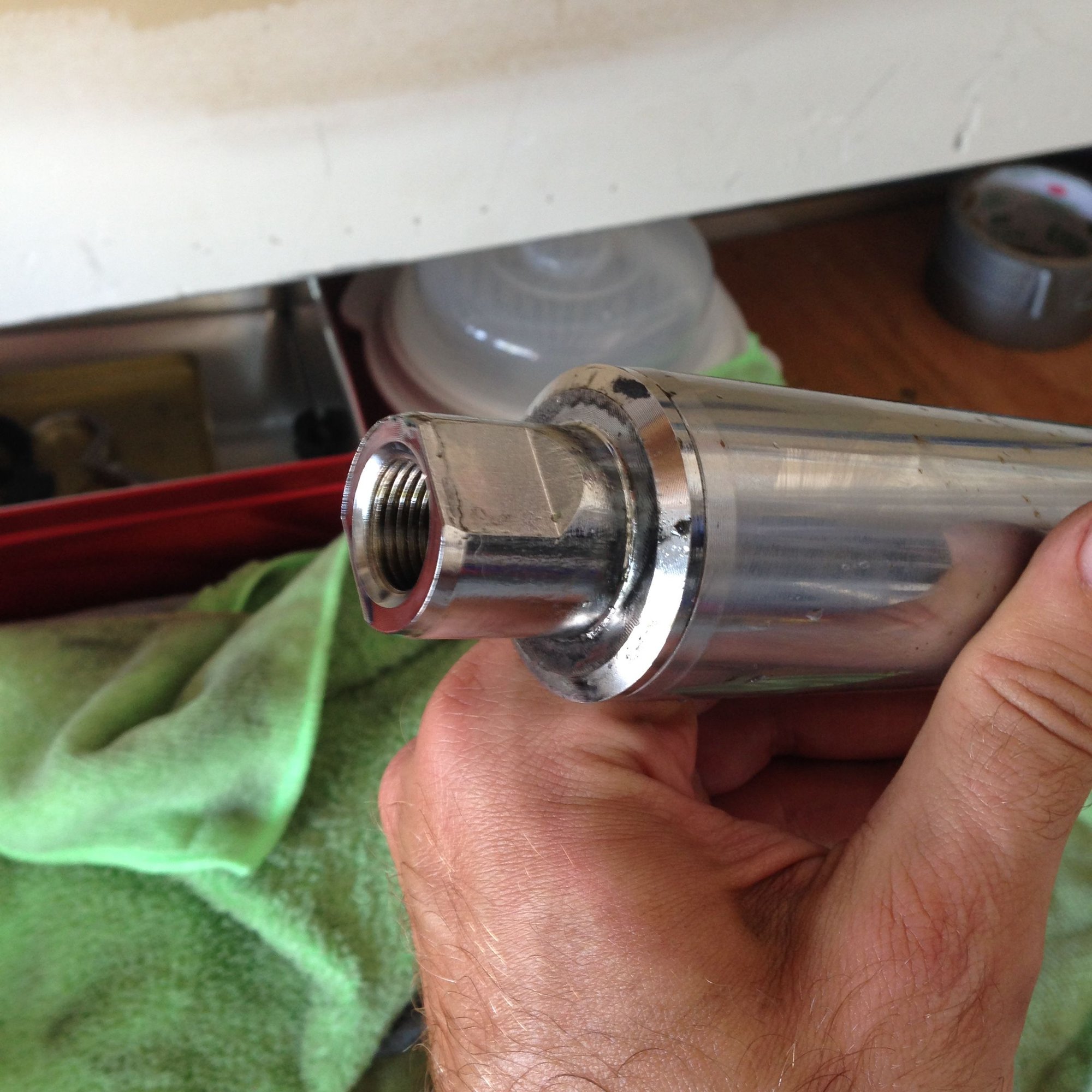

I am still stuck at post -#21
I watched the videoes but that fork is not the same.. When he pops the cap off thete was no fork tube plug

The fork tube caps are threaded. They need to be unscrewed to remove them. Use caution as they are under spring pressure.

You should have loosened the top plug while it was still in the triple tree and the clamp would have kept the tube from turning.
Probably best you took it into someone though by the sounds of things.
