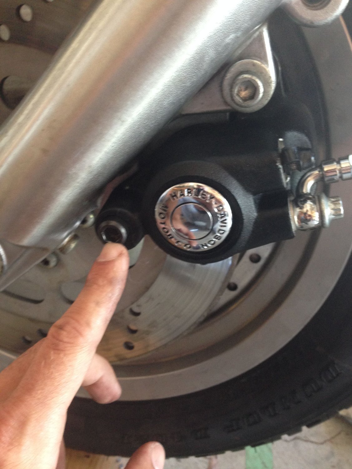

Hi guys I was tightening my bottom caliper bolt but , it just spins like it's been stripped. I was using a torque wrench and not even close to maximum torque
Any ideas?

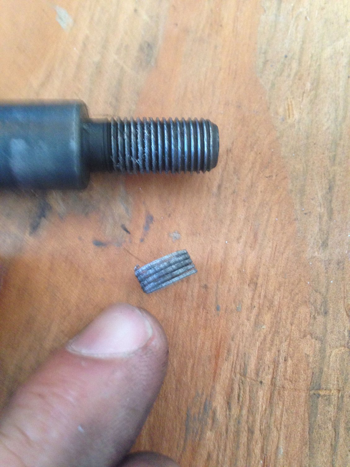

Ok upon further notification, this little bit came off the scre2, looks like some one inserted a helicoil that in the the caliper bracket that came off? Right?

Those are part of the threads in the caliper. CL ot Ebay and caliper for a few bucks and be done with it.
Some will say timesert or helicoil; not me, not on one of the two brake calipers I have to stop me.
Anti seize or even locktite changes torque specs. Somebody probably didn't take that into account before you got a hold of it.

EDIT: Forgot to add, OP, me thnx ya should do as suggested and replace that caliper. Looks like someone screwed the threads up. I would inspect the entire setup at that point, see what else he did to the mounting.
