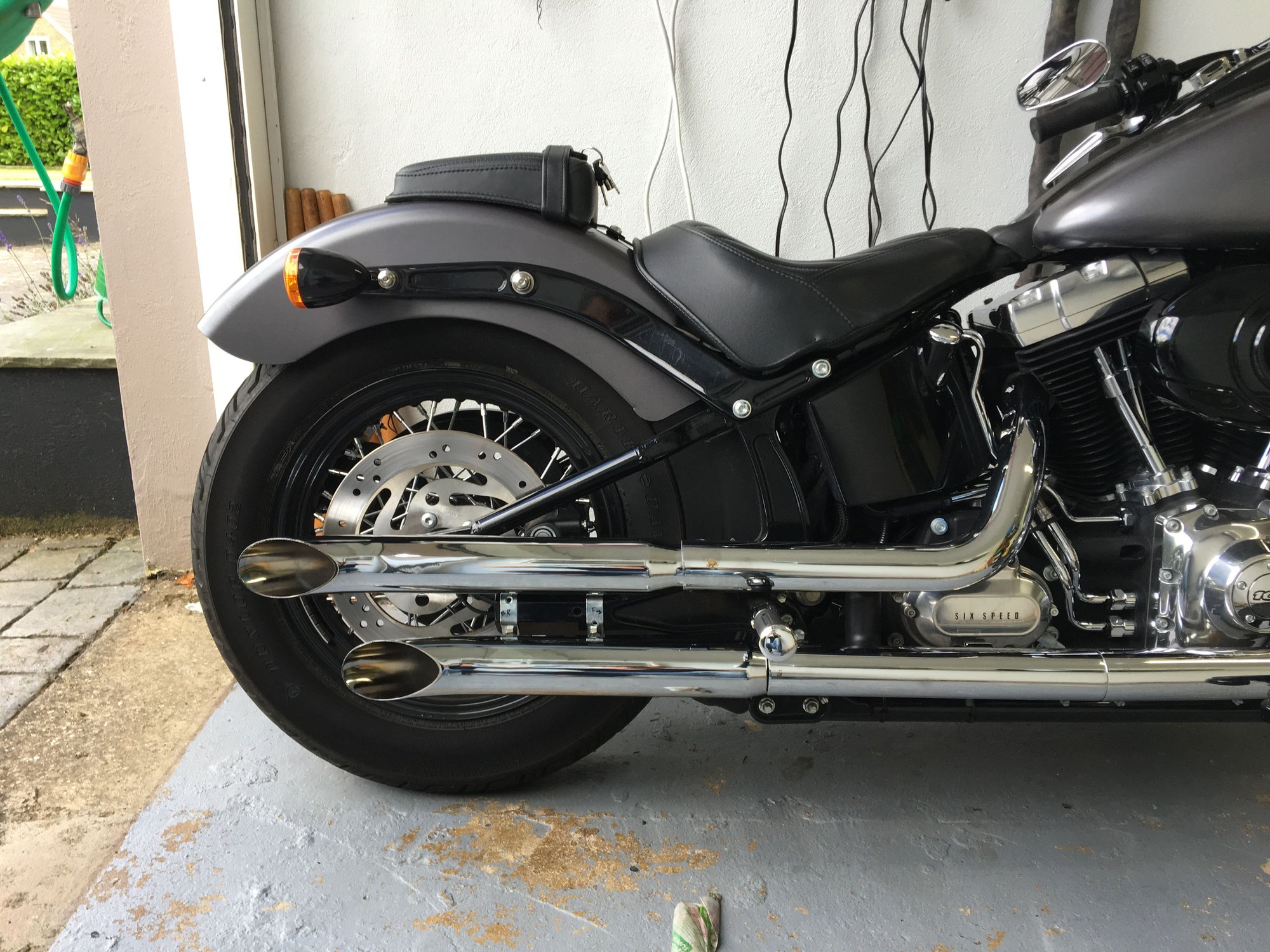

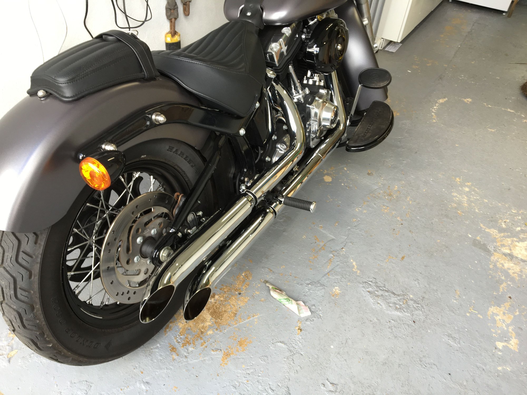

Wow.

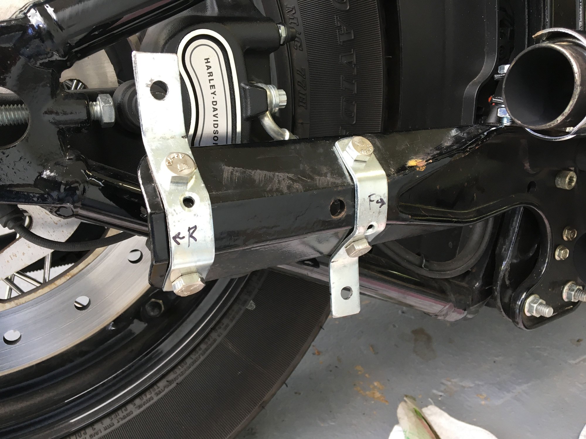

Just fitted them and they're great! They've got a steel perforated 'tube' baffle with a couple of 'spoon' shaped scoops set to either side in the middle, so they're not 'too loud', but definitely noisy

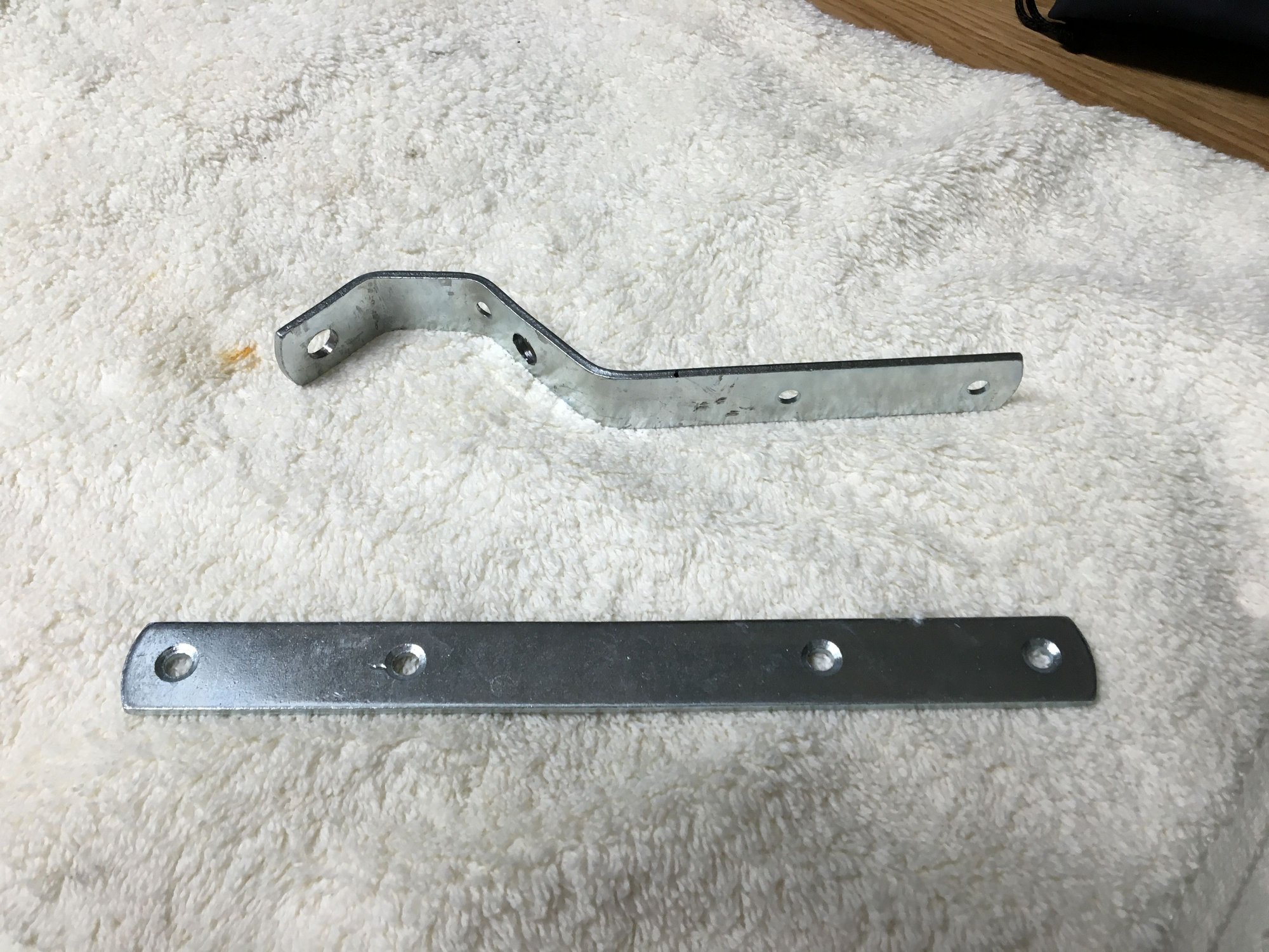

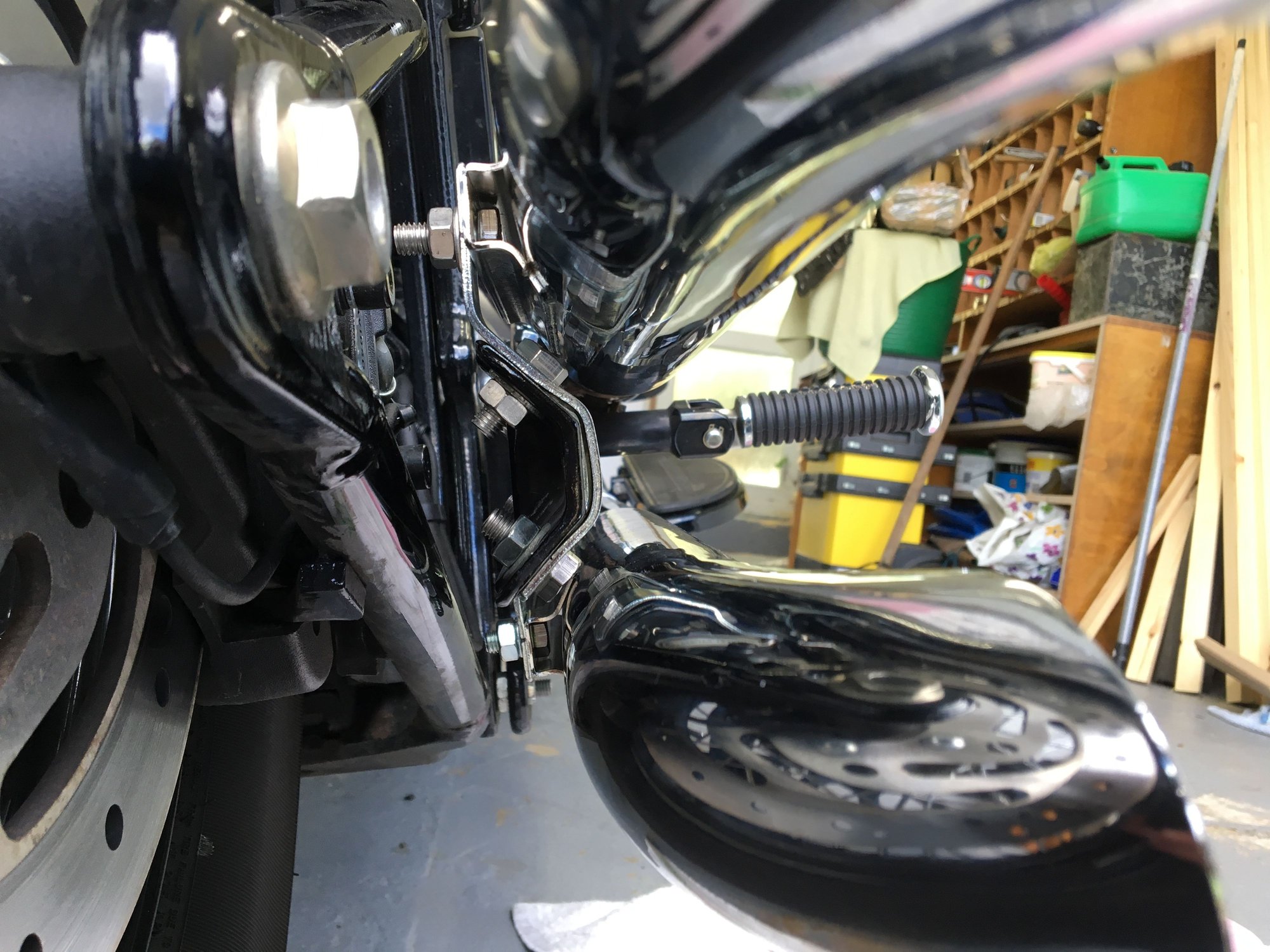

Fitment was a bit of a challenge, I had to make up a couple of brackets from some metal I had kicking around, but in the end they fit really nice.
And sounds great! Nice 'Harley rumble' without being too loud or tinny.
I'm pretty darn pleased
home-made support brackets
...they attach to the mufflers' universal slider bracket
Nice retro look
I'm a bit pleased

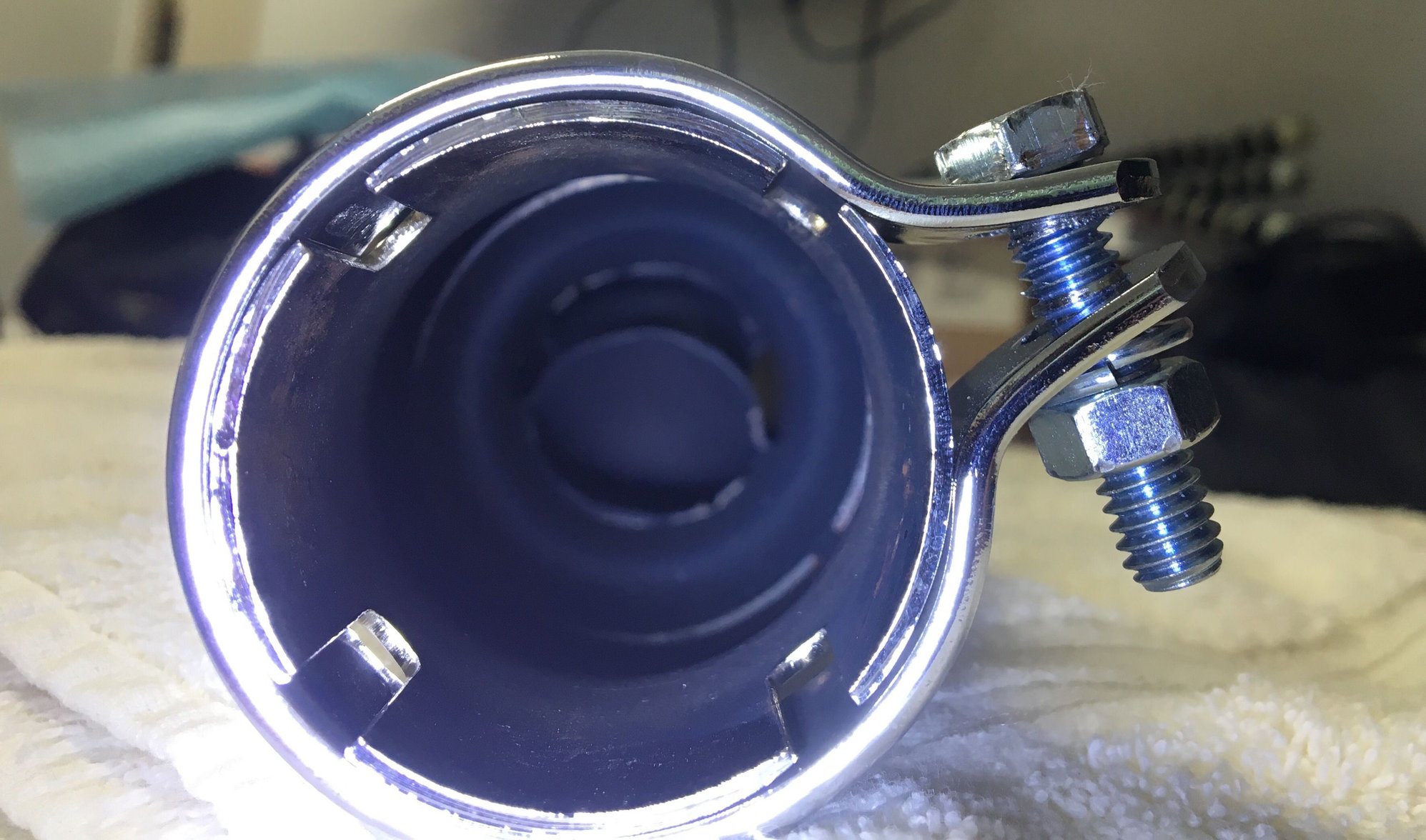

Agreed, those look quite nice! I don't suppose you have any pictures of the baffles do you? Or a sound clip?

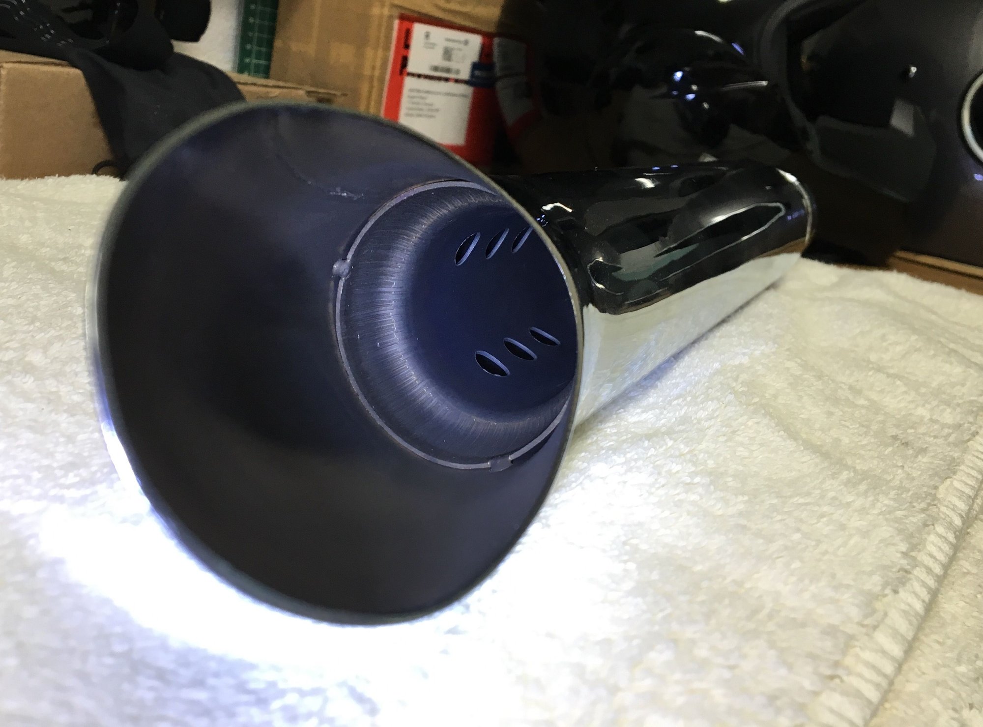

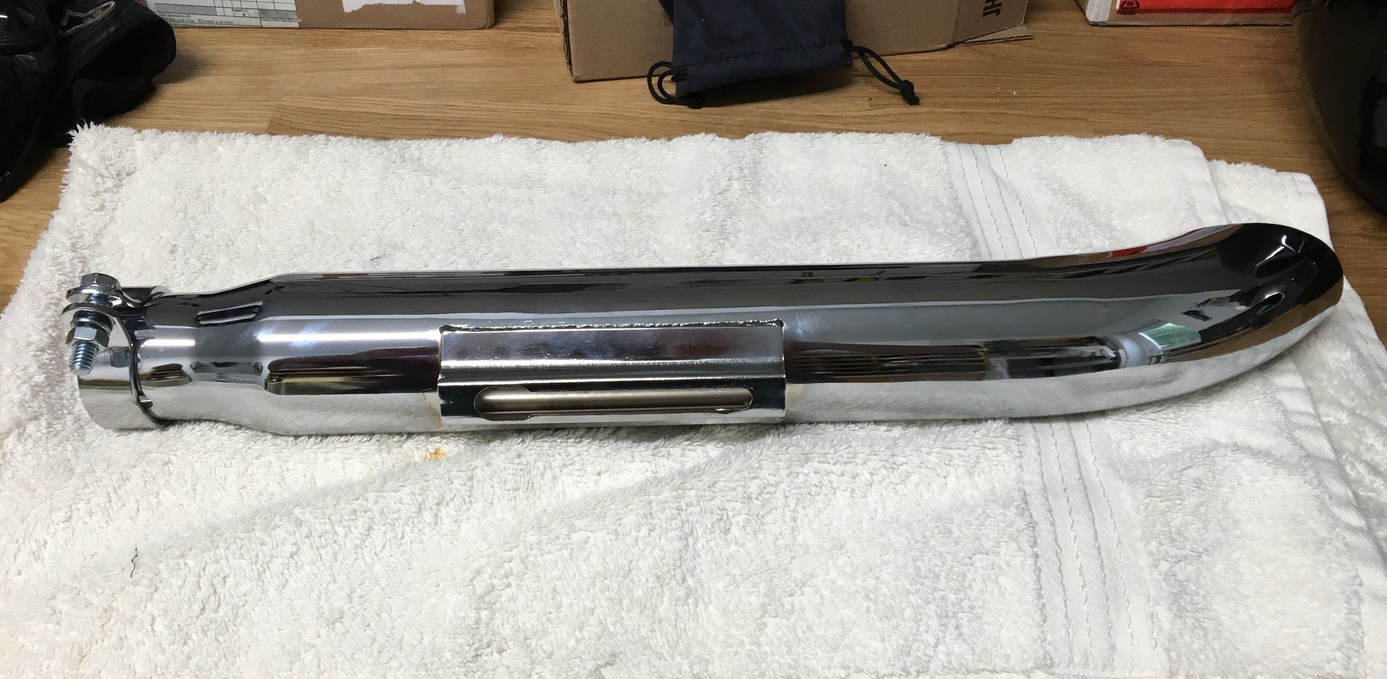

Sure - here's a few pics showing the slide bracket and baffle - one pic from the outlet and one of the inlet.
I'll try and do a video over the weekend - the sound is definitely 'loud', but not as loud as the V&H 3" slip ons or Big Shots that I've had previously.
It's a more 'authentic Harley sound' - not the boomy hollow sound I think the V&H's give
Baffle from the outlet end - you can see it's been spot welded in (non-removable)
Baffle from the inlet end - you can see a couple of 'scoops' which help to keep the noise sensible... But it's still 'loud'

And the brackets are literally just a couple of brackets bent into shape with a vice/pliers/hammer, a couple of strategically placed drilled holes and the excess cut off/filed.
I had to drill the holes in the stock muffler bracket a bit larger (8mm), but really, a vice, hammer, hacksaw, file, drill, the right bits and an hour of fettling and it was done.
I'll probably get some thicker gauge flat bar at some point to make them sturdier, but to be honest these are doing the job just fine.
Either way they need painting black
