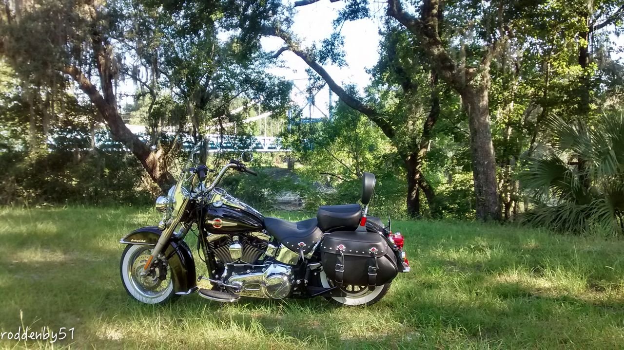

2016 Heritage: Power Vision tuner, running Stock Improved tune by Fuel Moto... noticeable improvement.
