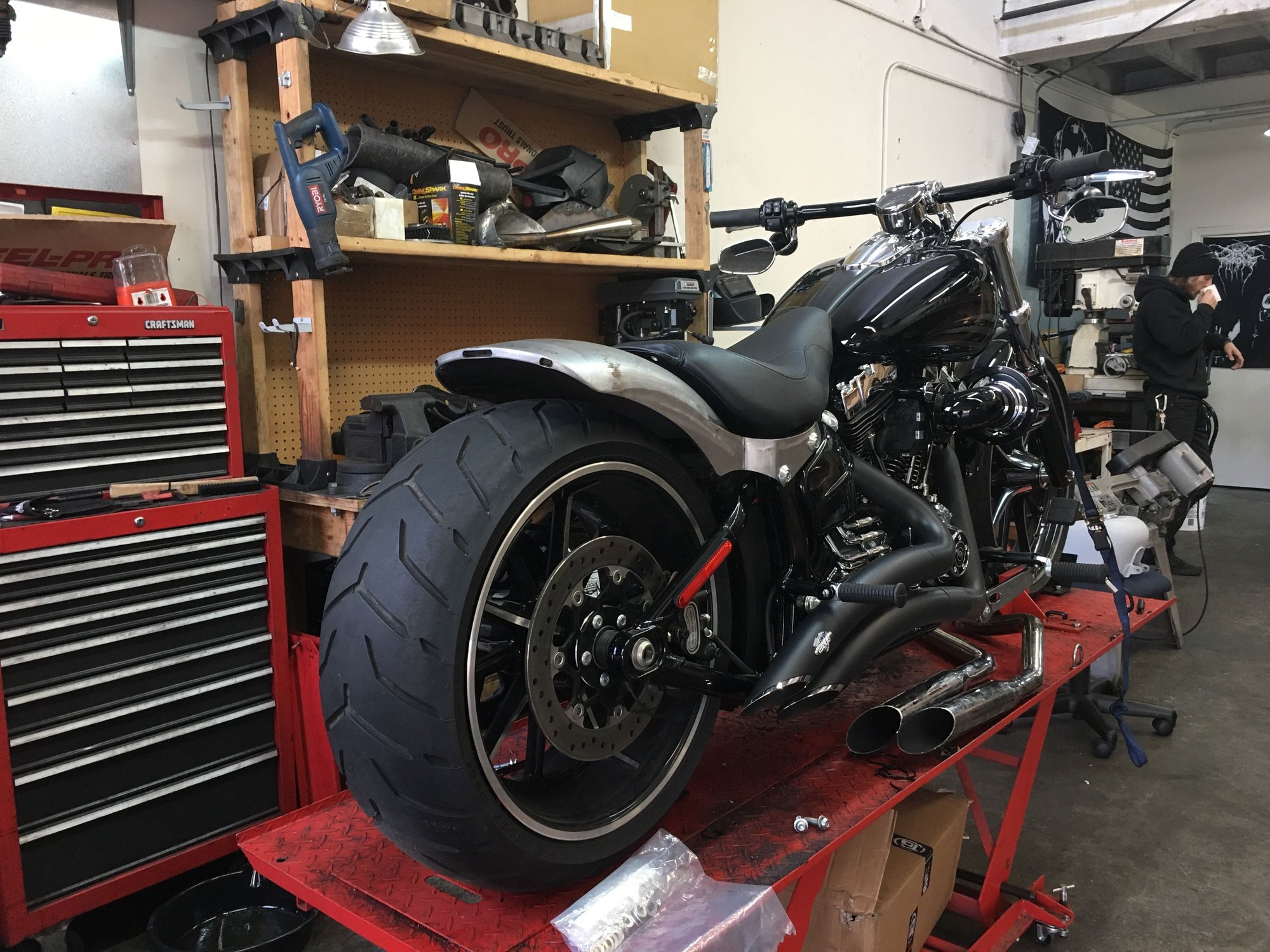

Hey folks,
Here's an update! The fender from thunderbike arrived and we got it installed. There was some grinding work to do to get it to fit correctly (as someone mentioned). The original seat pan doesn't really fit all that well. So we'll either be making a new one or trying to mod the original to make it fit.

One concern s the lean-angle. Even right now at the standard/stock height I scrape the pegs pretty easy. I'm worried that lowering it will reduce my turning potential too far! Any thoughts on that?

Of course an air ride suspension is the best way to reduce/eliminate the peg scraping, you can lift the bike higher than stock, if needed in the twisties....but the first thing you should do is lose the stock offset pegs with feelers, and replace them with something shorter and smaller in diameter, that stick straight out with no feelers. That will make a big difference, and even if you lower the bike, the new pegs will still probably be higher then the feelers on the stock pegs are now....I also installed Progressive fork springs, and they really reduce the amount of nose dive in turns, which helps with the peg scraping problem as well....
Here's my Ness pegs, something like this will help a lot with the lean angle!! I also have the 3" forward control ext., I think having the pegs further forward probably helps even a little more.
