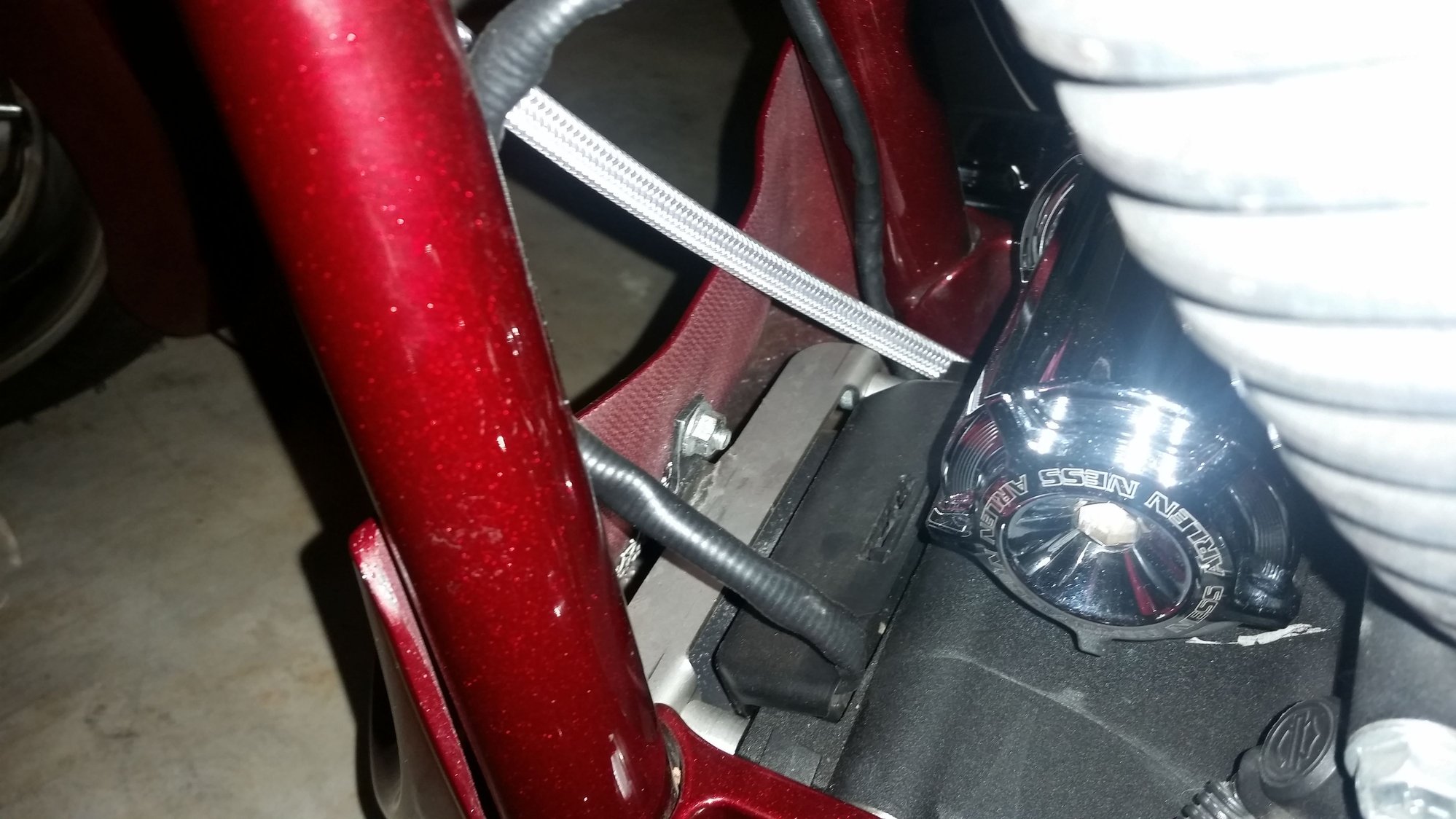

Originally Posted by Rocker B
Hey Ray, have you had it painted yet?? Not sure if the spoiler for ABS mounts differently, but I had the same issue, with the TB spoiler on my Rocker, and there was a fix. I didn't like where the front mounting bolt went through the spoiler, so I bolted a piece of steel to the original mounting hole and drilled another hole at the other end, moving the mounting hole location higher by a couple inches. When I fitted the spoiler it had a gap between the frame, but I was able to bend the new steel mounting tab back, pulling the spoiler up tight to the frame.
The principle and parts look identical...
Point is, I had my dealer prep fitted the spoiler. It was their first time to fit a Thunderbike spoiler and what they did is they followed instructions and the instructions came with the spoiler, by Thunderbike . Now the center mounting hole sits quite high on the front of the spoiler and will cause this unfavorable gap.
If you only had told me earlier

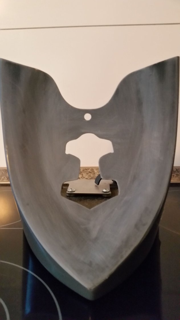

Edit: Nope, spoiler is not painted yet but drilled already and I also cut the air inlet hole into the front already....

That looks good...and the top off that spoiler is a little different then mine in the way it comes down to more of a U in the middle, probably because of the ABS. So my fix wouldn't have worked for you anyway, I moved the mounting hole higher then the original location, and you don't have that option...

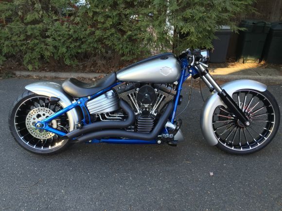

As for the 21" rear wheel that's in the pic....I agree with Rocker B that the open wheel on the right looks quite nice, but that option implies serious work to be done to the left side and might even require cutting the swing arm, welding of brackets and mounting tabs etc. Also note not everything that is shown on those Thunderbike promotion pics really works for everyday riding. Did you check if they maintained the stock swing arm and what else they had do modify to fit the 21" wheel?
In terms of lowering the handlebars you could first try to use some short straight risers instead of using clip-on bars. Keep in mind that the complete speedo and indicator light unit relies on the handlebar clamp. Eliminating this clamp will bring up the issue of finding an alternative for the speedo etc. I don't know what's your height and/or arm length. I'm 6'4" with rather Gibbon-style arms With the Thunderbike flat risers (with 1" riser spacers) on my bike I find the forward lean to be on the limit...any more forward lean would be uncomfortable. Extended forward lean of your upper body combined with the forward position of your feet due to the mounting position of the pegs will make you look and feel like a swiss army knife....may look cool but won't feel cool after half an hour.
For the 23" wheel on the front....nothing I can say about that. I think I once saw a Breakout with one installed but can't really remember what it looked like....
Sounds like upping the wheel size is a huge PITA and probably pretty expensive. I'll stick with the stock 18" until I win the lotto.

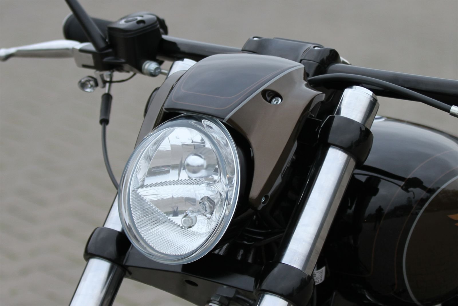

But here's some pics from the Thunderbike website with their flat risers

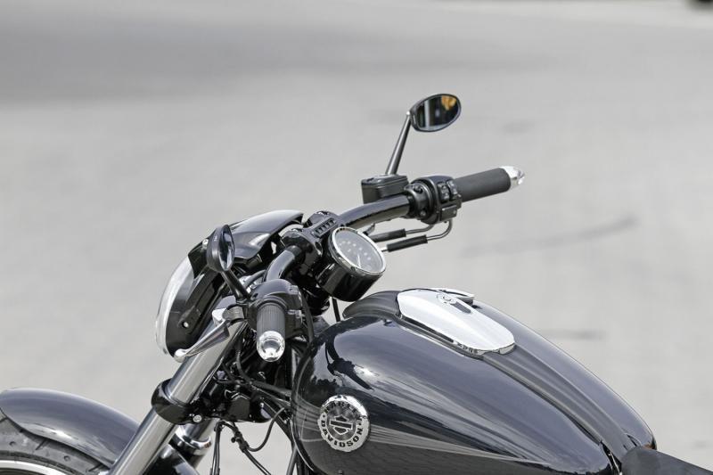

This a pic of user Nostradamus74's Breakout when he still had the flat risers installed, that I have now on my scoot
