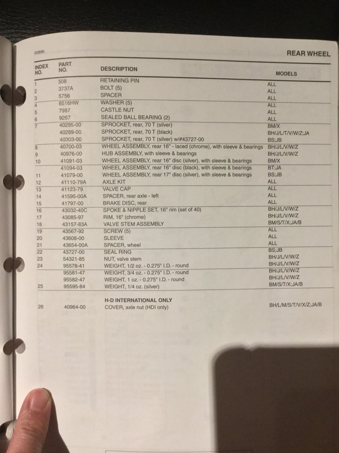

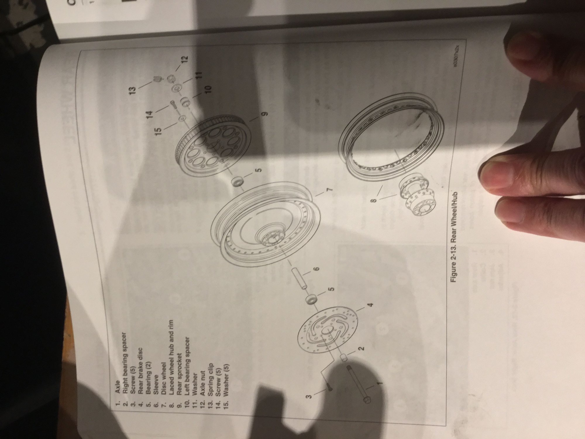

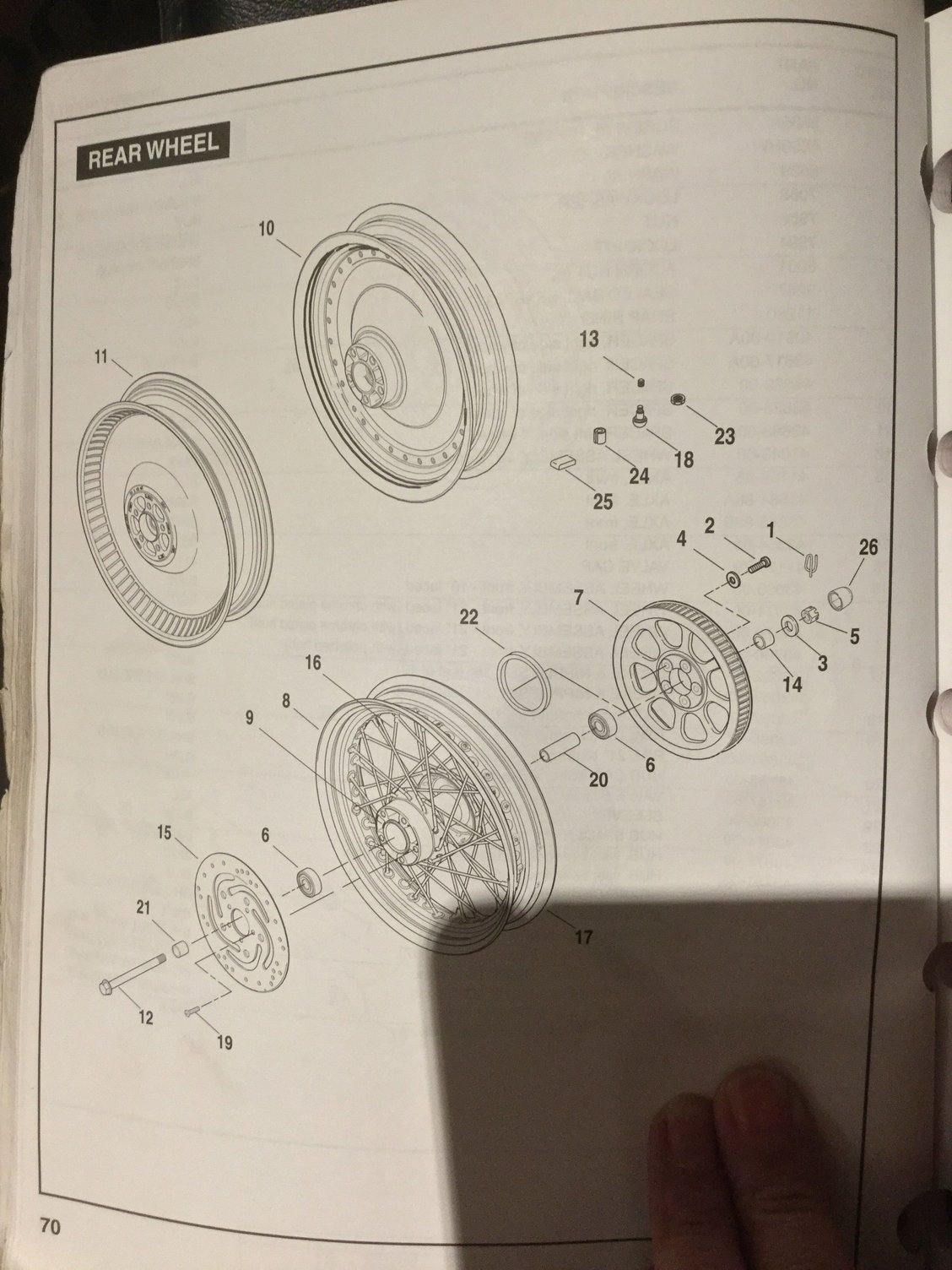

Does anyone have a diagram of the spacers for a 2004 softail? When I removed the back wheel I kept the spacers all in the correct order and then managed to drop them! D'oh!
The workshop manual does not shown all the items (swingarm, brake holder, wheel etc) in the sequence.
Help anyone?

Originally Posted by Gaz B
Thanks for your reply. I have similar pics in the workshop manual & parts books (see below), but they don't show the sequence everything goes onto the axle. E.g. The adjusters and brake carrier are not shown.
(Sorry for the grot pics!)

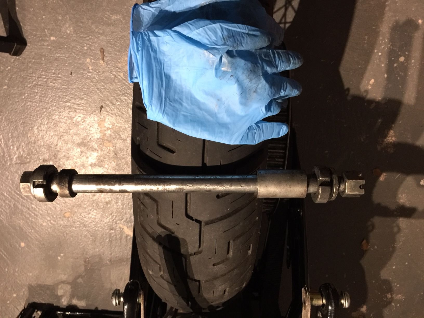

Does this look ok?
This is the order of the spacers and the last 2 pics show fitted.

That looks right to me,
how's the disc running in the calliper, nice and central and not biased to one side? If so I think you're sorted!

Nope, all seems to run true!

That's the correct order. I've taken my 04's rear wheel out around 65 times over the summer so trust me I've seen it more than a mechanic by now lol.
