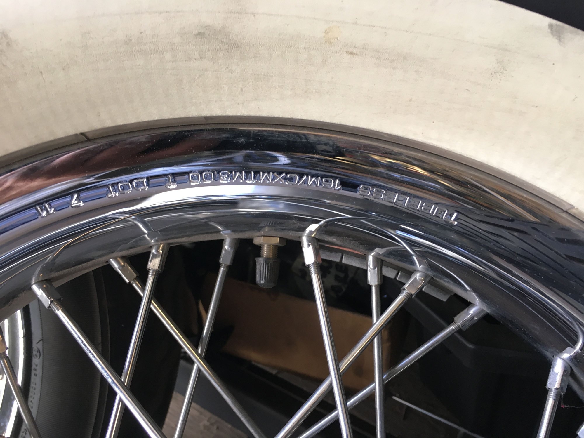

Originally Posted by Mike Lawless
The tubeless spoked rims have a liner that goes up and onto the bead area of the rim. The tire bead seals against the liner.
The valve stem is bonded to the liner just like it's bonded to a tube.
The liners are available new from HD and cost about $25 each.
I did a whole post on this in the tires and wheels section of the forum when I did the conversion. I bought the wheels from a guy who took 'em off his new '15, and converted 'em to use on my '06
This post is correct............

My dealer insists on replacing the liner with each tire change. Your tire is indeed tubeless. Its amazing what advise people will give when they dont have a clue.

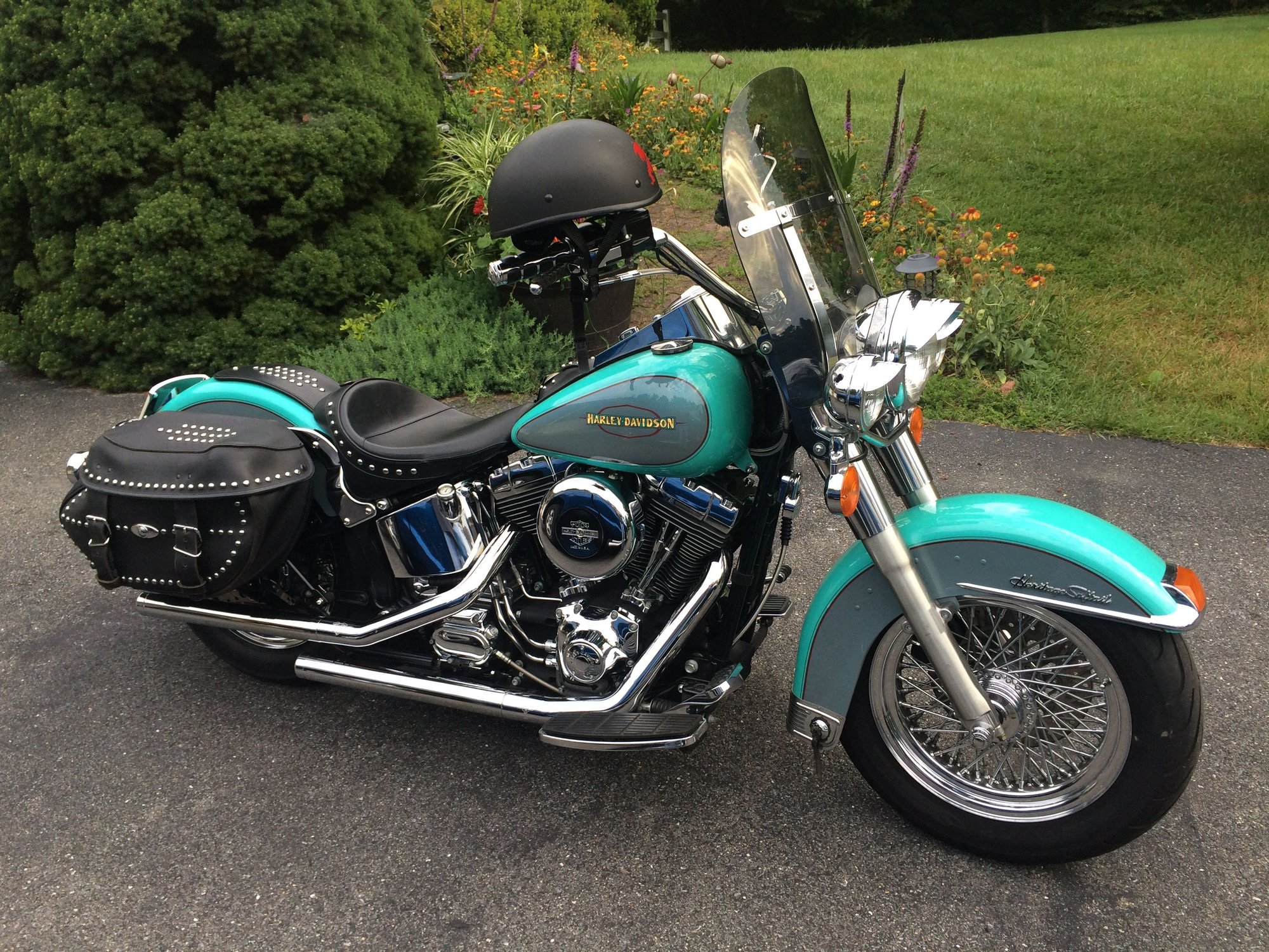

My spoked rims have been tubeless since 2000 on my Heritage.

All H-D spoked rims from 14 on have a sealing ring and are tubeless. Prior to that some had the feature.
No one has had a problem with the seals. However when replacing the tires some have had the sealing ring disturbed and it needed replacing.
Tubeless tires that folks put a tube into it will run much hotter and that is not good for tire life and durability.
Really nice looking bike.
