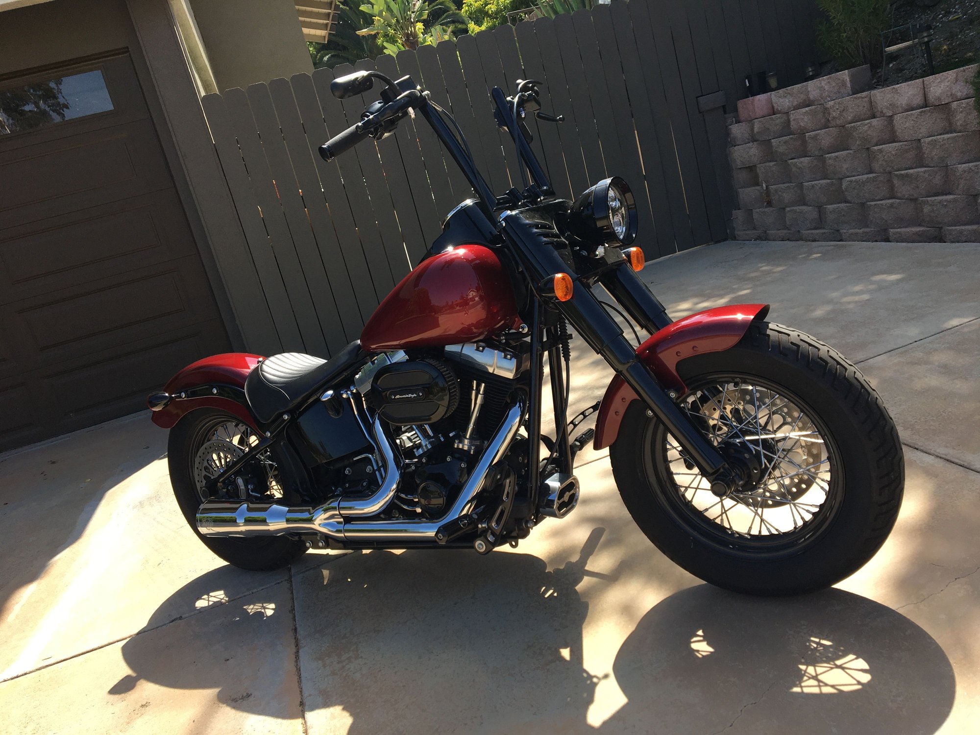

This is my 2016 softail Slim. Lowered the rear fender an inch (not quite a full inch, otherwise the old hole would start to show bellow the strut) by drilling 4 new
strut mounting holes.. And a half inch via suspension.
This way it looks and rides good.

this might be something to report on in detail in the softail cheap modification thread! Sounds pretty clever and cost effective.
