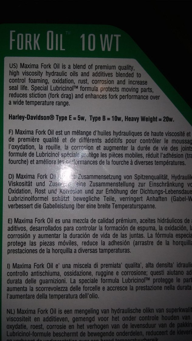

Front fork oil and maybe new front springs if the stock ones are beat up. Stock harley type e is 5wt so I would go 10wt.
