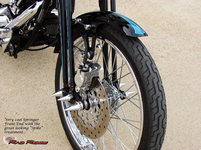

did you see this? Looks like the fender is on some kind of rocker links?

Wow! The paint alone was $5K! You can barely buy a Sportster for $6K. This bike has only 3800 miles on it and is in perfect condition.
Your really hung up on that fender. Hell the buyer can take the damn thing off if he doesn't like it. I mounted it the way it should be according to Harley so it would be safe.
The front is not compressed with the straps on. The guy made some offset brackets to move the fender down.
The reason the fender moves differently is pretty simple. Rockers are normal Harley springer. The axle is further forward than the front fork tubes. The pivot is at the back forks. The axel rises faster than the front fork under compression. That's why the newer Harley springers mount the fender to the brake bracket because it is fixed to the axel. I knew nothing about springers when I bought this bike, but a little research told the story.
The picture you posted above is the newer style fender mounting. I am aware of this and mentioned it in my previous posts. The fork I have is the early style. It doesn't have the proper mounting points for that fender. It could be modified to fit but would likely look like crap. Plus it would cost a pretty penny to match the paint.
