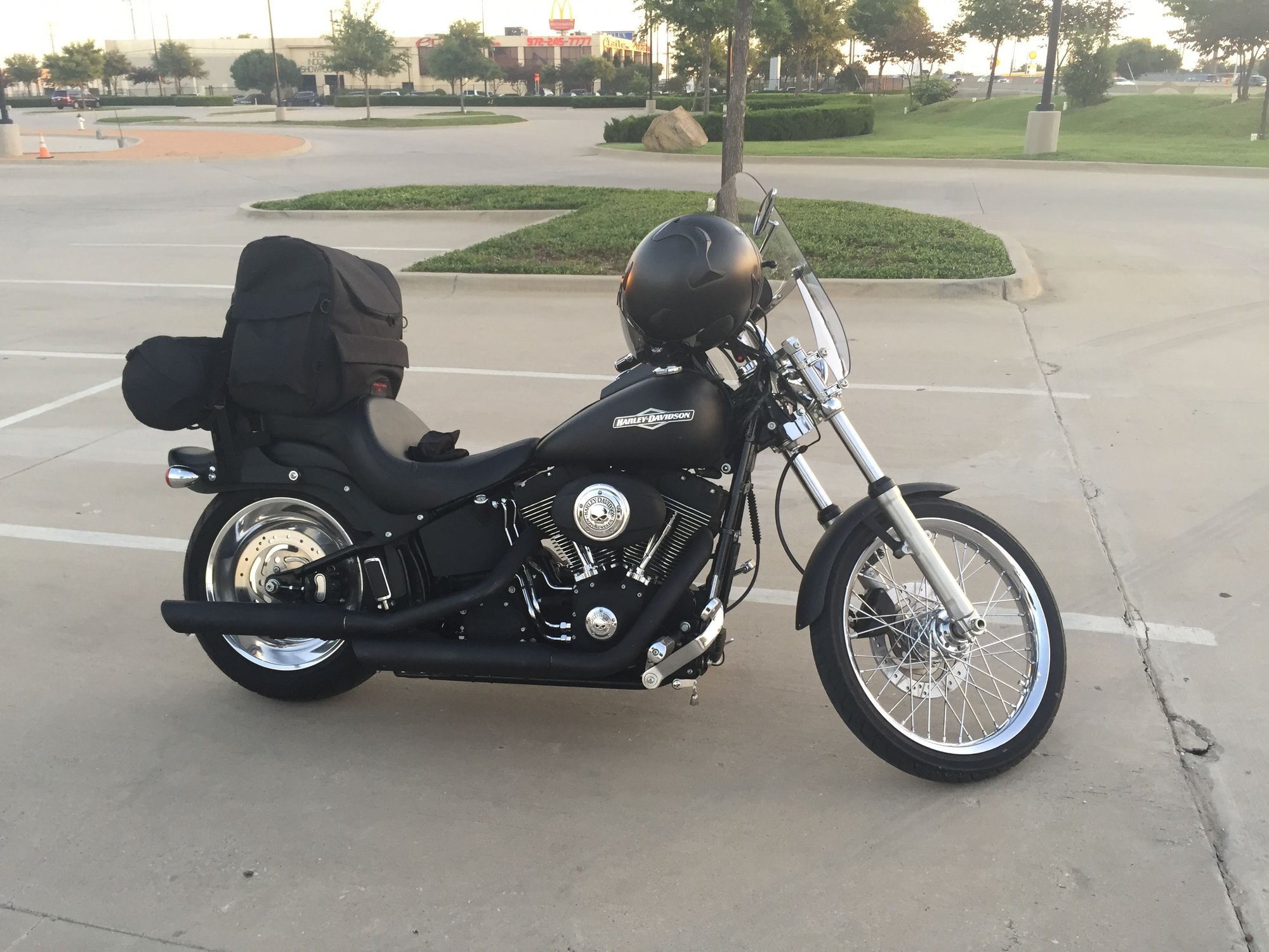

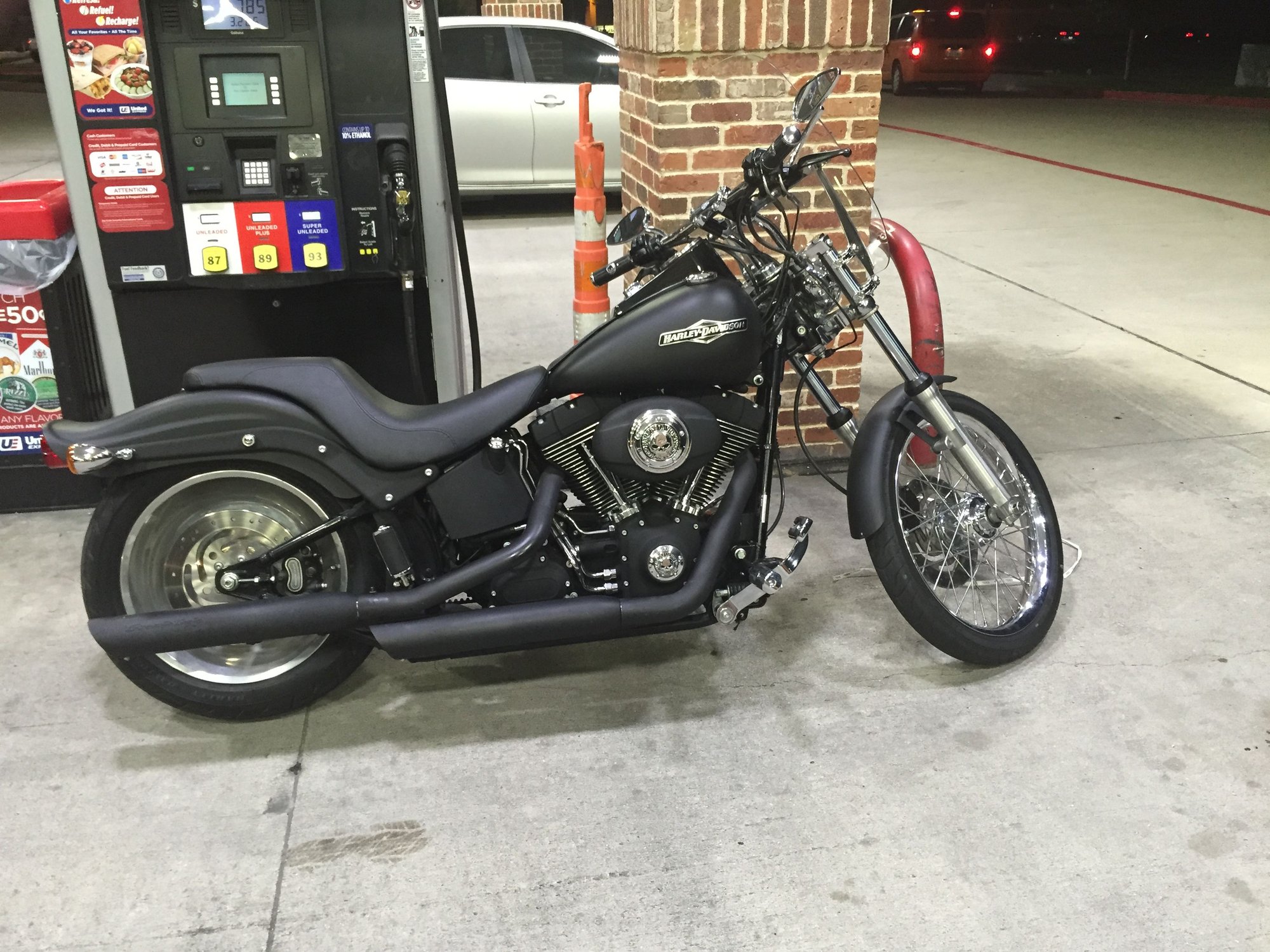

Welcome to the forum JFK3rd! I cant answer any of your questions but wanted to say congrats on the NT. I love mine and it receives positive comments wherever I ride. Enjoy your new to you Night Train! Here is a pic of mine...
fillin' up
headed to ROT Rally 2015
