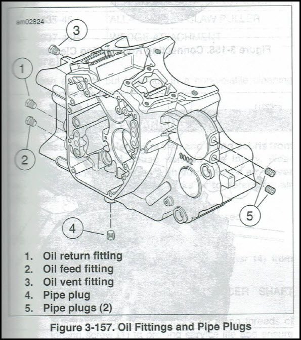

I removed the wrong drain plug on my 08 heritage tonight. I was doing the oil change and removed a threaded plug with 1/4 hex. I believe it is the crankcase drain plug that should never be removed
What is the torque spec for it? I plan to use some high heat locktight on it as well.

Use teflon tape instead and to not tq it tight. It is tapered and will crack the aluminum if you turn it too far in. I installed mine by hand till so I am not sure about tq. I put it tight but not so tight I had to force it

per the manual apply loctite 565 and torque:
#s 1, 2, 3 torque to 120-168 in-lbs
#s 4, 5 torque to 120-144 in-lbs

120 inch pounds.
Thank you.
I do have a service manual.... but my memory does not remember what box in what shed it was placed lol. Spent 2 hours trying to find it... gave up when the sun went down. Thanks again!
