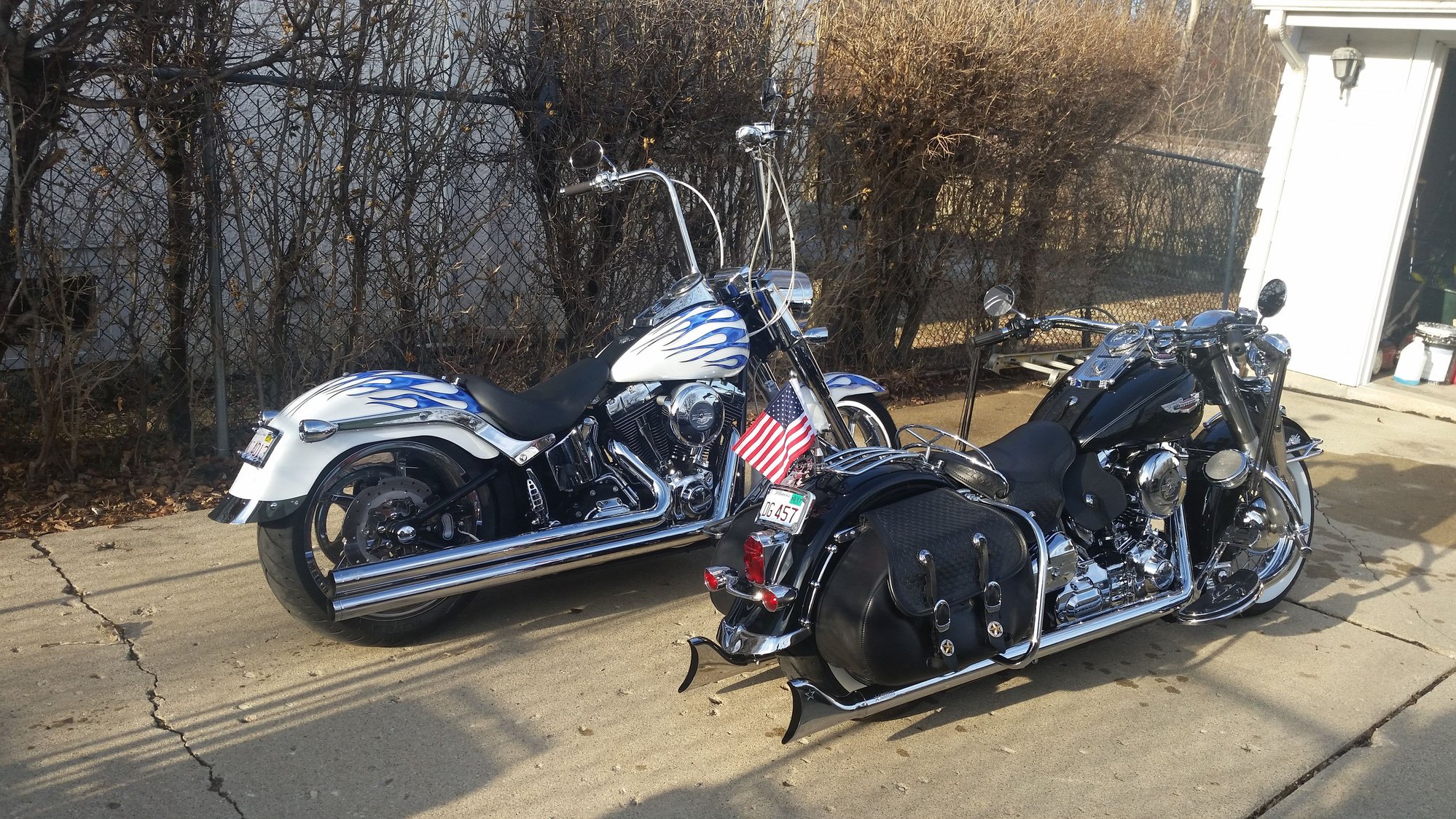

I like those bags. I really like how they tuck
so close to the fender.
I'd put those on mine, with the Springer bag guards.
They look great with that saggy-bags kit in em
