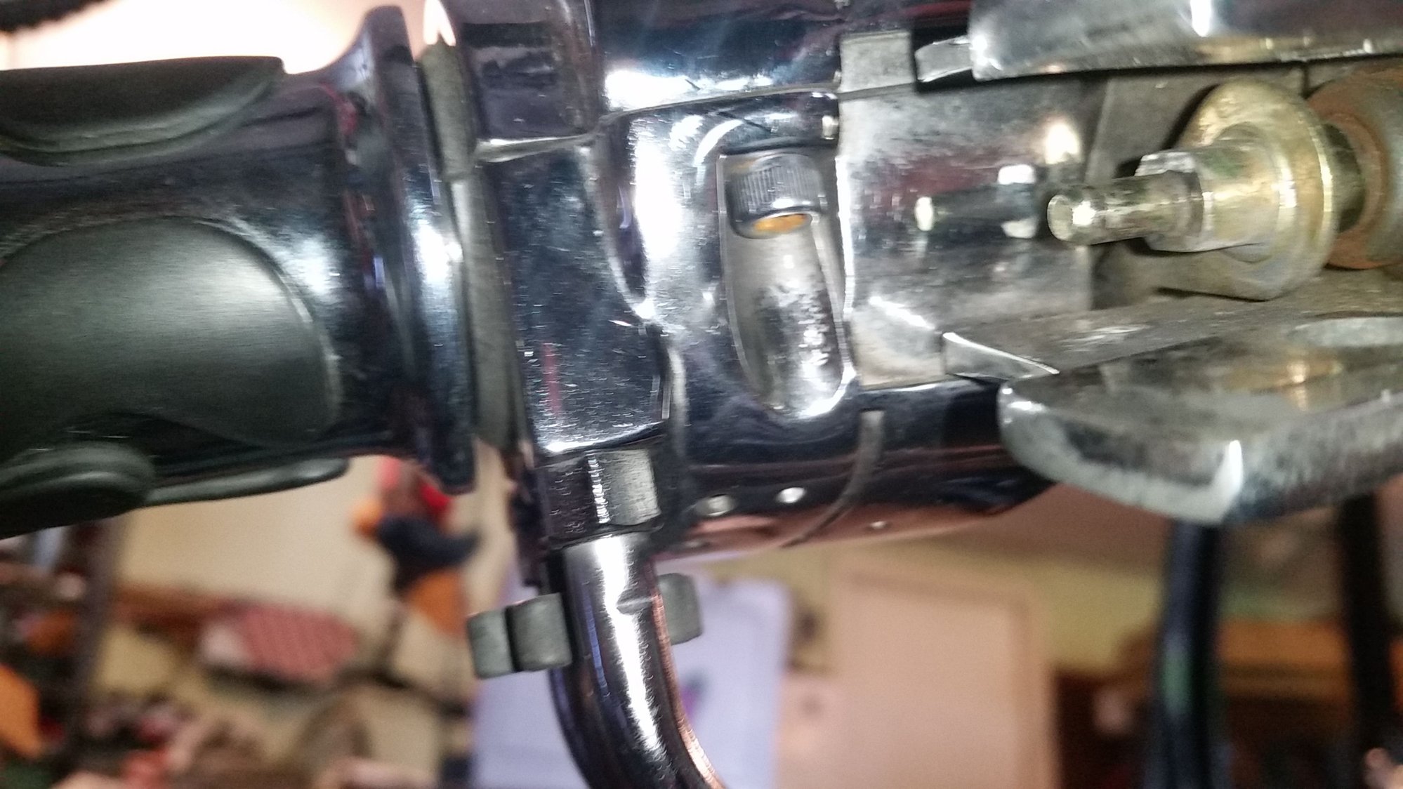

there is no bot on this model it is a plunger here is a photo

im not sure if you guys understand? there is not a boot on this year front breaks it is a plunger I will try to add a photo
The switch is behind that plunger attached to the switch housing and is pointing 180 degrees opposite of the brake plunger you pictured.
Look at the switch housing and that picture I sent the link on and it should make sense. Follow your brake lever in and you will see where the switch is supposed to be. The lever actually fits past the brake plunger and keeps the switch closed and opens it when you operate the brake.
Take off your switch housing and you will see the switch.

What the Canuk said the link he posted your switch is item 10
