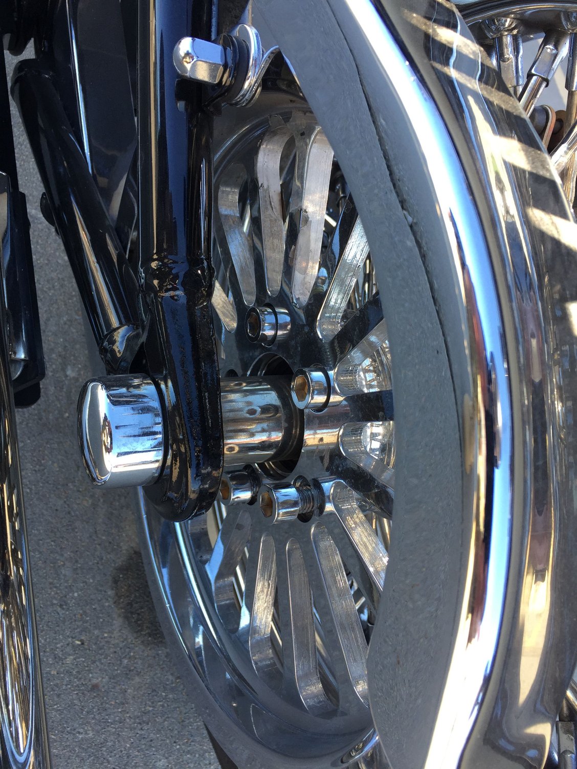

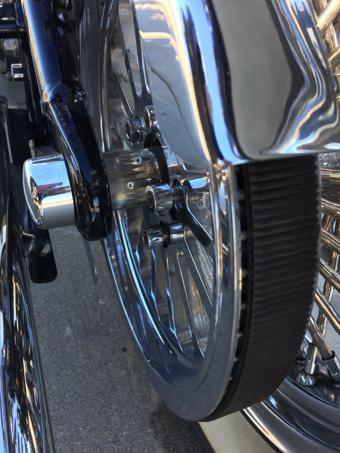

thought I had a tire problem....... nope!
Lucky I got as far as I did before noticing

Hmmm, looks like somebody forgot to tighten a few bolts. Glad you caught before you got hurt.

Ya best tell yer mechanic that HD's like torque wrenches and locktight,,,,,,

Well, I bought the bike with those wheels on it, just took it for granted that everything was OK. Lesson learned

The tire issue still seems to be there after I tightened this mess up..... but man.... if some of those bitches backed out anymore, they would have been snapped off clean in the hub, or worse, just locked the rear wheel up!
HD will "fix" it...... of this I'm sure.
Still chilly anyhow, don't feel like riding right now, just a bitch I have to spend money when I wasn't expecting to.

Put new bolts in. Check your pulley for oblong holes.
