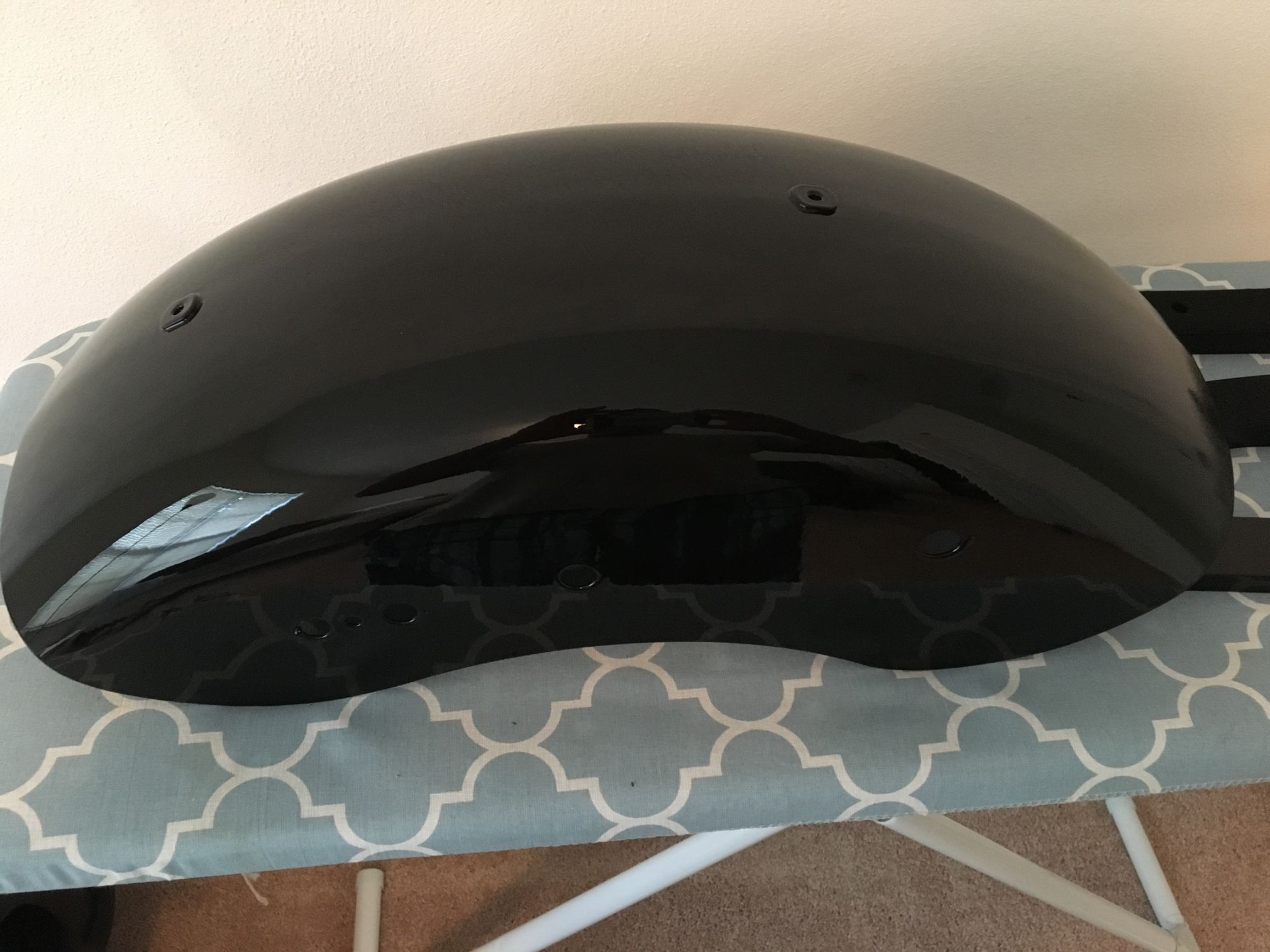

I cut mine from the back so I could re-shape the end cause I didn't like how it looked. Also the fender is thicker at the front which helps fill in the gap between the frame and the tire. I then usesed a frisbee as a guide to round the ends

Here is mine when it was done. My fender is 26 inches total lenght

Be conservative with your cuts. You can always cut more if you make a mistake. Make sure you do a mock up before your final cuts

This pic is deceiving, it must be the slight angle. The WCC fender profile matches the 17" rear rim profile almost bang on.

Stal thanks. You guys were right and the wheel/tire combo bolted right in. Trimming the seat pan, spacing the struts out 1" to clear the 9" WCC rear fender was easy. Where I ran into issues is the fitment of the rear fender. I was trying to follow Blackp5ca pictures and I messed up. I cut the wrong side of the fender the front (frame side). From a side profile the fender actually gets taller. DAMN IT!!! So I cut off the wrong side including that reinforcement.

Blackp5ca. You are a hard man to get hold of. I tried to PM to pick your brain for info but it wouldn't let me. Stal94gt has helped quite a bit. You are right on this modification. I have always wanted a fatboy but couldn't afford one. I was also looking at the RSD tracker fender kit and Heartland wide tire kit. They were all over priced and the seats really looked ugly. You have a great eye for detail and proportion just like me. Using the stock slim seat keeps the seat in line ith the frame and gas tank and it looks so much better, like stock. I got the tire on, struts spaced, etc. I literally printed off all of your pictures to copy cat. I made a mistake on the cutting of the WCC 9" roller fender. I cut the opposite side from you. It looked like the radius they had you kept and you just cut 8 to 10" off the frame side, or so I assumed. So now it does not fit as it should! What did you use for your radius, did you trace the stock blackline fender for that curve? I was really trying to get the exact layout and shape of your bike, it looks badass. Really bobbed out buts stock. I also noticed you drilled the 4 holes for the struts, but on the inside of the struts closest to the seat there are 2 more holes. DO you know what i mean, did you drill those too? What is the total length of your fender now? 9702019639
