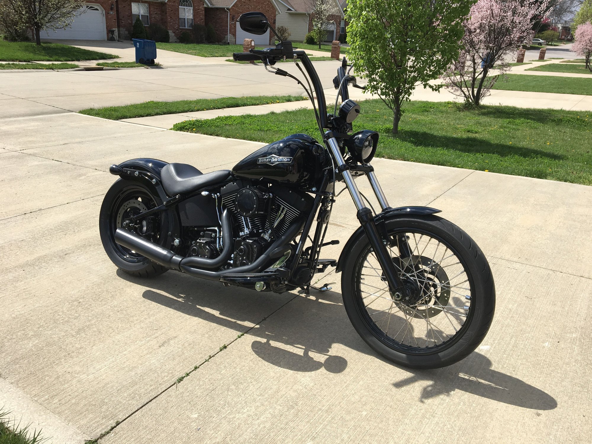

You maybe cheaper going with the wcc fender it is 140 dollars and it is not a hard job to fab up. Blackspa helped me threw the build on my bike. The swing arm is the same on the slim as every other 09+ swing arm so you just need the rock guard which is cheap and to space out your fender struts. I used a 20 dollar cutting wheel to cut the fender to the size and shape I wanted.

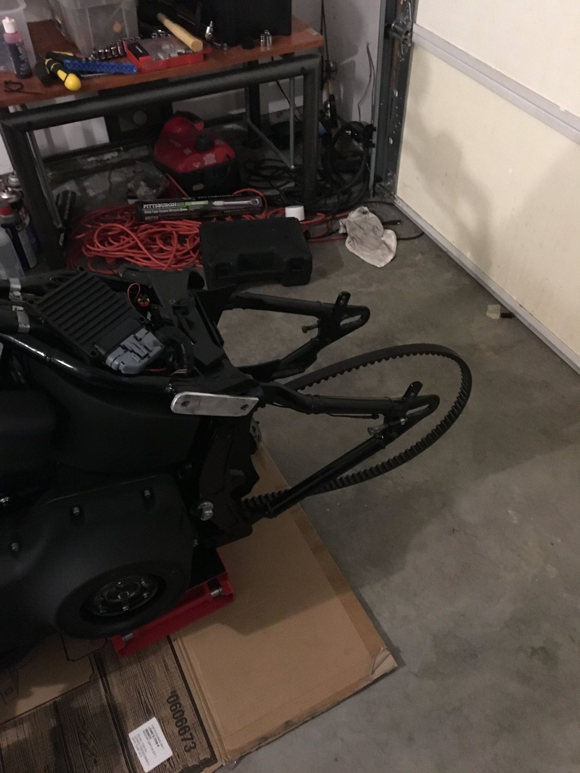

For the struts I would just space out your factory struts so you can center your fender over the tire. Blackspa used washers and I measured mine and made spacing plates out of aluminum. My bike is lowered about 1.5 inches in the back
Here is the aluminum spacer I made

You will need the 9 inch wide for 200 tire. Others have used the 8.5 but it is tight fit. The only thing you need for the swap is the wheel, tire, fender, rock guard, and a way to space out your struts. You will need to cut a little out of the inside of your seat to get it to sit flat against the fender.
