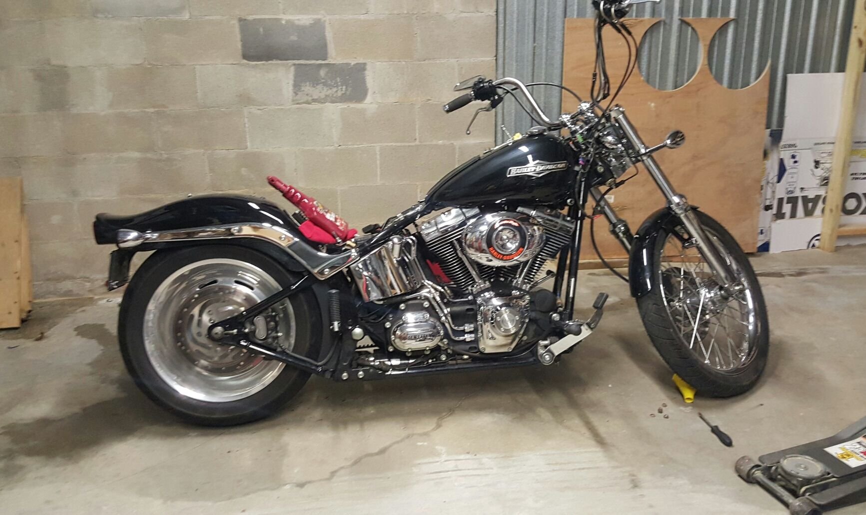

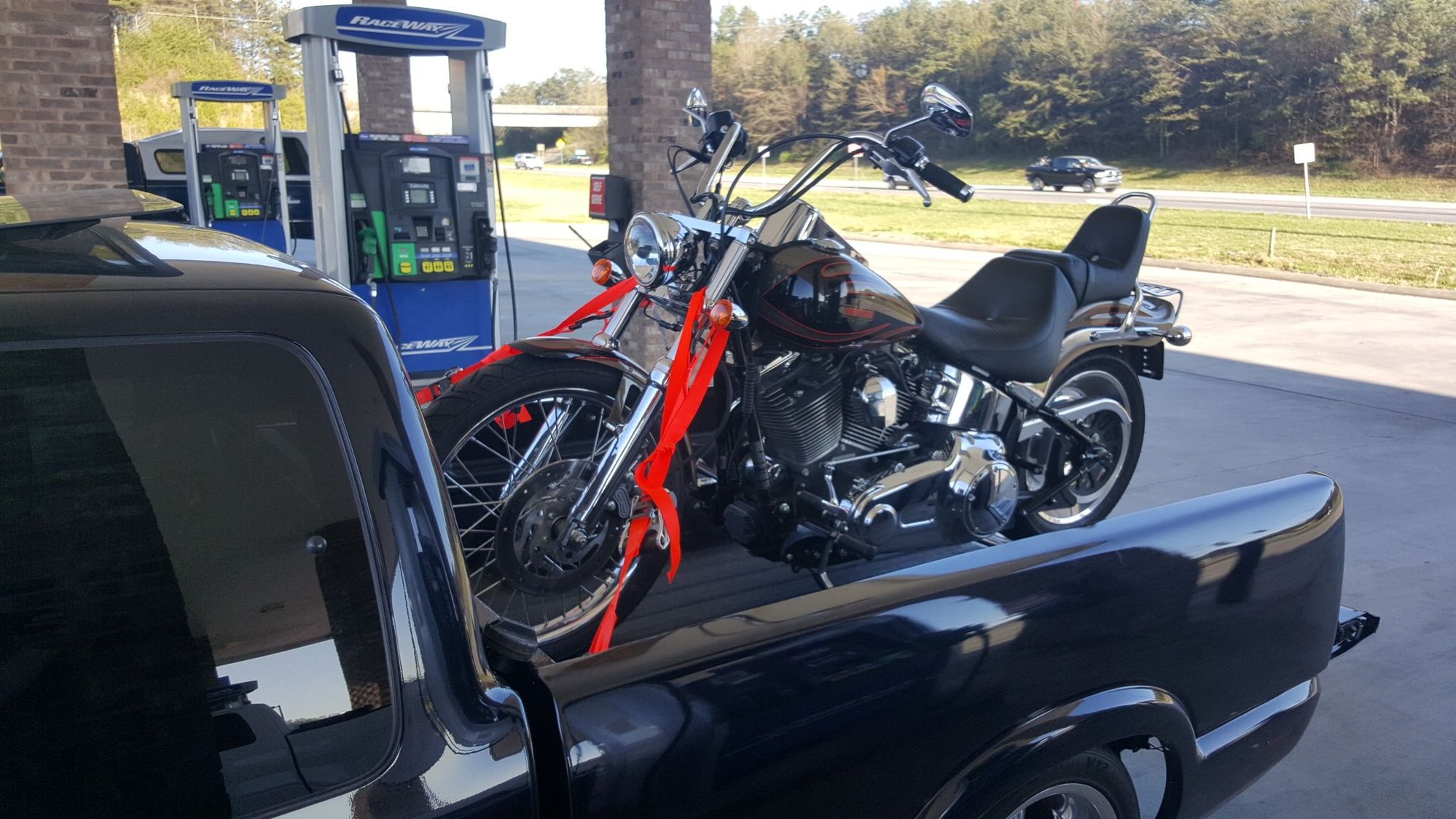

On her way home
Day 1
In the next 48 hours, she looked like this
new tins, shotgun air, -2 tubes,racetech springs, gold emulators installed.
that's all I did for my first step of mods, and this is where the winter project plans started.

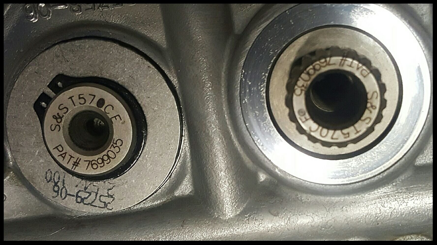

• s&s 570ce cams

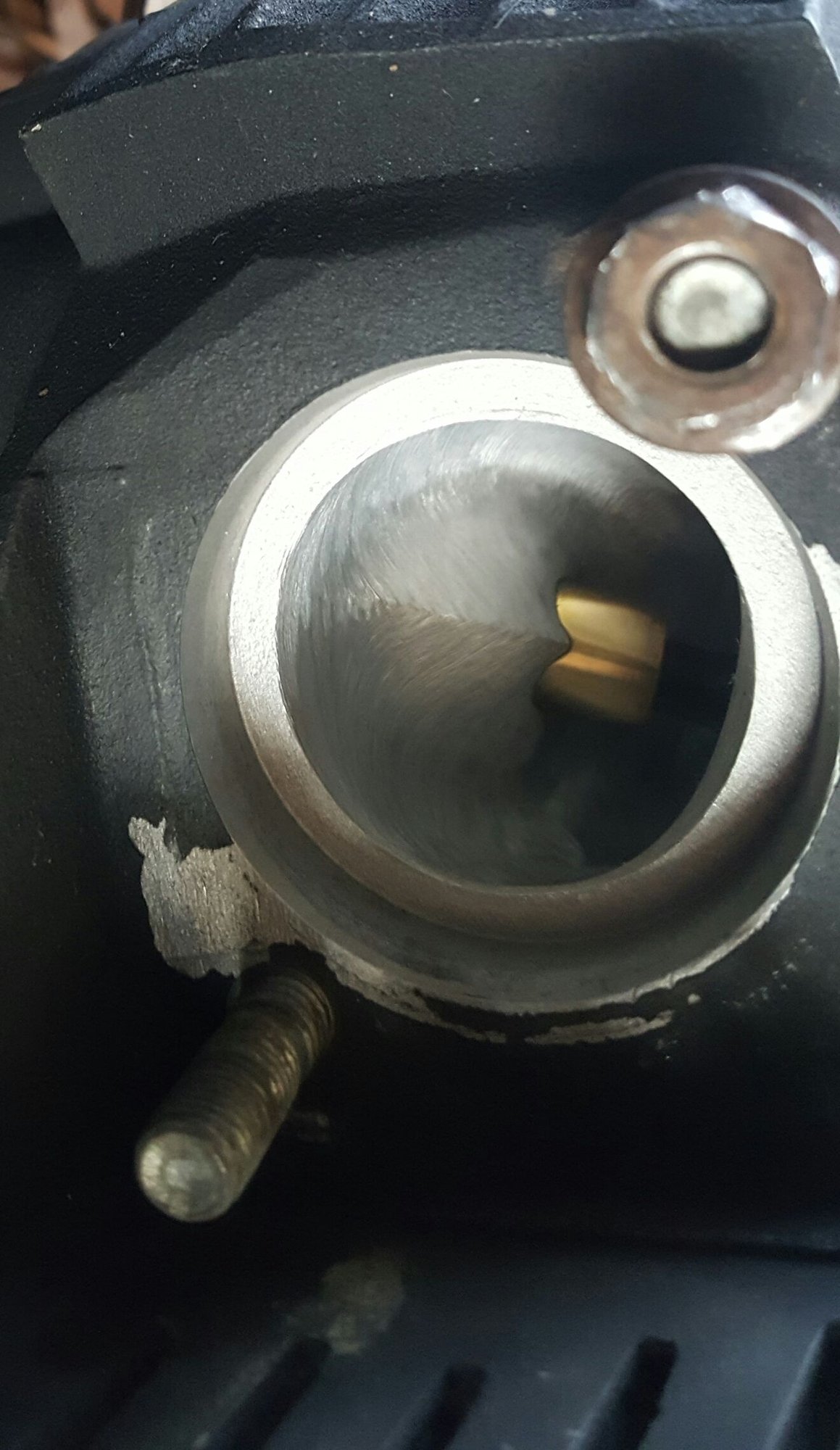

• Bored intake

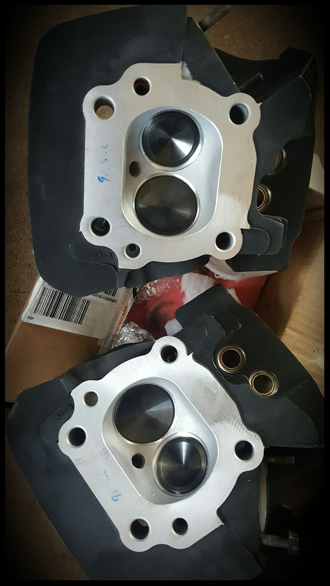

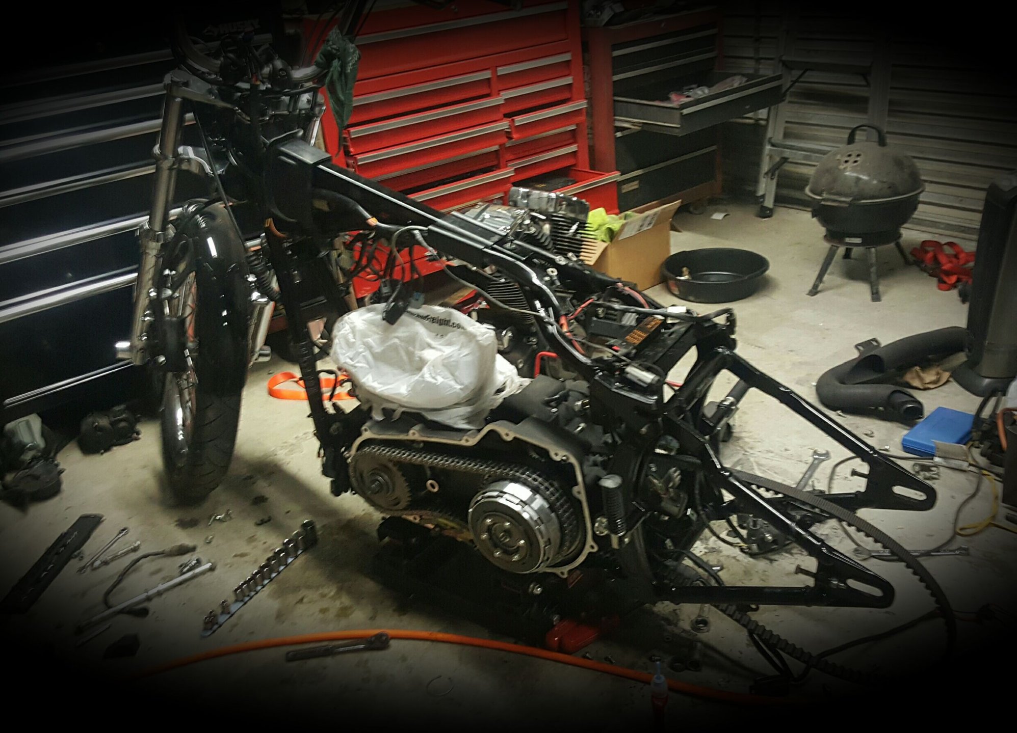

Sent heads/jugs/intake to hillside cycle to do all my machine work.
Started disassembly of her day after thanksgiving 2016
Old cams out Head work
Cam plate
Cams/plate Installed

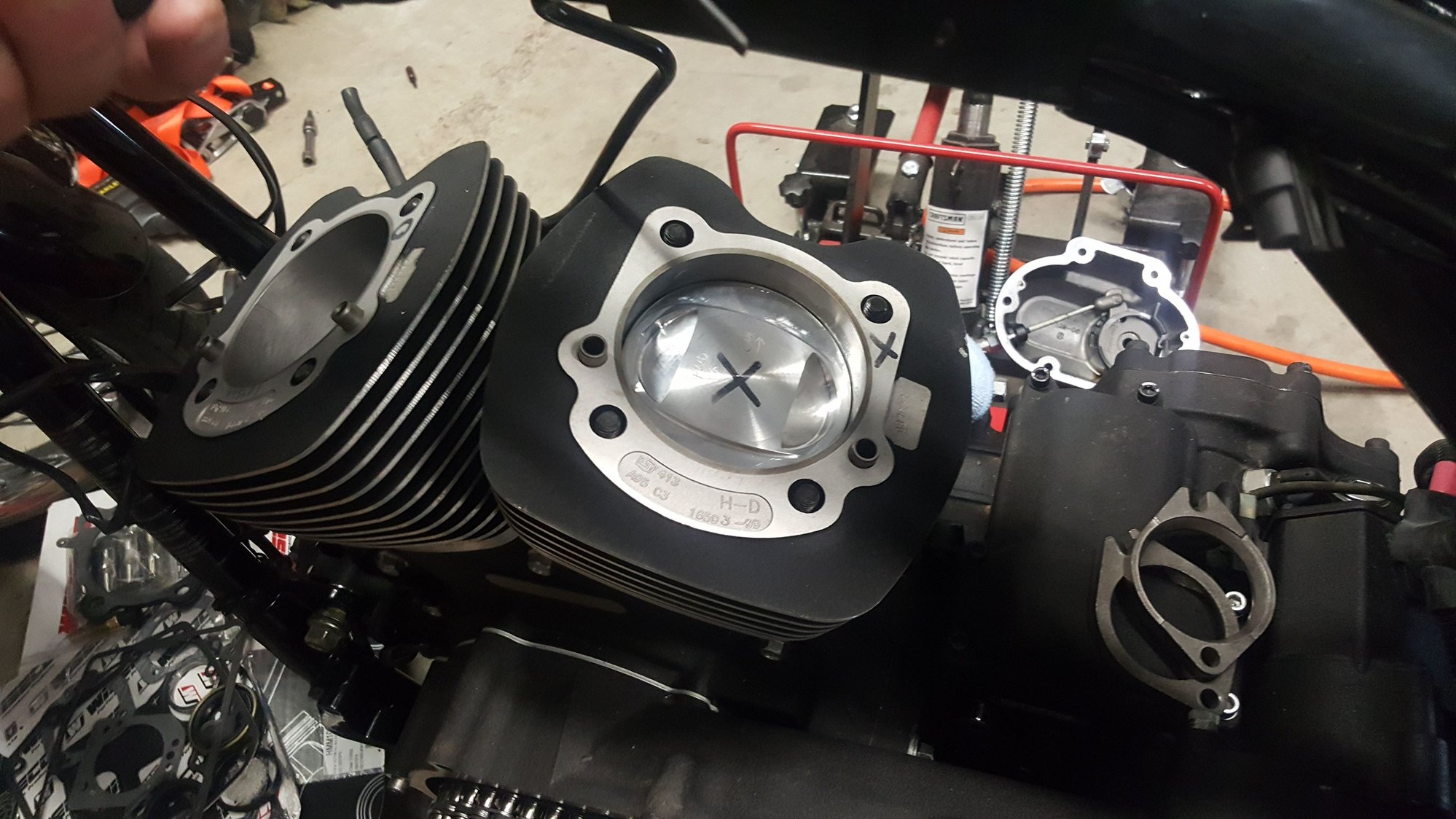

Cams Jugs/pistons installed

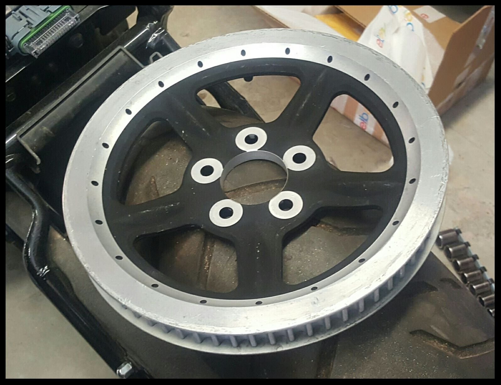

Decided to swap final drive pulleys while I was in the primary, so I swapped from a 32t/66t to a 31t/68t... also got the yellow SE clutch spring.
Sporty 68 tooth Pulley

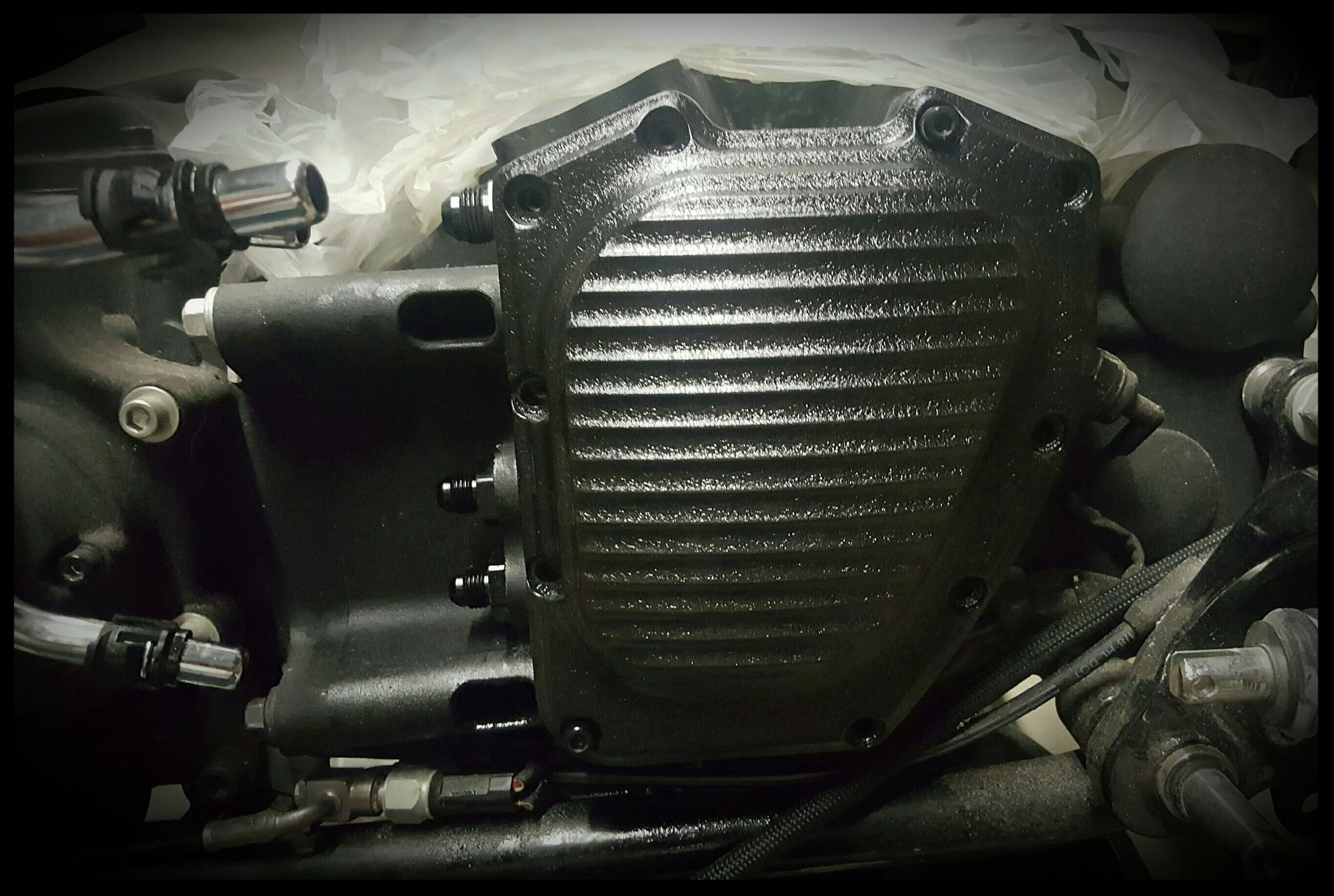

New cam cover

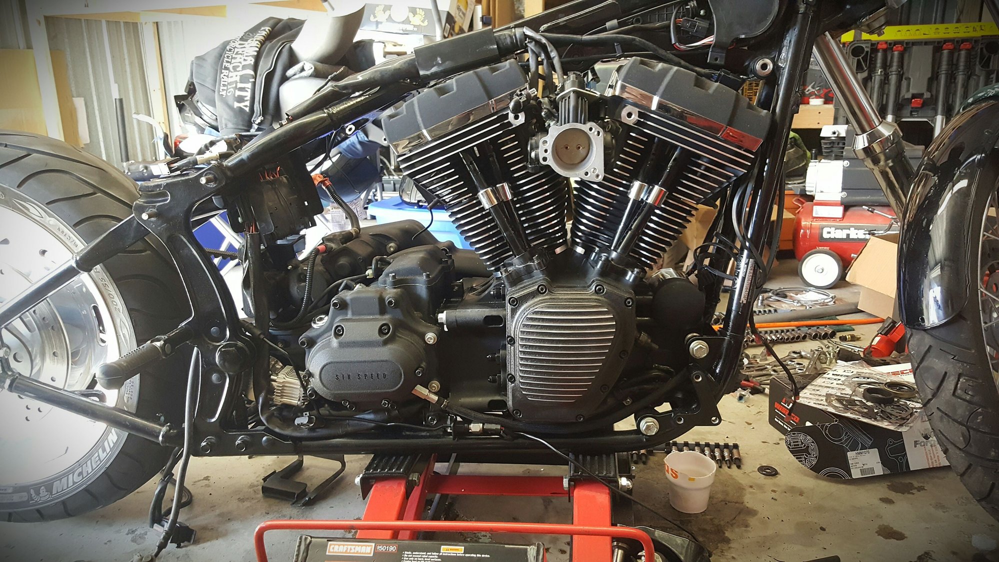

Engine almost completed

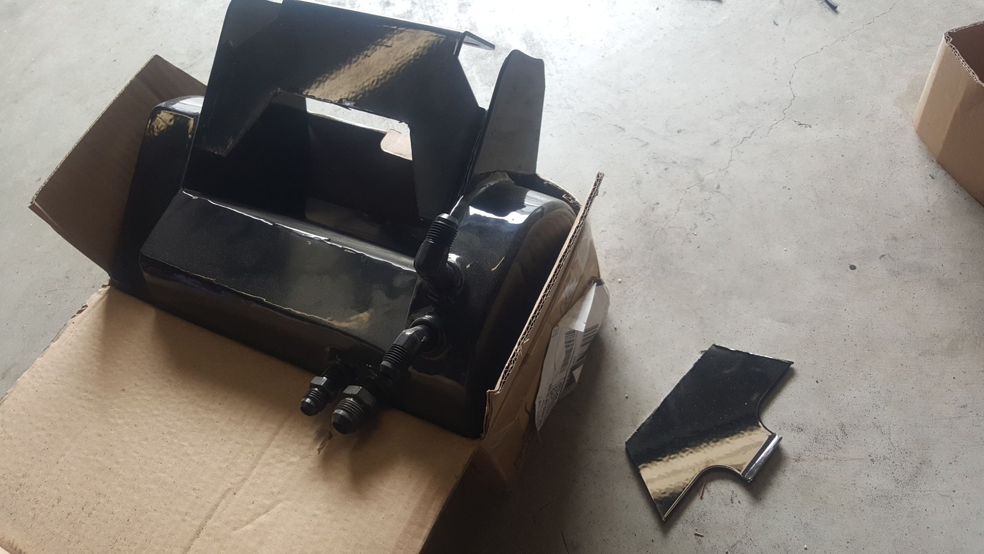

got a round oil tank
Had it powder coated and cut small area from bottom to fit

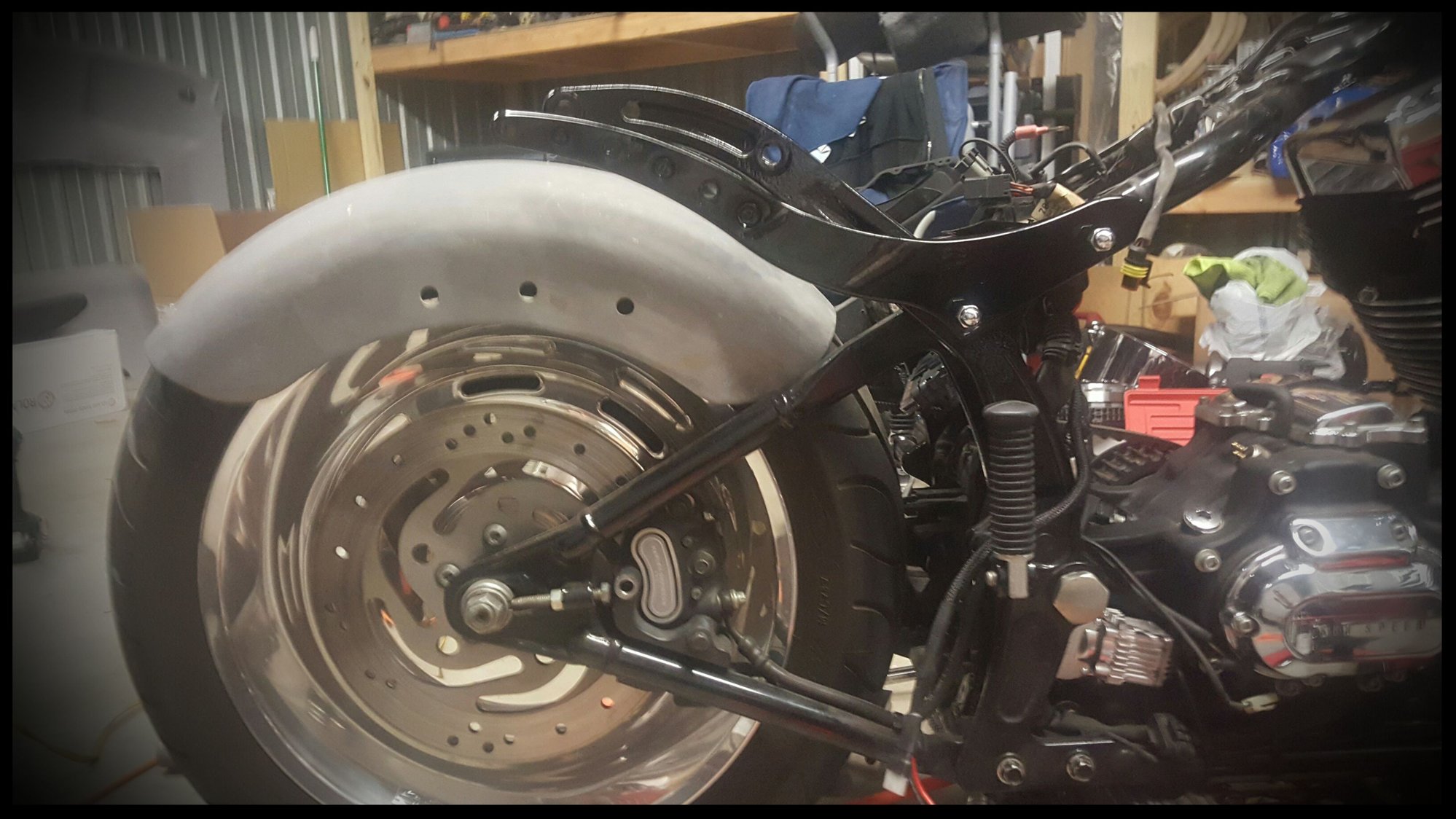

ran across a deal on a RSD tracker fender and struts.
Difference between the two struts Cut frame horns off

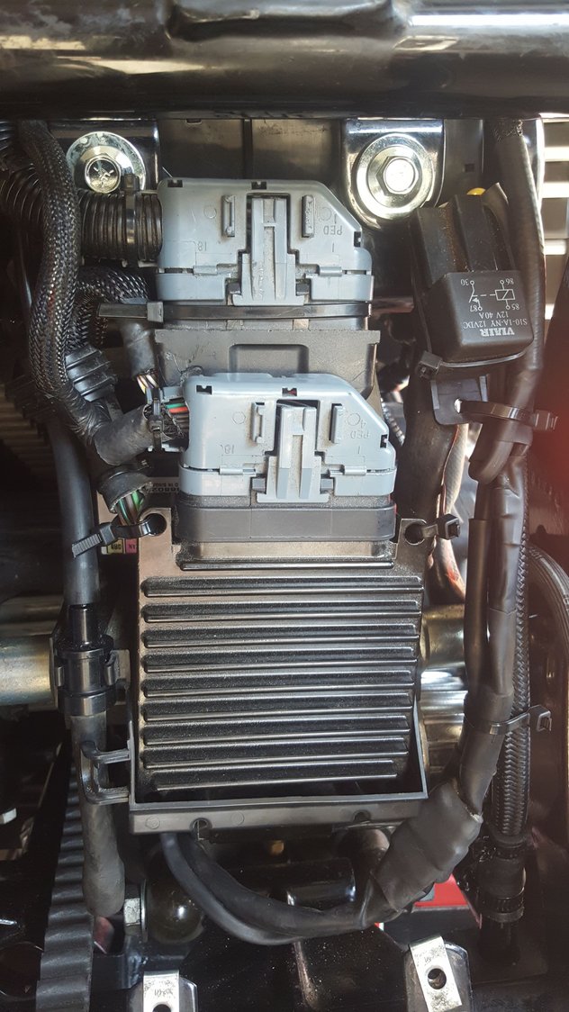

Relocated ecm behind mud flap
Ecm relocated

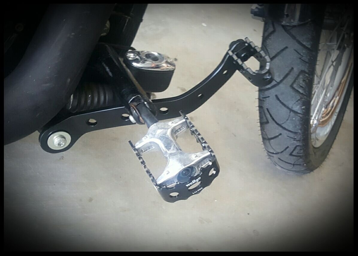

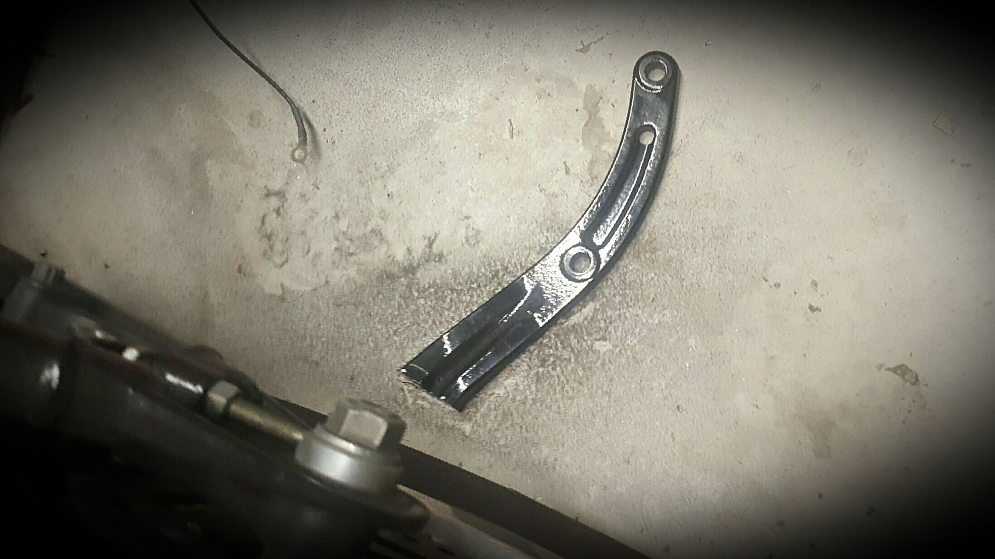

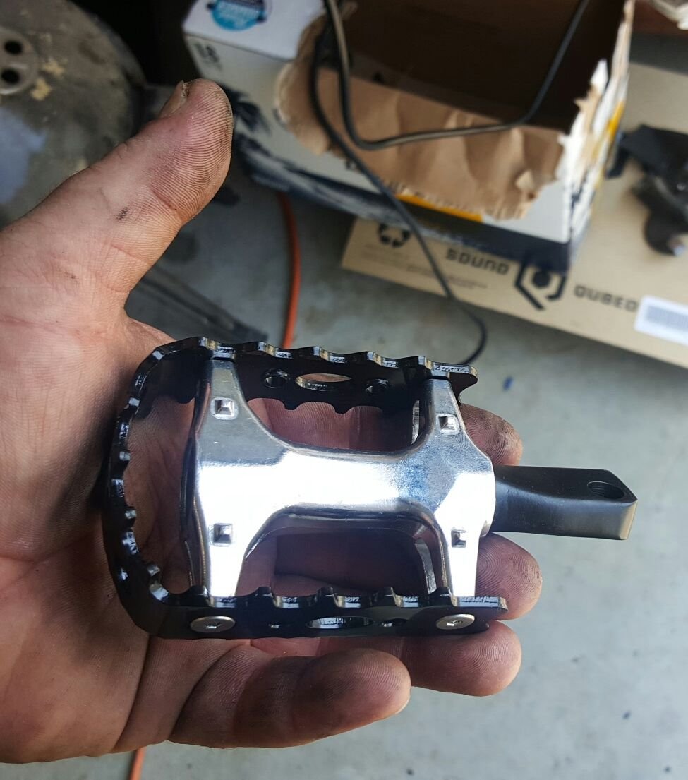

decided to modify rear brake arm and add new foot pegs
Stock Reshaped Done, mild difference but i dig it
New pegs

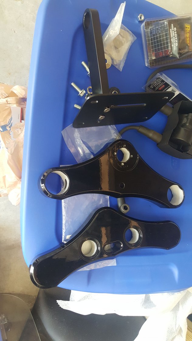

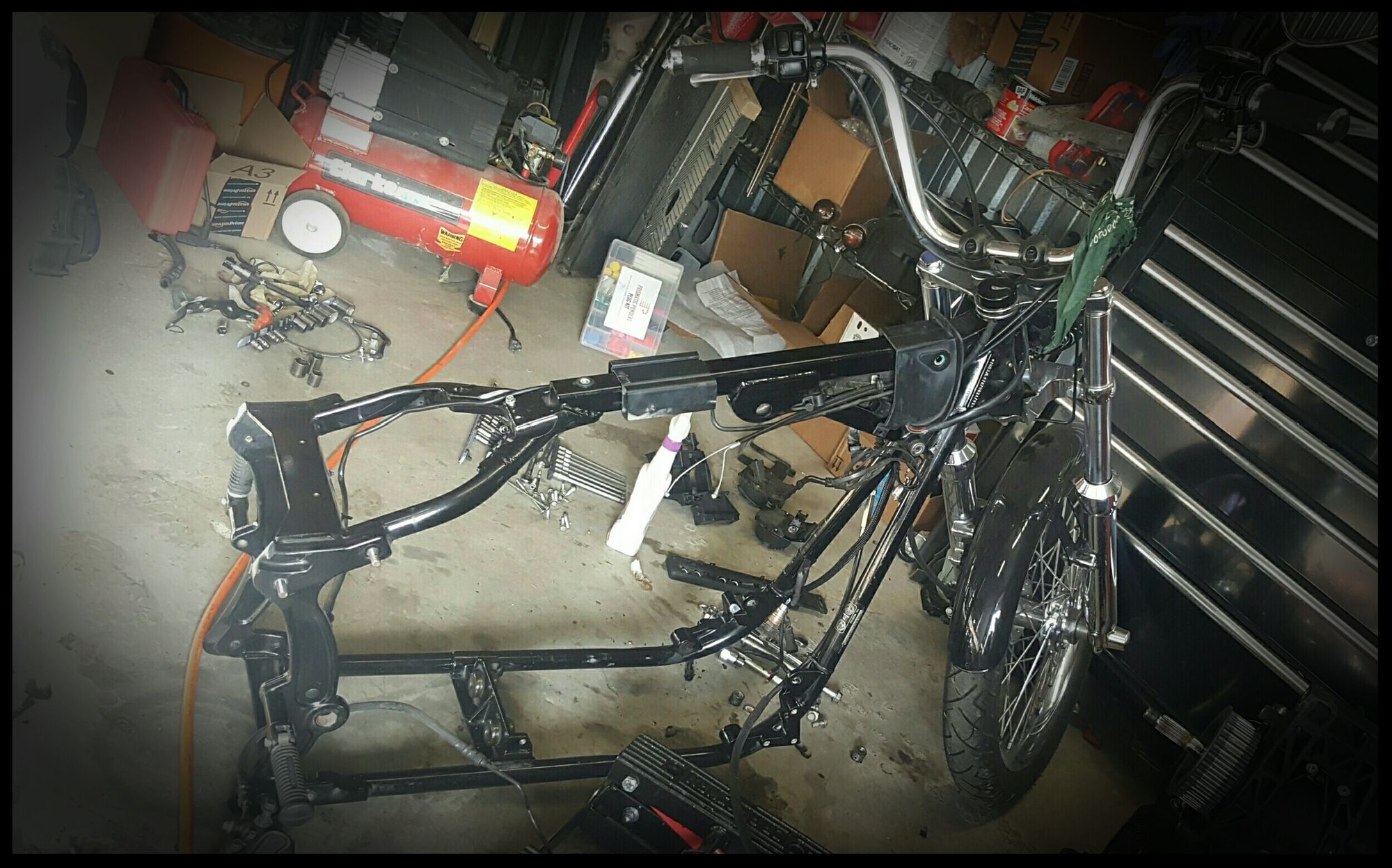

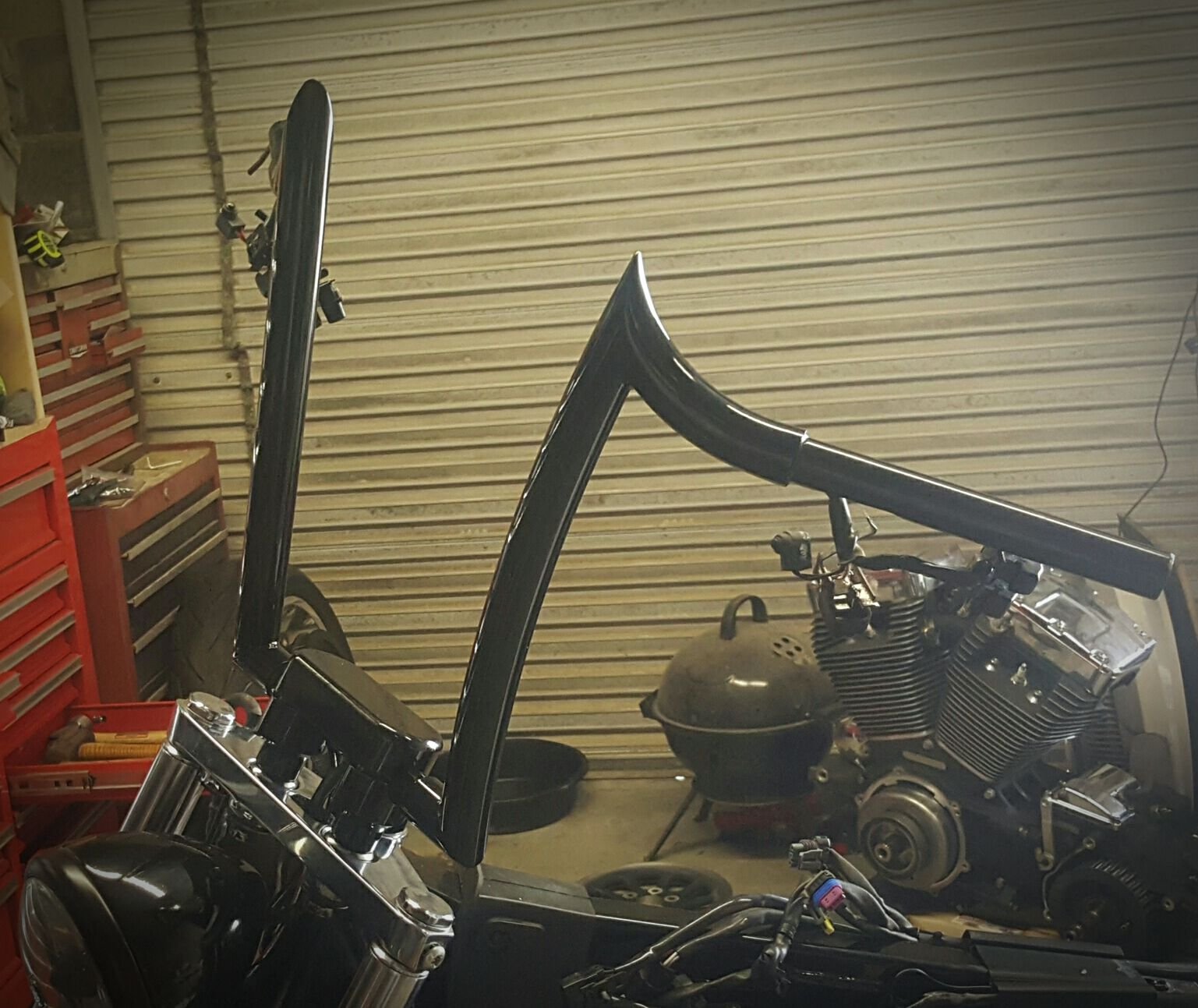

Then my quest for apes began.
Much better That led to triple trees, see a patern yet?

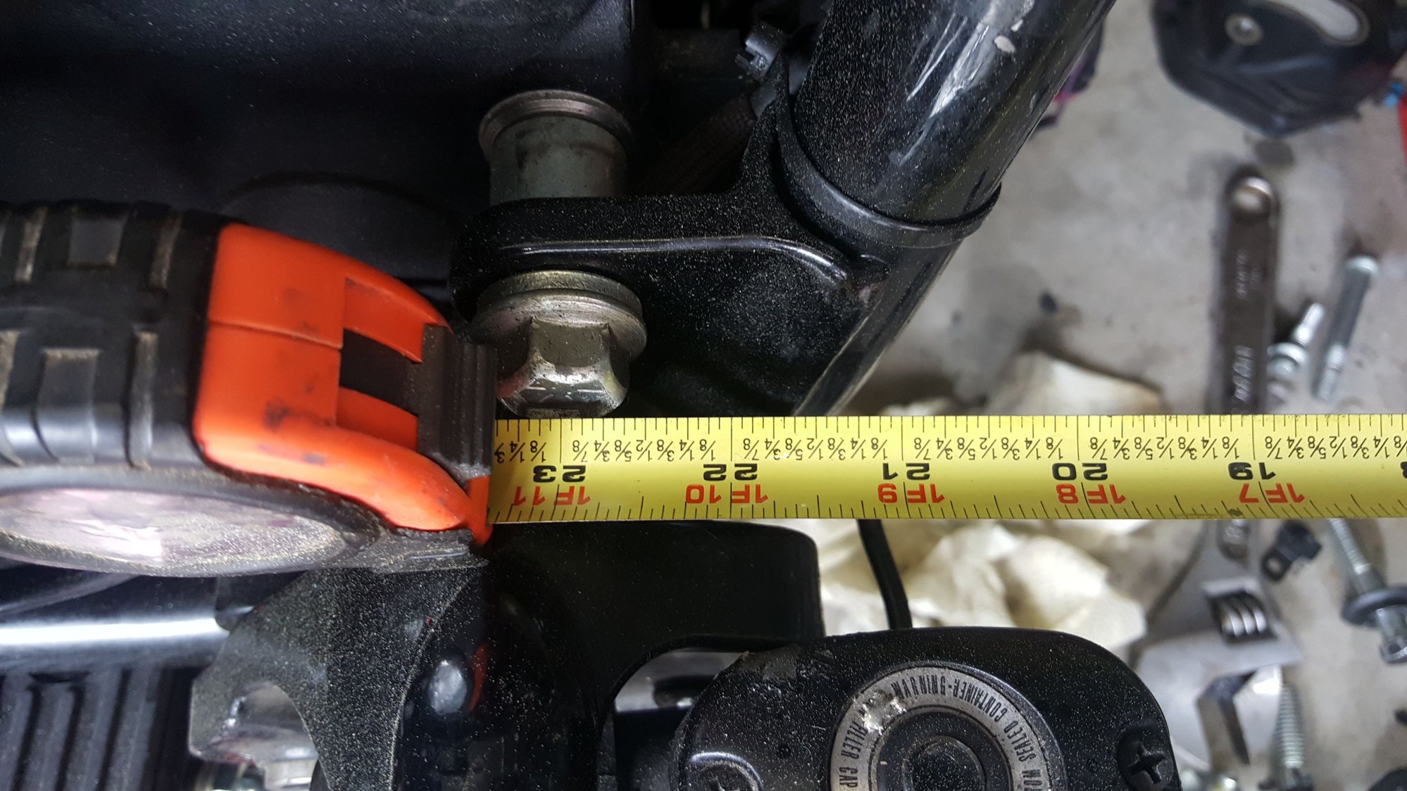

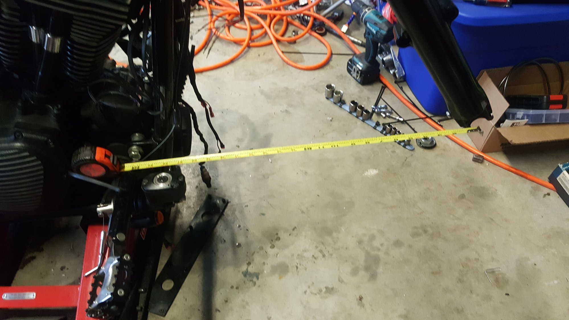

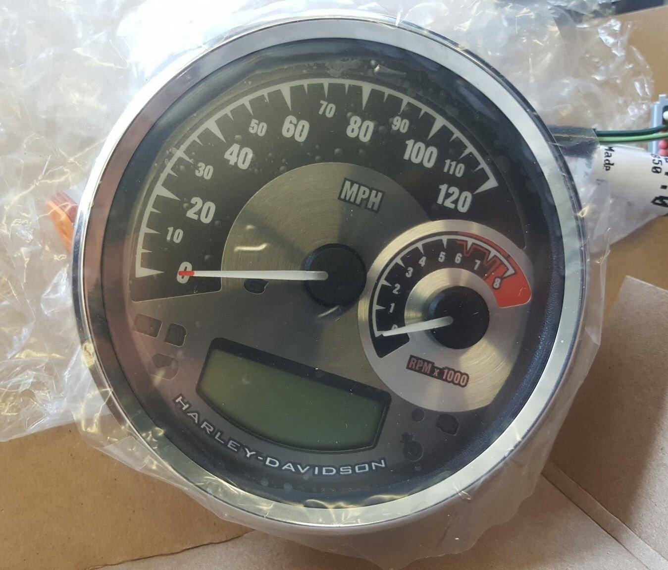

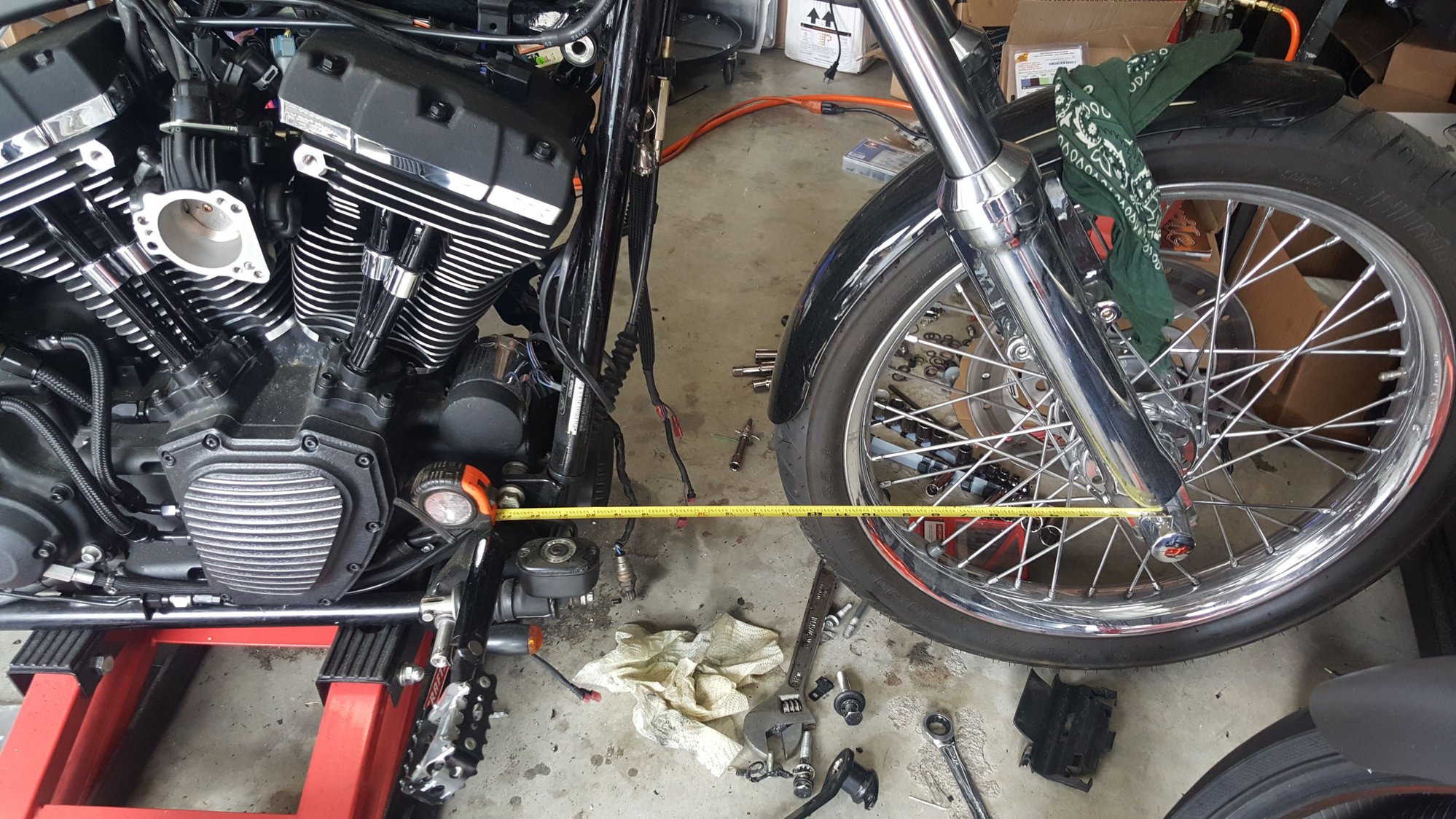

HHI 5° slade triple trees powder coated That led to new risers, LED headlight and black lowers

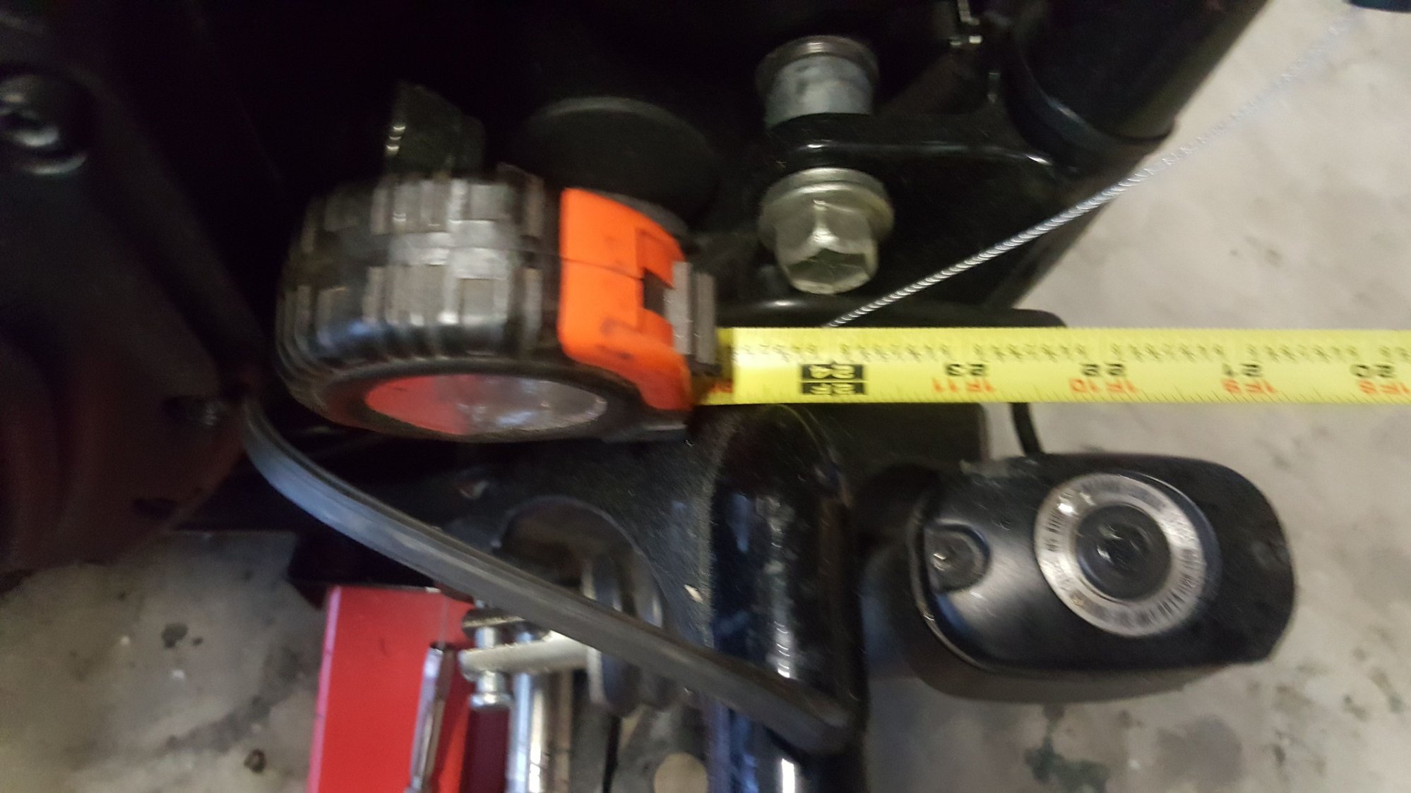

Powder coated lowers New spedo with tach Stock trees measuring Stock triple trees
5° triple trees measuring
Only an inch difference at axle center?

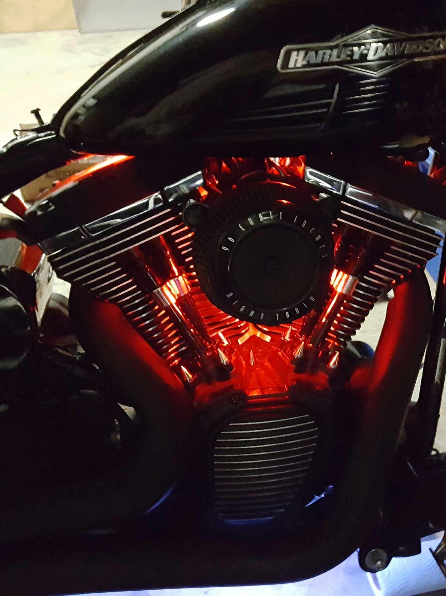

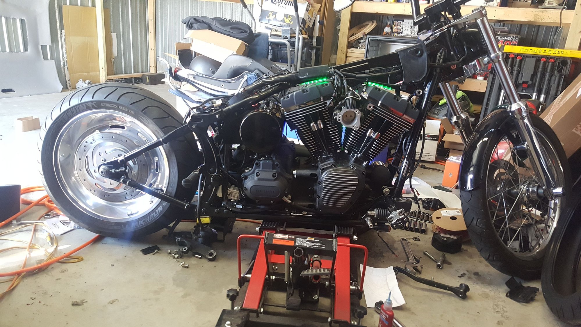

While I had bike stripped to frame I installed LED accent lights.
I've never been a fan of em, to blingy/etc.
but I figured if I did it my way and in moderation, my black bike could benefit from the cokor
What ya think?

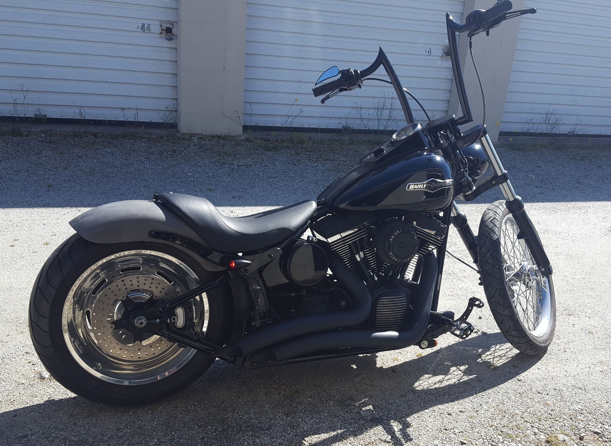

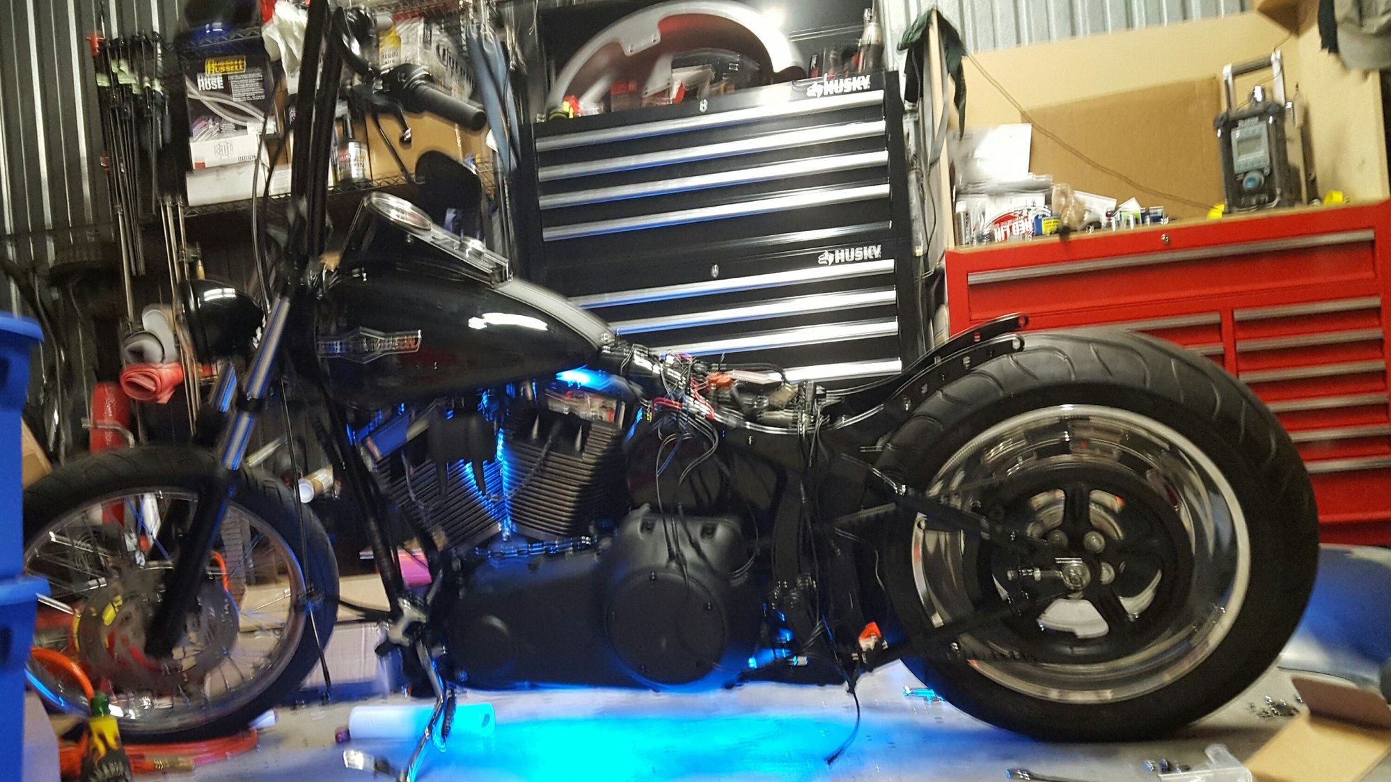

finally got her off the jack for the first time since thanksgiving weekend and rolled her outside
Got to put some miles on her before dyno tune.
and still a couple things left to finish.
but for now that's where she is
stay tuned though...

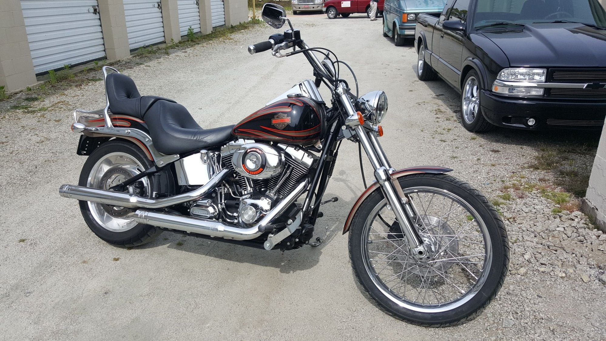

Great job man. Can I send you my 2008 FXSTC?
Seriously though, great job. I would like to learn how to do performance upgrades my 96" one day.
Here's mine

that's some nice work there....I was thinking about doing that to my brake leaver but I'm not patient enough to get good spacing like that!
