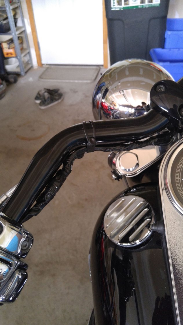

i had to go external.. the previous owner cut and joined the wires from the bottom of the handlebars.
So I would have added to run all new wires.

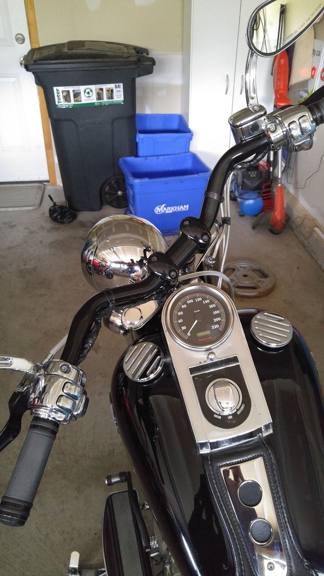

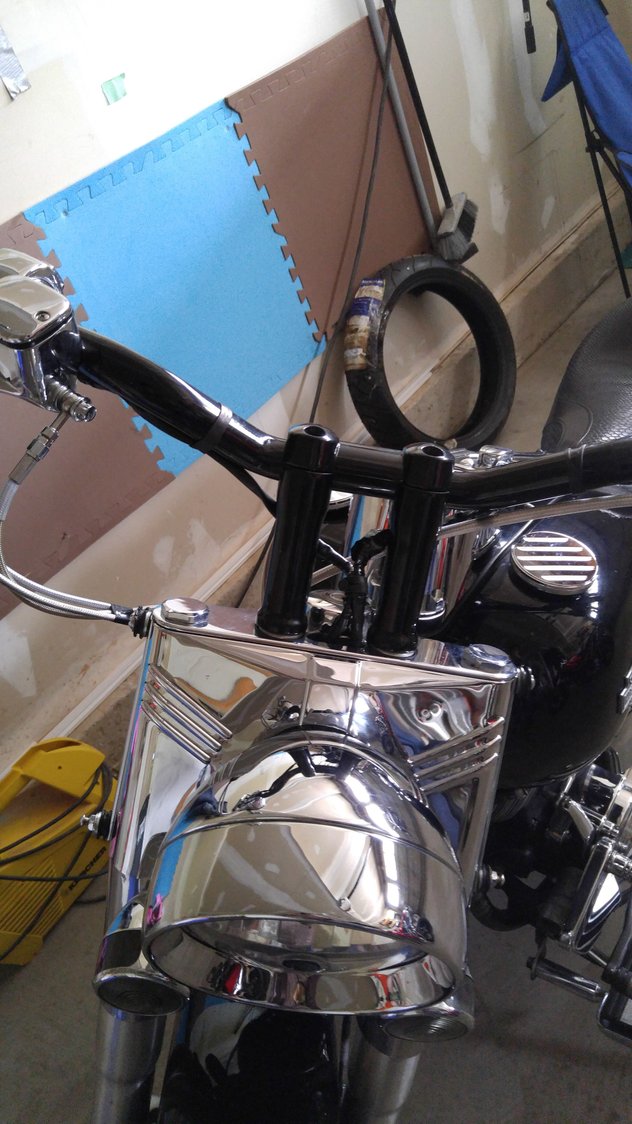

So I cut and soldered back on from under the handlebar. I am not skilled enough to do when whole wire harness removal and rewire job in one afternoon and I wanted to keep my bike on the road for work today.
Yes it's not as nice and clean as before
Here is the end result
