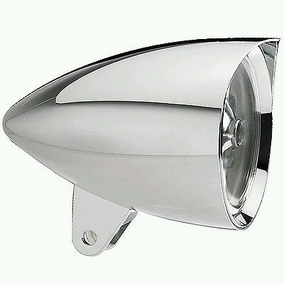

Thanks for compliment!,
But I just bought,& Received yesterday the Headwinds Vampire....pretty high up I think!
sorry just looked there the LEDS, they look like a lot, as it is I get flashed high beams all the time, THESE ARE SWEET THANKS FOR HOOKUP, LOOKING UP MODEL FOR MY BIKE RIGHT NOW , LOL THANKS BUD!!!
https://www.headwinds.com/mm5/mercha...Category_Code=
anyway heres a pic to remember my old bike by, decided to take trees off, doing some mods to them, than powder coating blue, also the bucket that holds speedo, to the garage again, parts OFF , parts ON!. lol
memories!!
vampire smooth concours chrome.. 5 3/4'

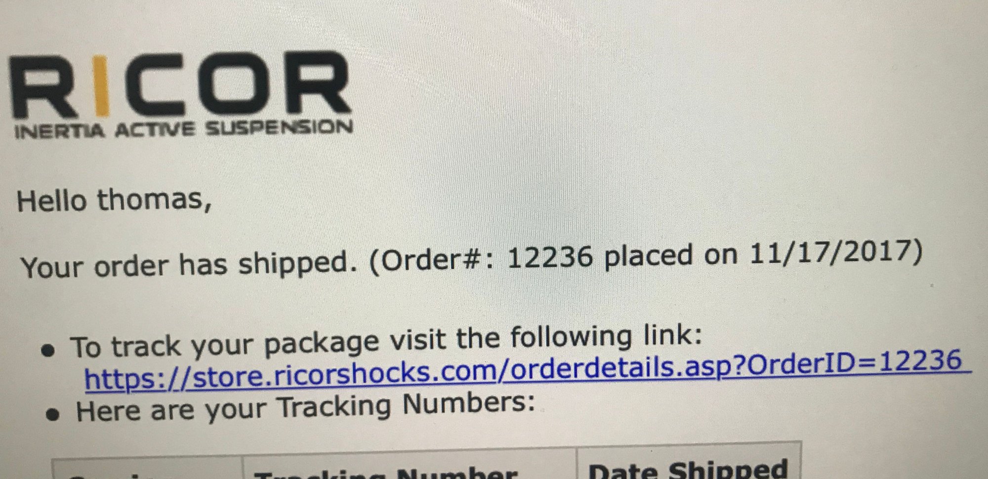

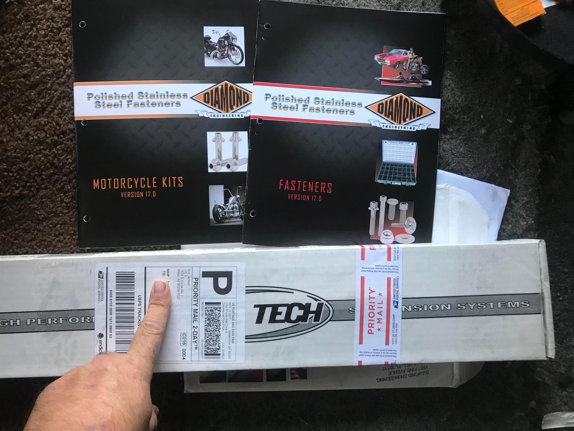

nothing exciting a snap on torque set, my race tech springs with go with the Ricor Intimidators,,,days not over, every day 2-5 packages arrive...
im background is diamond engineerings catalogs, I bought alot off them lately changing ALL hardware to chrome 12-point...so they sent catalogs lol,they make lots more, if you thought grade 8 was the cows MEOW, go on there site not cheap, but look at the comparison to grade 8 hardware and how its manufactured, exp, my pulley has slightly larger washers for the 12-point to sit nice in a rounded washer, SWEET LOOK, he's trimming that hardware for me 2$ a bolt, worth every penny

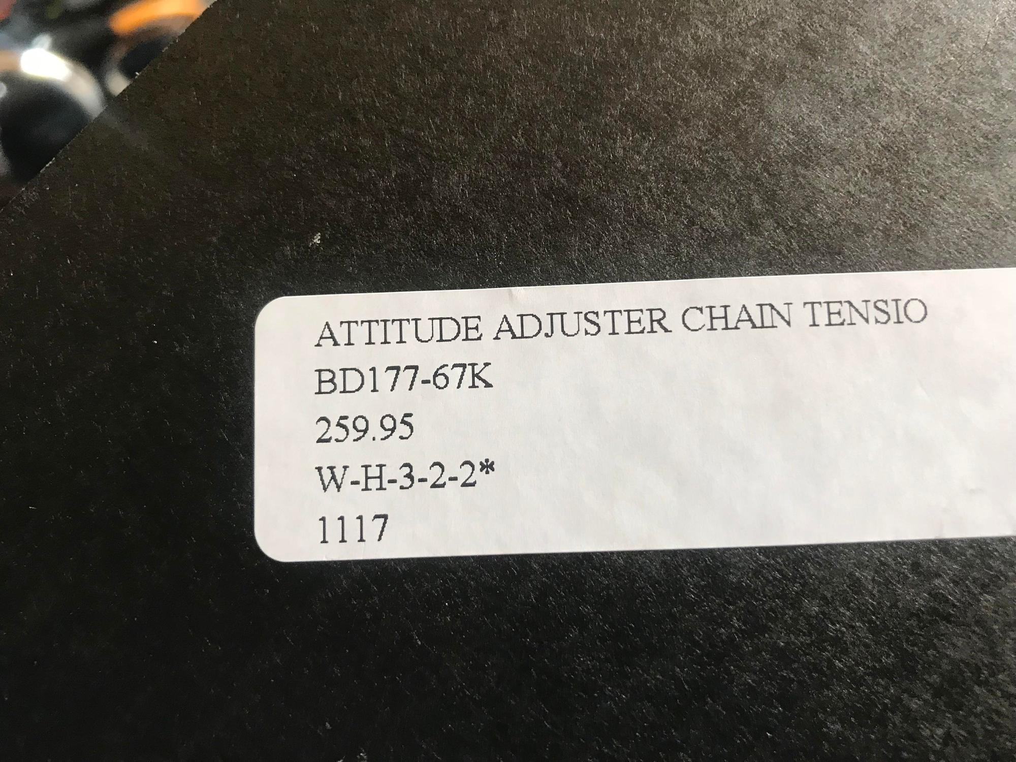

The Works, are supposed to be the cats meow, next to air ride, if your looking to go air, message the guy who's helped me tremendously, almost daily,ROCKER B, he's built a sick *** Rocker C, AND A Breakout, which won First Place in a contest, he's the guy to talk to on air, I haven't a clue! Speaking on orders, Actually my Baker Armored Attitude Adjuster just came in the new style, if anyone has the old style, they do make a conversion kit, so you don't have to spend all that money, this was 2 1/2 times more than the Hayden unit, but I've heard bad things about the Hayden, Being I have the Baker Compensator coming in behind this, as well as the "Street Door" its the cover behind the 5 screw trans cover, 25% larger bearings, my point of view, BAKER IS KING,!

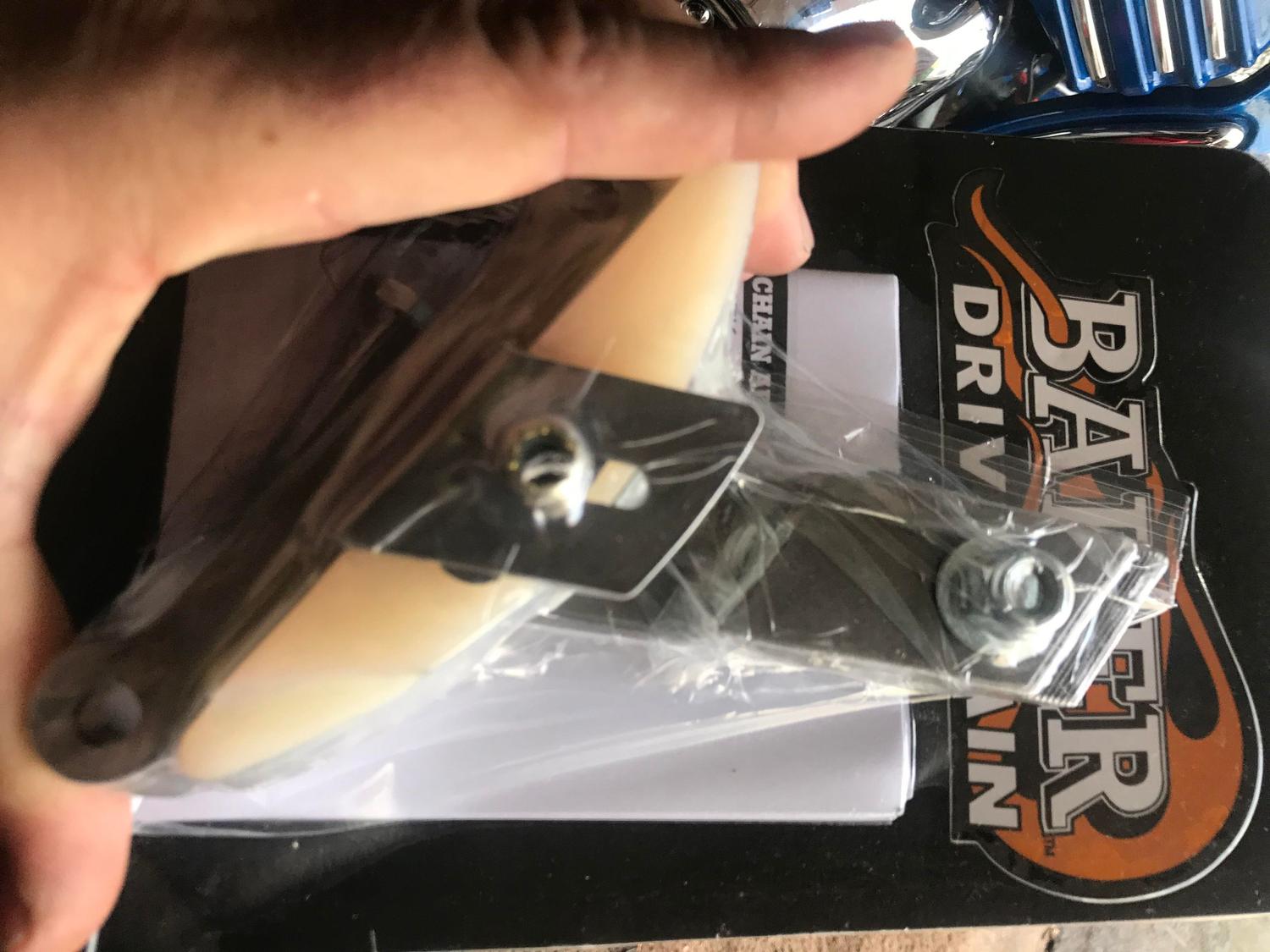

NICE SETUP!!
parts big, the shoe is huge!!! and theres lil oil passage, to oil chain as it glides over
A WELL KNOWN PROBLEM WITH HARLEYS ADJUSTABLE PRIMARY CHAIN TENSIONER, IT KEEP CLICKING TIGHTER, AND THE PRESSURE IT PUT ON THE BEARINGS, SIDE TORSION, DESTROYS THEM, IF YOU HAVE A HARLEY 07" AND UP YOU NEED TO CHANGE, THIS IS THE BEST YOU CAN BUY, THERE IS A HAYDEN M6 FOR LIKE 125, BUT I READ A BAD REVIEW HERE N THERE, NOT MANY,BUT 2 OR SO IT TO MANY FOR ME, EVEN THE ONE THIS REPLACED HAD AWESOME REVIEWS, THIS HAS MORE LEVER UPGRADE, OIL PASSAGE UPGRADE, AND THE SHOE IS LARGER I BELIEVE I WAS TOLD..

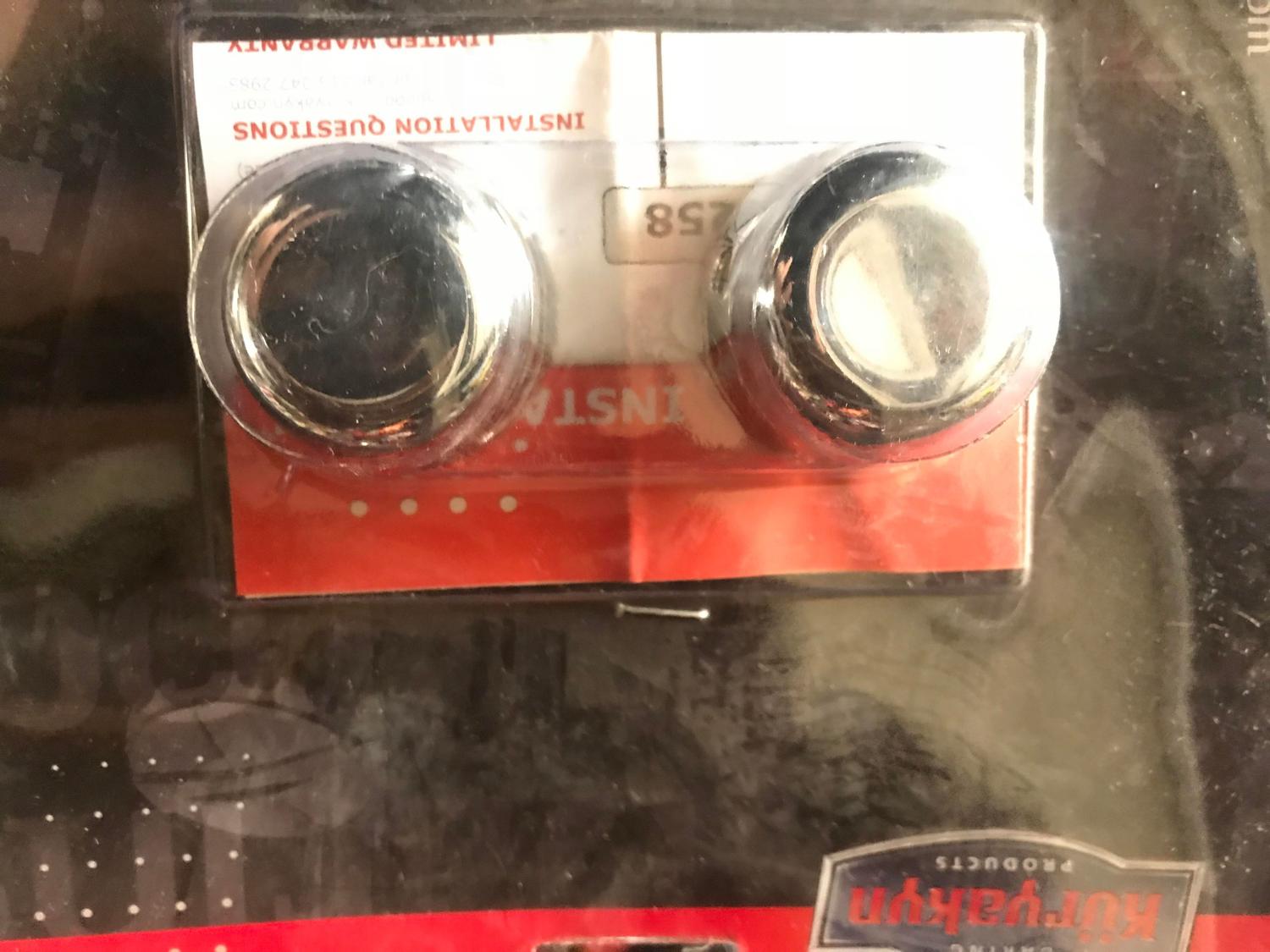

also forgot these, I have alot of little stuff like this that I don't always post up, but why not? other rocker owners can see there this and that available
and naturally these metal chrome caps cover these, they been bothering me, was gonna get these REALLY NICE SPIKES, but than, I thought I get off the wrong way, they would rip into my leg!!! so I opt to get a simple nice cap.

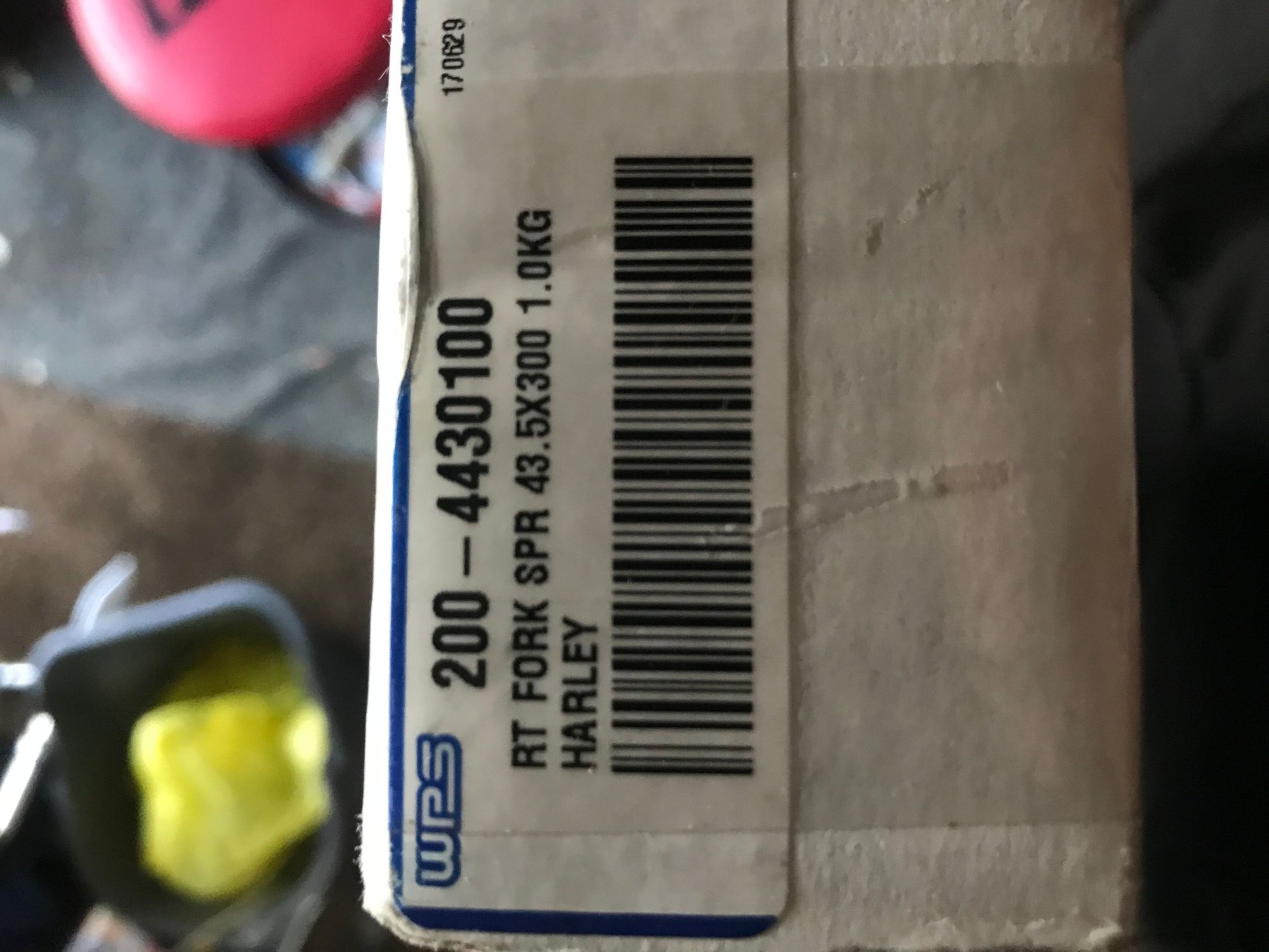

there coming.,..,.,lol.,,..,springs are lonely...haha
wasn't bad at alll, with oil, 250ish ? shipped?

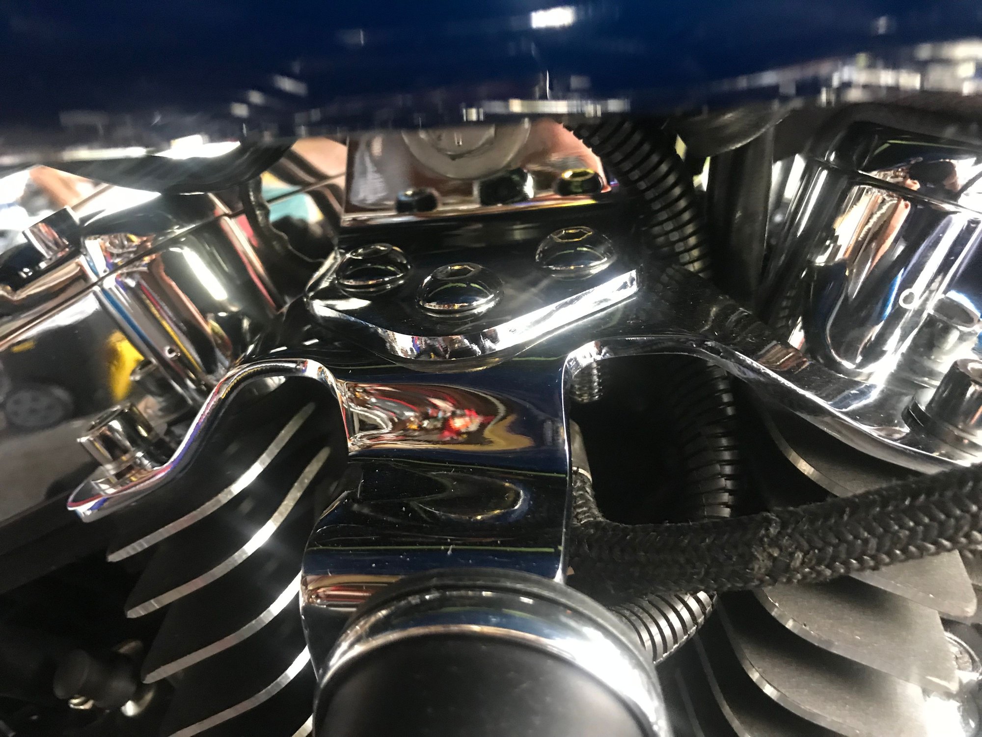

This is for Mr Rocker B.
best pic of chrome mount I can get without all the BLING, and I just found where I can use some more of my chrome wire loom!! sweet! lol

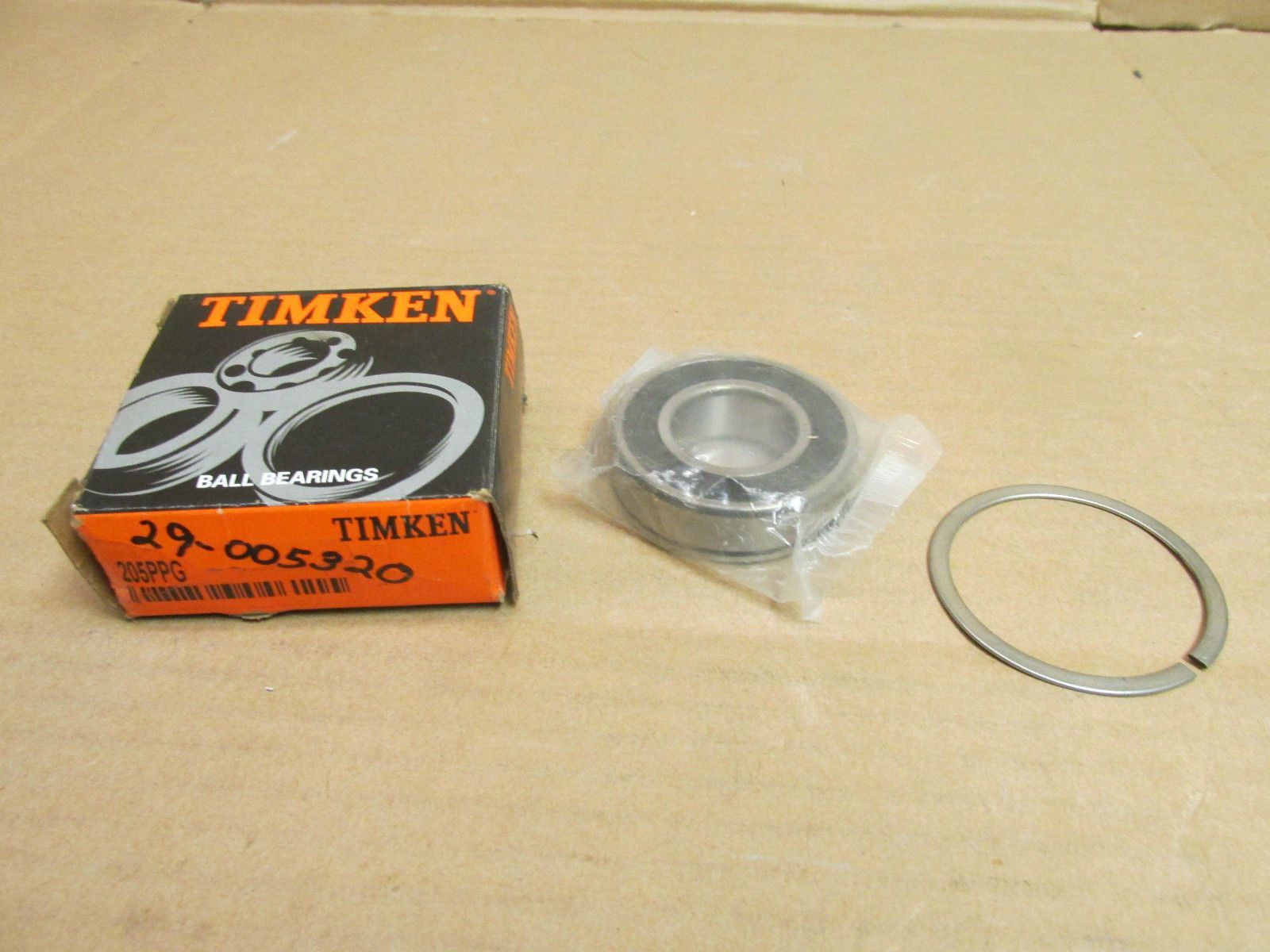

I want you ALL to be safe out there, so when I dig up stuff like this , I spread the love, here is one of many, and these are the bearings I bought you'll need 4, and you'll need the spacer in between to be machine down, as the China bearings Harley been using since 2008 are thin, and the spacer "Pushes" the face of the china bearing to be flush with outside of hub, well these DOUBLE ROW TIMKEN'S, FIT PERFECTLY INSIDE YOUR WHEEL HUB HOLES, BUT IF YOU DON'T MACHINE SPACERS THEY WILL STICK OUT, IF YOU SEE THE LINE IN BEARING IN PIC, THATS ABOUT HOW MUCH THICKER THEY ARE PER SIDE, I HELD THE 2 IN MY HAND, I COULDN'T BELIEVE IT!!, THERE ARE CHEAPER BEARINGS, THAT WILL BE JUST FINE, JUST *****, Lots of others, heres a link to others discussing, you should do your due diligence, and research on this, as its your LIFE!!
https://www.hdforums.com/forum/softa...-rocker-2.html
I think I paid around $25 a piece, again, you can get good bearings for 25 a set!!!, I just figure, I do something I do 110%, thats Marine Mentality!!! If anyone want to know where to buy etc, lmk I can probably get cheaper, as I deal with a Timken Distributor directly, I have Neck Bearings On there way, Inner Primary Cover Bearing, In Bakers "Street Door" I'm placing Timken's in there, I am most defiantly, to the XTREME, and let it be known, you don't have to go to the lengths I go to, maybe your marriage, will be better than mine if you don't follow my path, lol, DEAD SERIOS THO.....Between this and the new Vet , Its Getting CRAZY Round here......
