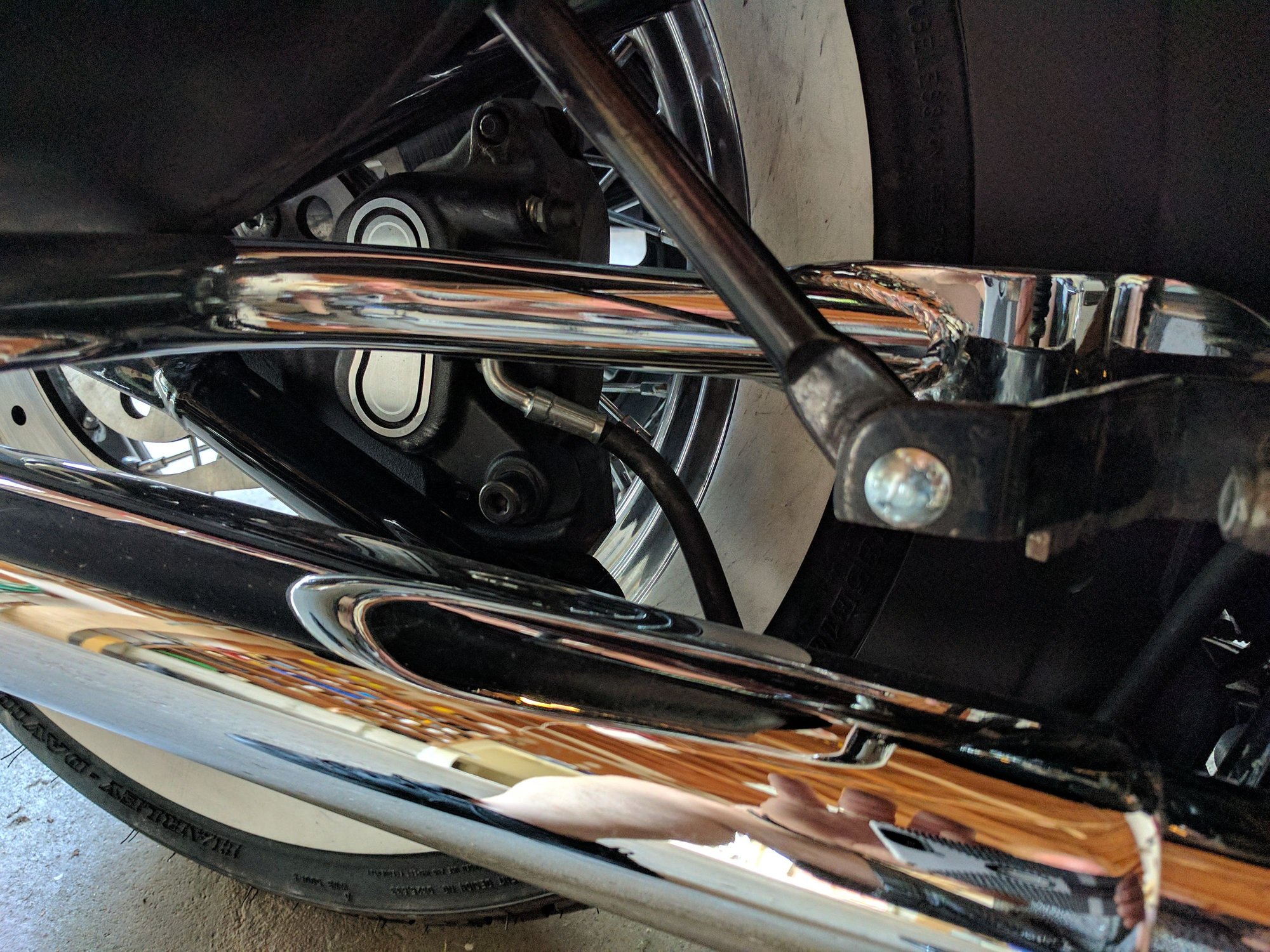

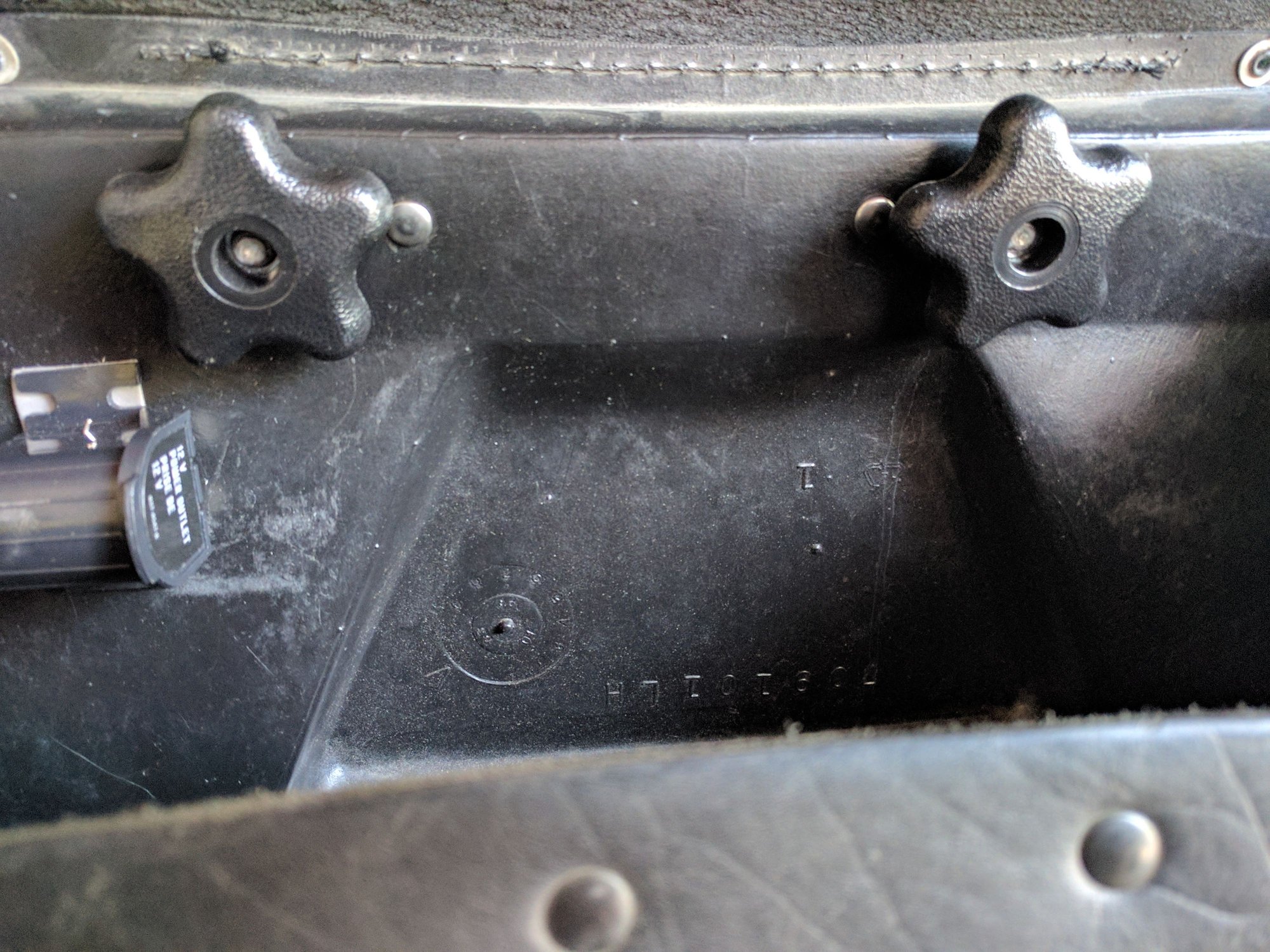

I went to my local dealer to price out quick detach kit for my Heritage bags...$350! WTF??!! How many can they possibly sell at that price??
So, I went to Home Depot and picked up 2" thumb wheel, carriage bolts and lock washers/nuts. For less than $30, it works great. When I remove the bags, I add chrome acorn nuts to the saddlebag spacers for a finished look.
