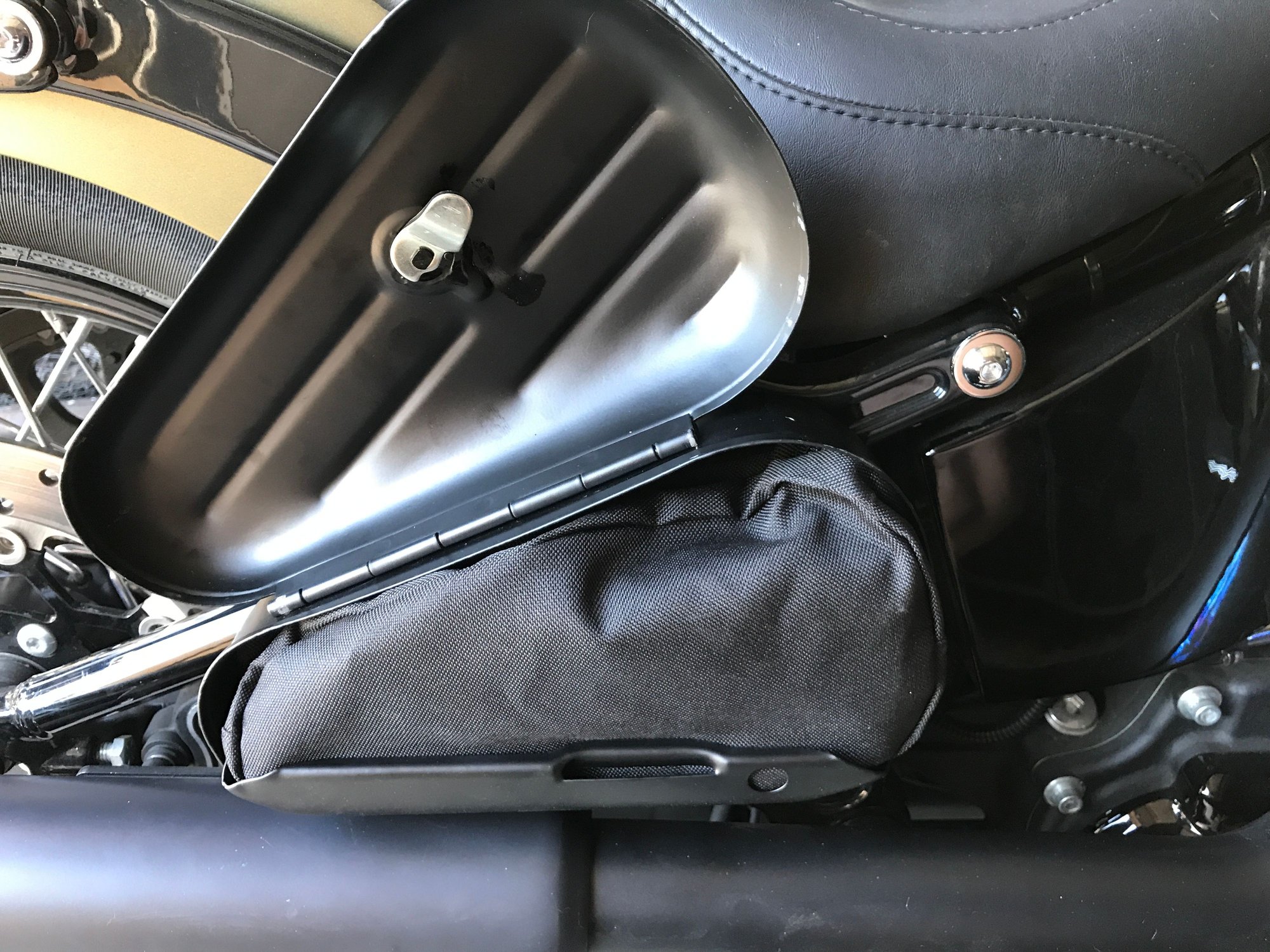

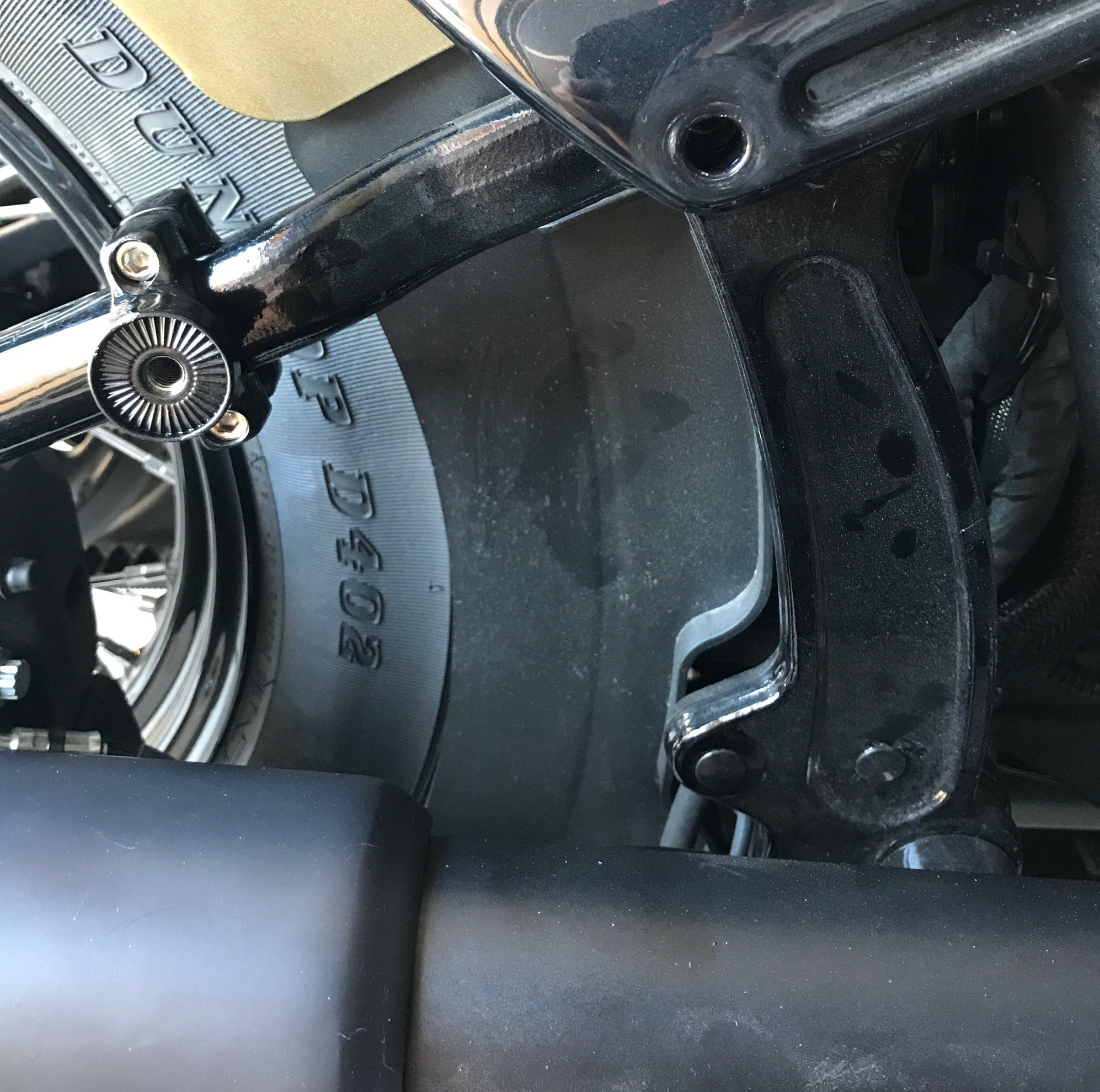

Here is an easy way to install toolbox on the right side
1. Purchased Black toolbox from J&P Cycles
2. Purchased Black Kurayakn license plate mount clamp (3116)
3. Purchased 5/16 1inch stainless steel button head
- 3/8 1 3/4 stainless button head for toolbox
- (2) 1/4 3/4inch button head for clamp
Old Jul 1, 2017 | 11:15 PM

Looks to me like you've mounted the box to both the swingarm and the frame/fender support. Exactly how does that work? How about a picture of the inside of the box showing how it's mounted.
Old Jul 2, 2017 | 08:36 PM
Bone Doc's Avatar
Bone Doc
Joined: Oct 2012
Posts: 13,104
Likes: 13,043
From: Texas, USA
That was my first thought as well. As you ride, the toolbox will move up and down around the bolt in the fender rail.

So you didn't use the mounting bracket they offer for this right? I want to mount mine the same exact way, leaving room for a passenger peg and farther back from the oil tank.
