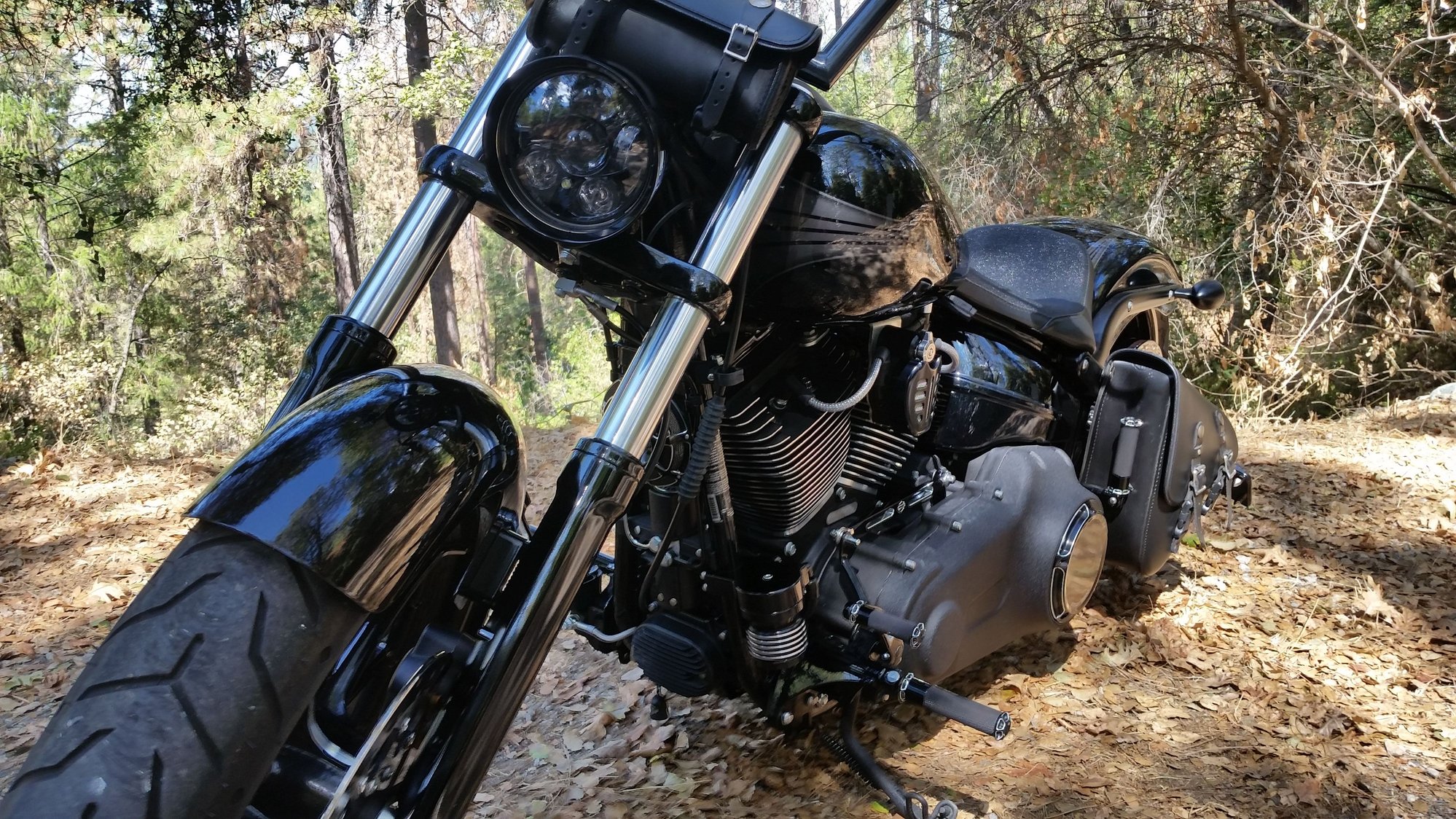

Originally Posted by S.D.M.F
I wish i'd done mine sooner. One of my favourite mods.
I’d like to get a peek at the paint job on your bike. The photo above is a teaser!

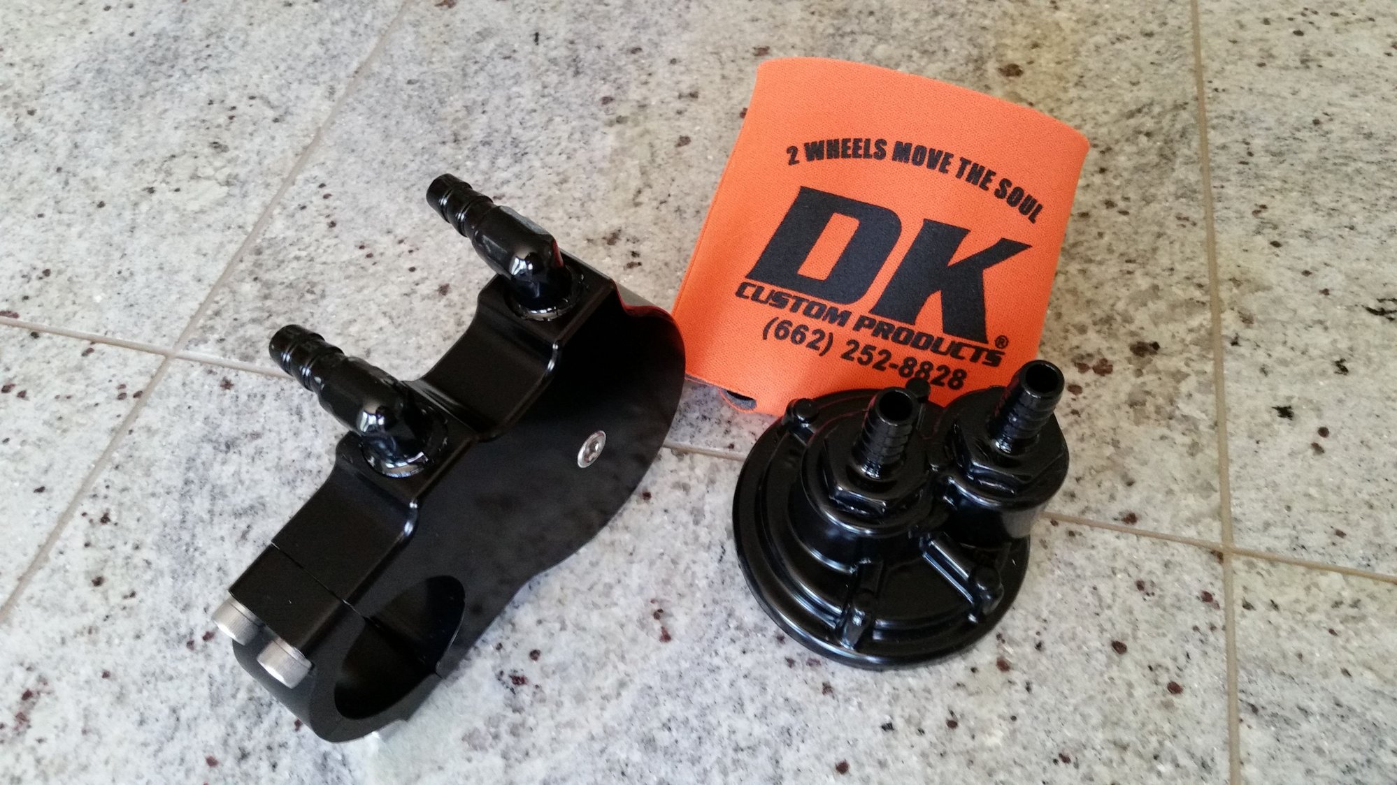

I installed a DK Custom Products oil filter relocation kit on my Breakout a few months ago, and I'm very happy with it!! I didn't like the look of the brass fittings (on this bike), so I coated them with a black, high temp ceramic/enamel.

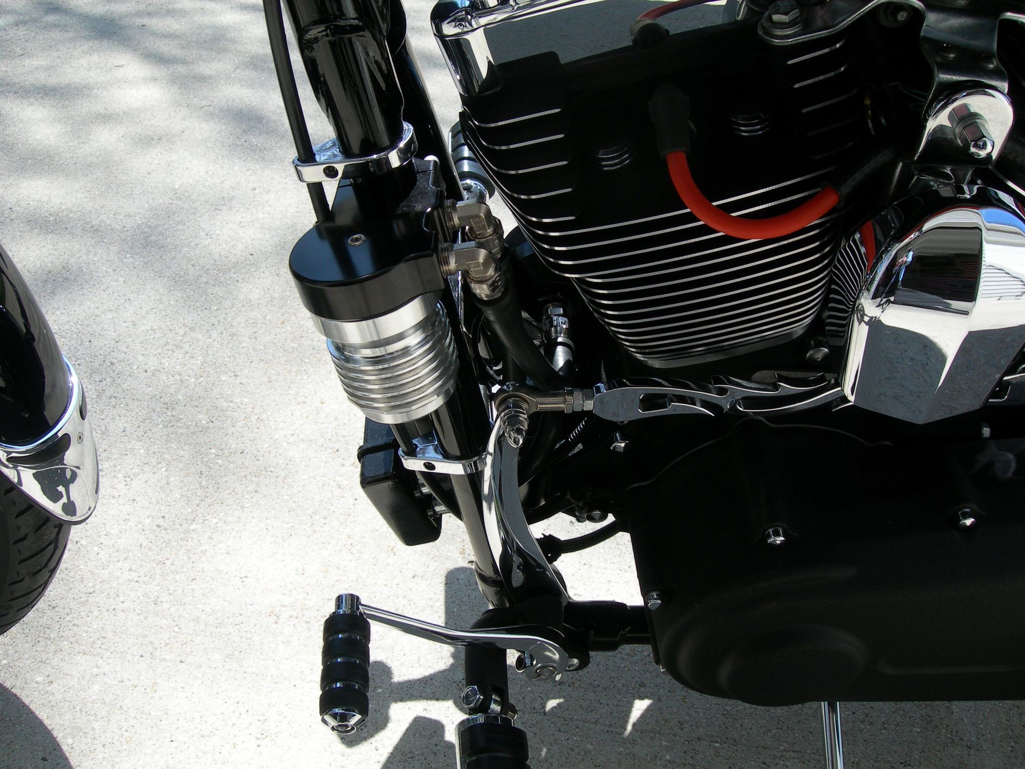

Originally Posted by HKMark23
I thought that sucker was chromed ! What you using for polish bro, I'd like to try some of that on my PurePower filter.
It is Chromed......
