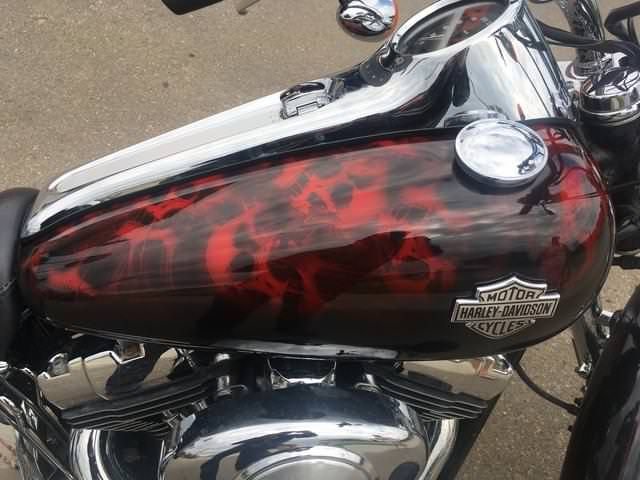

Well as i mentioned earlier in the thread the bike went to the dealership to get a fuel leak sorted out. Said leak turned out to be from a rusted out tank which had developed pin holes in the fuel gauge side. They attempted to repair it but were unsuccessful. So the result is that they fitted a custom painted tank they had on hand.
This is the end result...

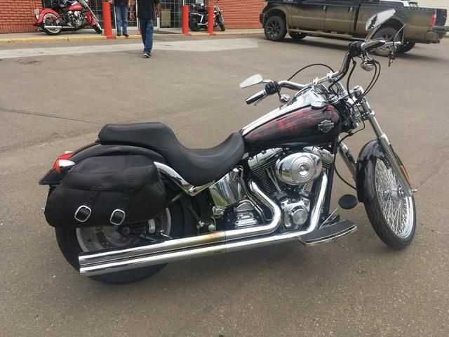

Attached Thumbnails Build thread: 2001 FXSTD Deuce aka "Dark Mistress"-dsc01973.jpg   Build thread: 2001 FXSTD Deuce aka "Dark Mistress"-pict0099.jpg

Great looking bike man, So that puts me at option #3 to give me the best selection of tires. Cool, Most likely will end up with another Dunlop on the front then move up to a 180 once the rear is worn out completely. Which gives me plenty of time to order a spacer kit from Vulcan.

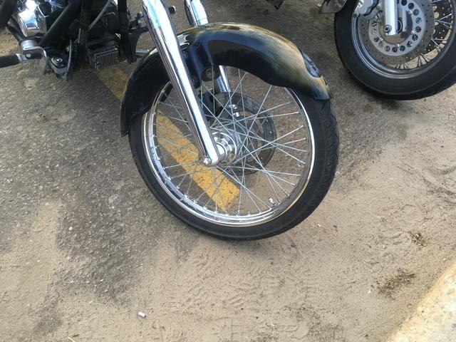

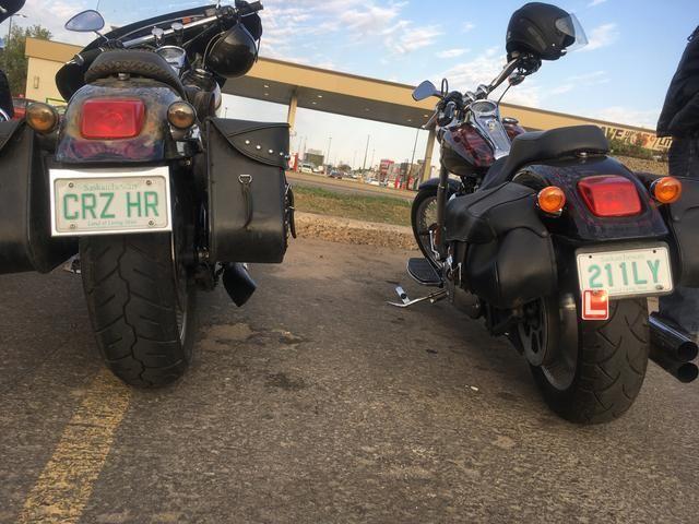

So i encountered another Deuce owner a few days ago. He has the 180 rear tire that i mentioned which is a Michelin. HD website also lists a Dunlop that was used on the SE as well. But now that i know for sure the Michelin will work without mods at all i will be probably saving up for one to put in the parts stash for when the 160 wears out. He also had a fiberglass fender he made himself on his bike and will be making a blank untrimmed version for me to final finish to suit my bike. I kinda like the idea of having the tire a bit more covered to deflect water and road crap away from me and the rest of the bike.
Deuce on left has 180 Michelin on it
Fiberglass fender
More then likely i will probably add a fork brace to replace the lost metal bracing in the switch from one fender to the other.
