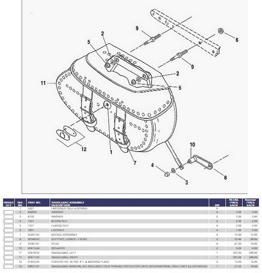

The lower saddlebag support assembly on my '01 FLSTCI came off while riding. Not the nut or the spacer but the peg that accommodates the cotter pin. Is there a replacement part or will I need to purchase the entire assembly?

Here is a schematic of the saddlebags for a '01 Heritage. Locate the part and refer to the part list for the number. Hope this helps.
