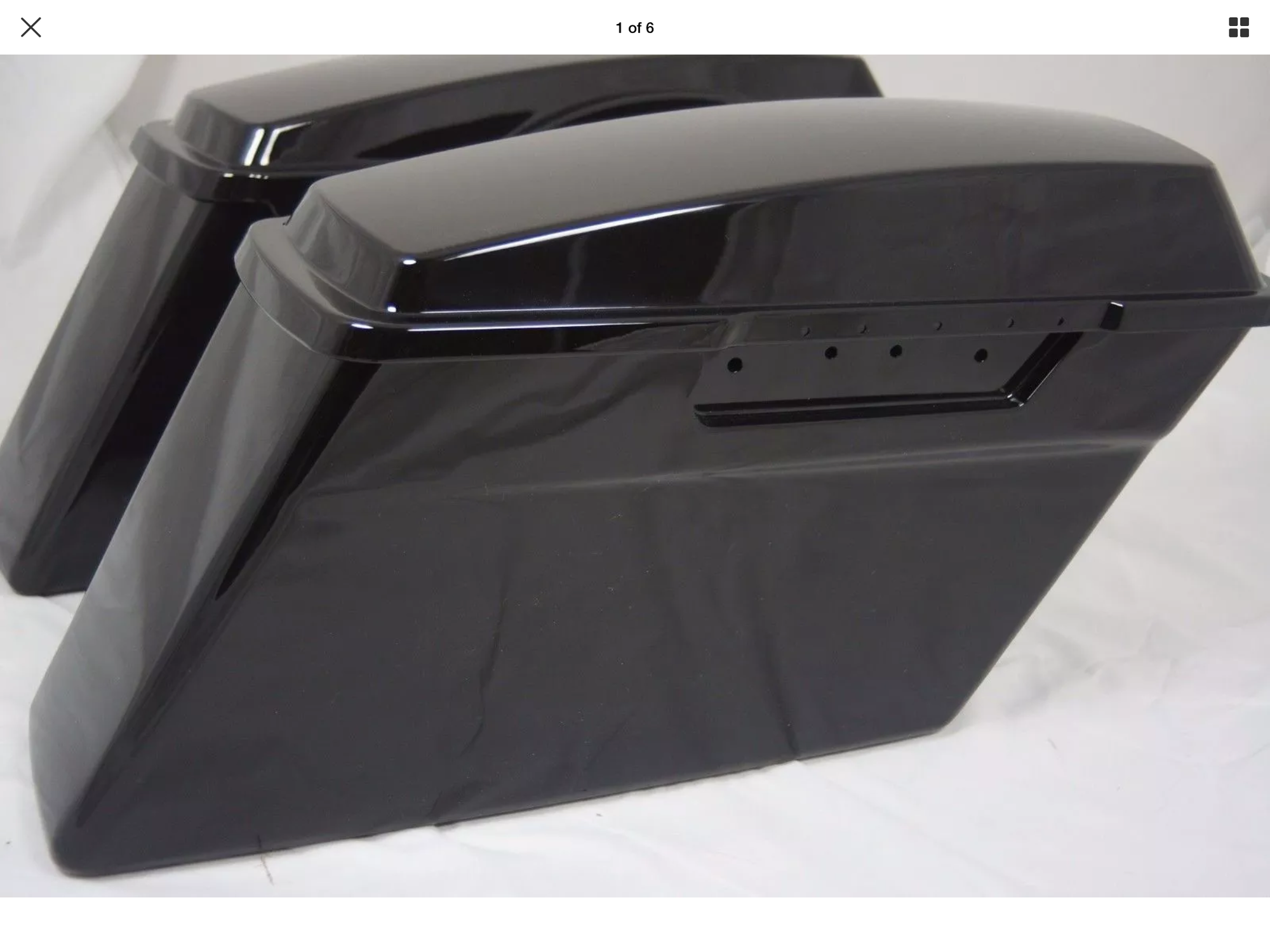

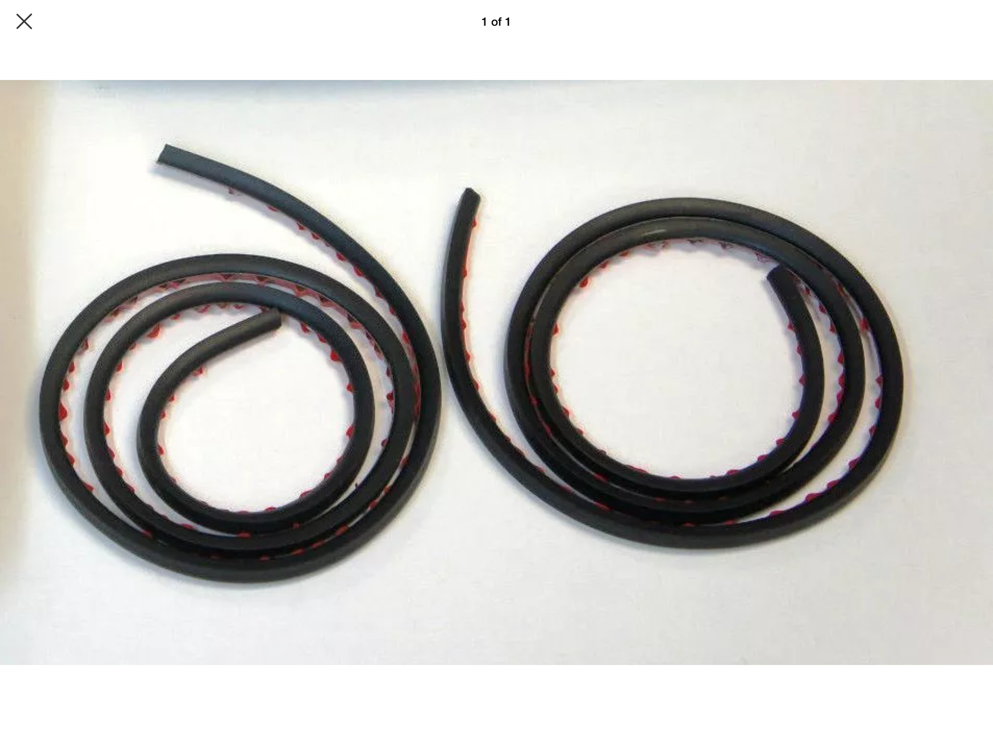

The parts were ordered, (all eBay aftermarket) just waiting for the bags to arrive- should be here this week. Hoping I won't have to do to much modification since it's all repop stuff.
The bags and latch kit are from Matazu (I've had good luck with their products) and the mounts are from egobike (new one to me)
I will post updates on this thread, as I get things started
Here are some pics of what I bought.

The Big brown truck brought the bags yesterday.
 It took about an hour and a half to assemble the latches, and get them onto the bags. The one thing is the right bag was in the box upside down, and was not wrapped, to the clear on the lid has some mild surface scratches on it. - I'm not to concerned with that since I will be painting them this winter. - for the time being, I will just see what I can do with a light compound.
I was expecting the hardware kit to have the rubber grommets that the pins go into, but it didn't. so I need to wait for the ones last night to come in. - Hoping I have something around the garage to temporarily use so I can get them mounted up now.
