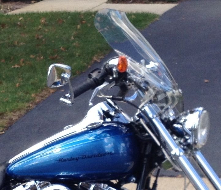

Shields have issues which have to be dealt with in most cases.
The angle of rake is critical to make the bike stable at speed. If the shield comes mounted too upright it will act like a brick wall and shake the entire bike and wiggle in crosswinds etc.
If it is tilted too far back it won't be tall enough to cover up what you bought it for---mainly to give your helmet a break from "bobble head' on the highway.
If it fits too tight around your front headlamp it may creat a big vacuum pocket behind it where you get sucked into the air space behind the shield which is all messed up air and causes buffeting big time.
This requires you "break" the vacuum seal created by the shield moving through the air. perhaps raising the shield enough to leave a "slot" at the bottom to let air go around to the rear of the shield and neutralize the air pocket.
New Harley shields may have some form of 'mail slot" to bleed a little air into the vacuum and remove the buffeting.
I finally decided it would be simpler to simply build my own shield out of a good plastic with a built in reverse lip (National Cycle F15 Touring)and go make brackets from aluminum bar stock at Home Depot.
I made some practice hardware to adjust the thing until I found the magic spot and then cut the bar stock to fit it perfect.
Looks clean.
Works amazing.
Great protection.
Zero buffeting at any speed and I can finally cruise at 90mph which is not unusual up in the Adirondacks on the super slab.
Here's a photo of it.
Took me four years to finally get a perfect set up but it works for me.

rleedeuce - I did more research after you mentioned the vacuum pocket. I see what you mean. Lots of "well designed" windshields account for this "dead air" behind the screen. It makes sense since no matter how low I tucked under the screen the buffeting was still present.

Yea there's a low pressure area behind the screen that air is rushing back in creating buffeting ,i know that's simplistic but it's an easy way to say it.
Rlee well done I've thought about making a lexan screen many a time ,would of wasted my time without your post here.
