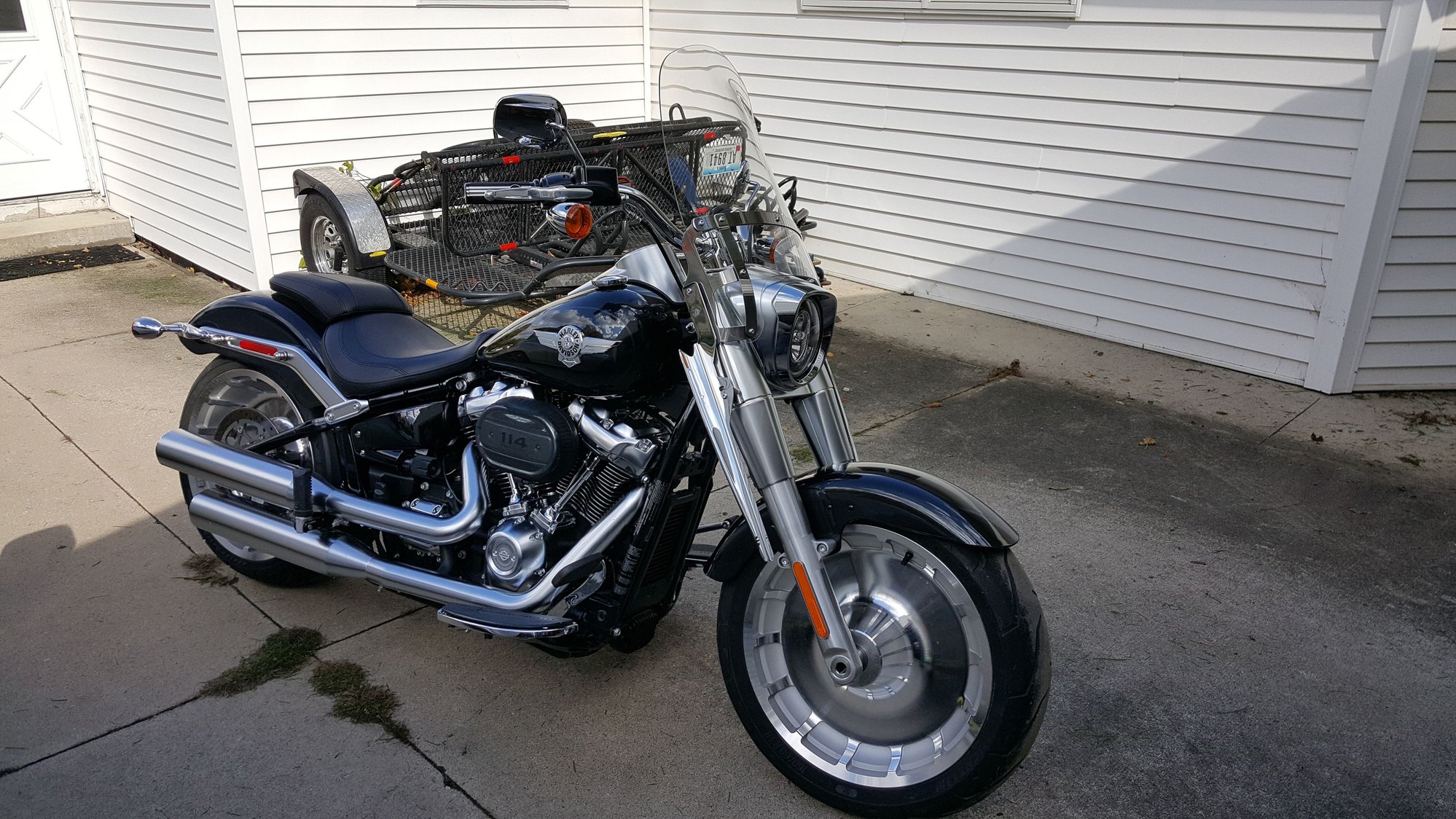

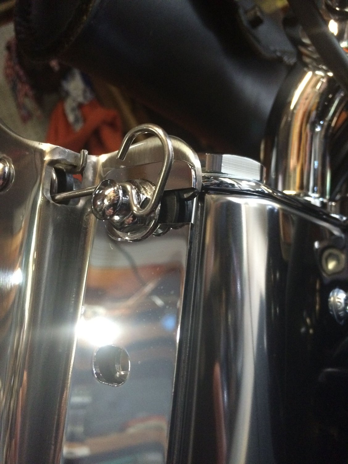

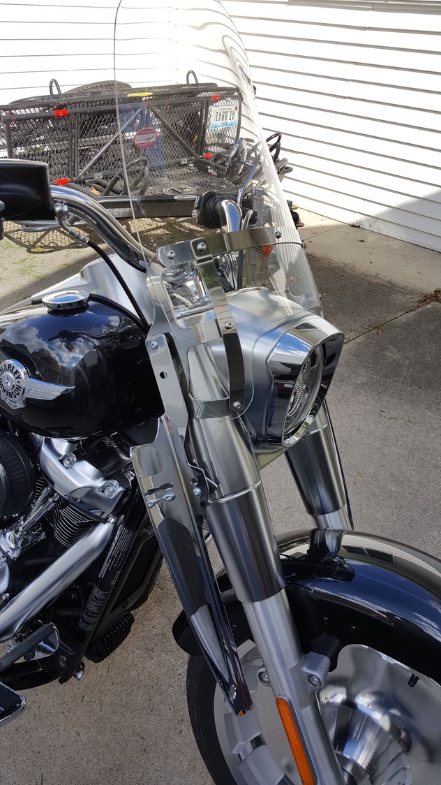

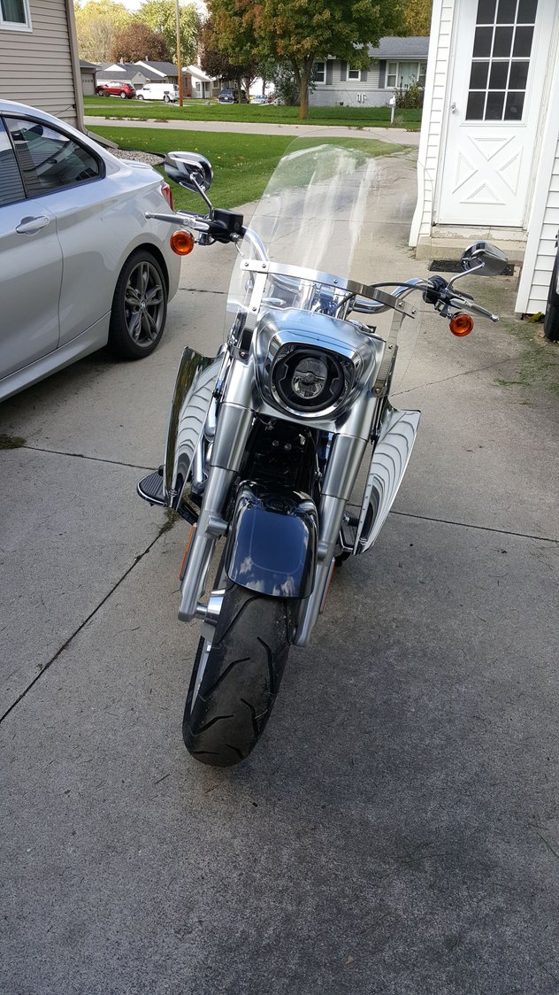

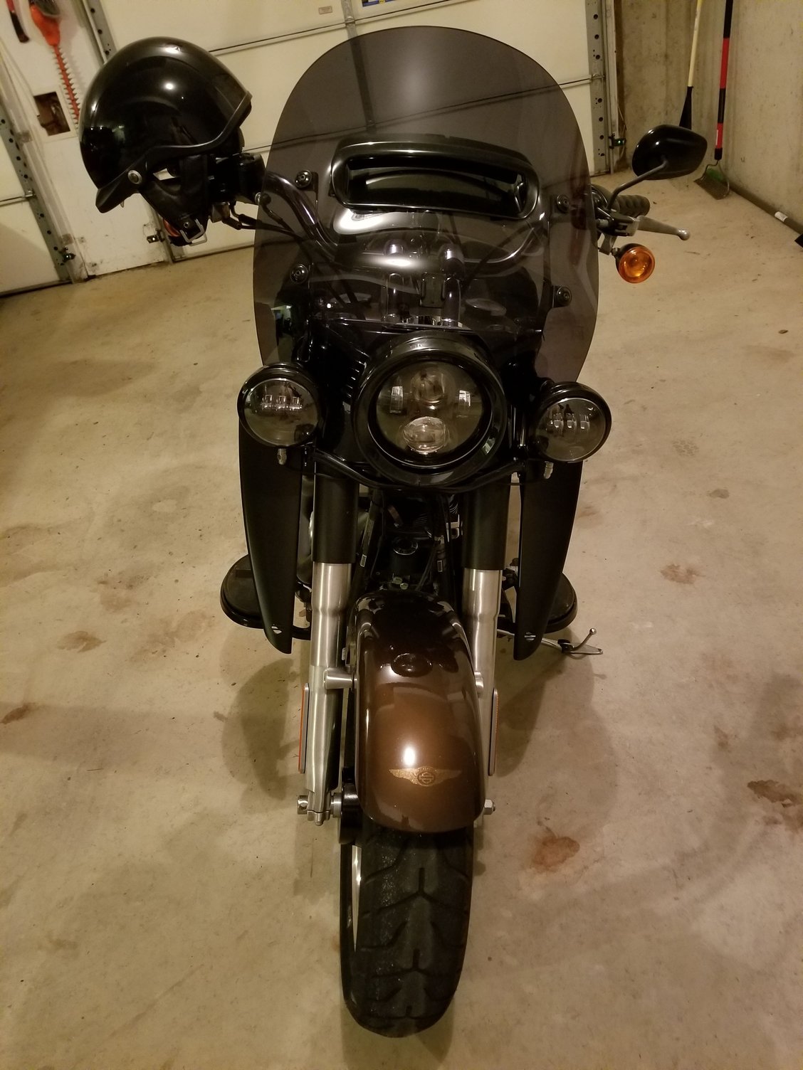

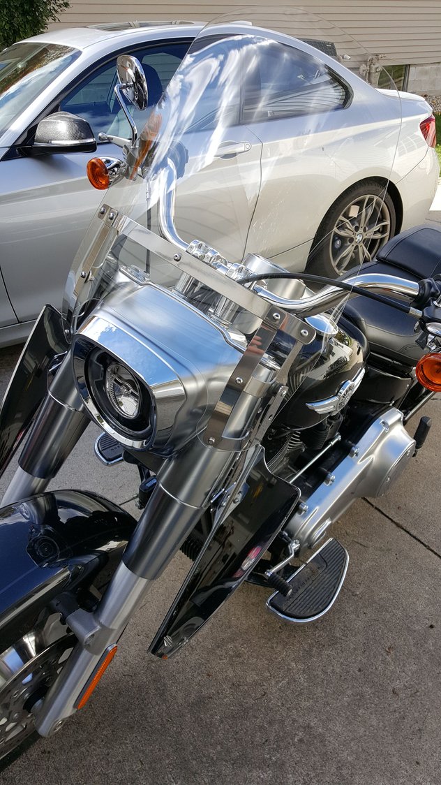

Here are a few pics of my 18 fatboy with the fangs. I think the chrome is the right choice for the front end of this bike as everything else is silver but the tire and fender.

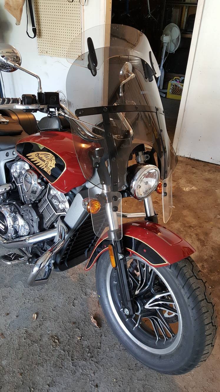

I'm also uploading one of my wife's scout. We custom made a bracket and used Memphis Shades lowers plastic to mount them on there. Again, the lowers significantly reduced the buffeting. Above the lowers is a Memphis Shades drop down shield. The louver on top is like a Laminar Lip in that it creates a venturi effect sending the air high.

Thanks for the photos!
Yeah Chrome is a good choice for you FB. Fits the color scheme nicely. It is interesting to see the size of them.
And the angle you took one of the pictures at clearly shows the gap between the fangs and the windshield disrupting the Vortex.

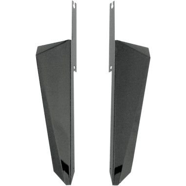

FLSSBart...Found these black ones....while not HD, similar in design to the chrome HD ones I have
http://www.boardtrackerharleyonline....ck-Wind-Guards

One more thing about those fang deflectors. They are often put on backwards, not really what you would expect them to be. The concave part is facing forward, if that makes sense.

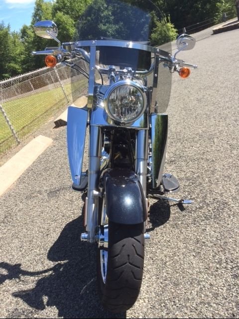

Lower air deflectors are definitely the answer. I can now wear my regular prescription glasses and a baseball cap with the brim forward with no problem what so ever !!!
I even slotted the mounting holes so I don't have to remove any of the windshield docking hardware to remove them if I wanted to.
