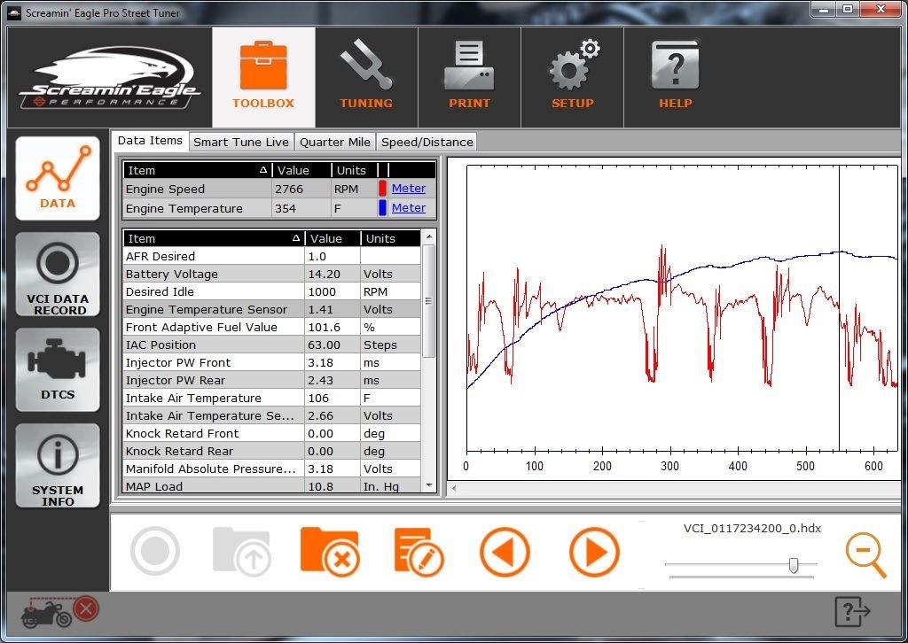

The lowers on the crash bar will indeed raise engine temperatures. See this link for data i collected. This was on my 2016 Sportster.
Sportster SE 1200 without soft lowers
Sportster SE 1200 with soft lowers
Old Oct 18, 2017 | 11:06 AM
  #47
bad tappets's Avatar
bad tappets
Joined: Aug 2015
Posts: 1,712
Likes: 410
From: Puyallup, WA
Very interesting. I've heard rumors of this, but it's great to see some proof. Thanks for posting.
