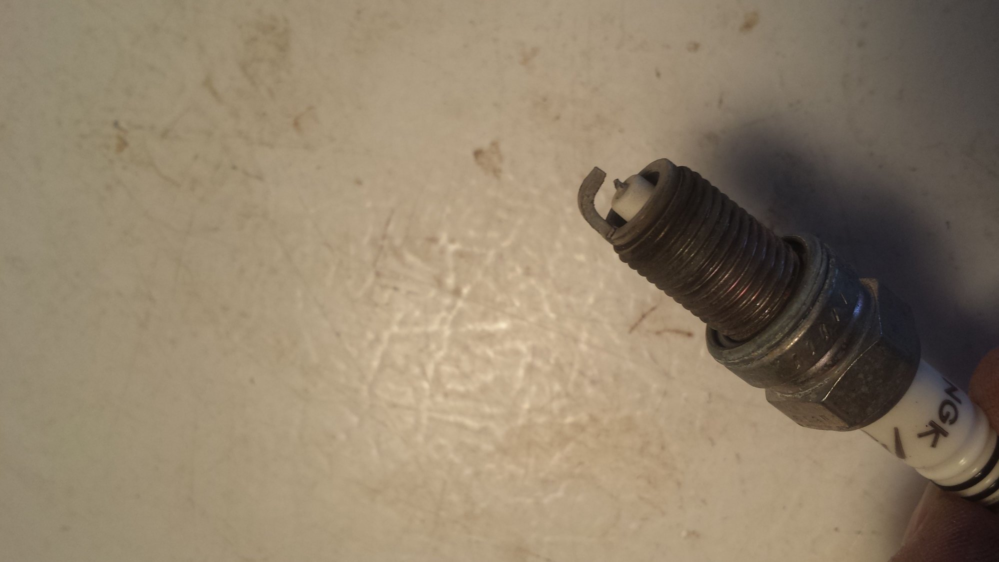

Just thought I would pull the plugs for kicks and giggles. What do you think? Looks like the tip is bent on it? This is the rear cylinder. front looks similar , not as bad All picts are of the rear, just different angles.

If I'm seeing what I think I'm seeing, that electrode is burned all to hell. They're done. It also appears the bike is running lean. How's the bike start since you replaced the plugs?

​​​​​​​yeah...that's what I thought. The electrode looks bent. I think there's 5k on them. I just pulled them tonight. Have not replaced them yet. I'm am curious to see if that could have been the cause. Any clue what could cause that electrode to warp like that in 5k mikes?

Running very lean or too hot of an ignition..

I'm running bassini true duels and KN filter on the stock ECM. (that's how I bought the bike) should the ECM have been upgraded when the pipes and filter were installed?
Can I manually richen it up anyway?
I'm going to put new plugs and wire in tomorrow. I'll post up wit the results

UPDATE: Changed out the plugs. Did not make any difference.
Time to take it over to HD for a fuel pressure test.
