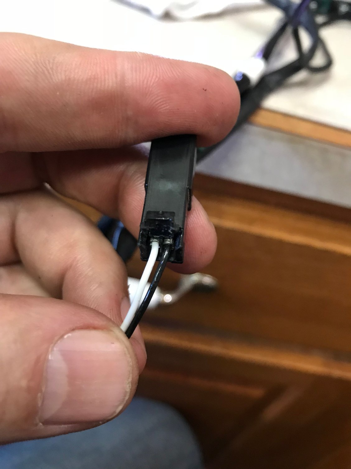

During a handle bar swap I slid the tank back And found a loose connection the black and white connector and I need to find out if I need to find its mate or if it’s not used on my model. My bike is a 2016 Slim with cruise control The black and white wire are part of the throttle wiring harness thanks David

Heated grip wires for throttle side used if they are installed. They connect to end cap on inside electronic sensor.

Great thanks. I pulled the connection off while pulling it through the bars and was hoping it didn’t need to be fixed. I’ll cap it off and fix later if i ever do heated grips.
