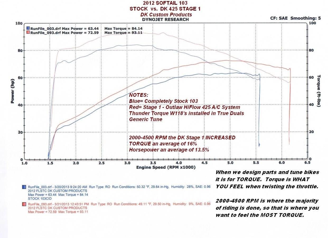

Take a look at these Dyno Charts:
Best possible exhaust mod when comparing results per dollar spent(29.95).
